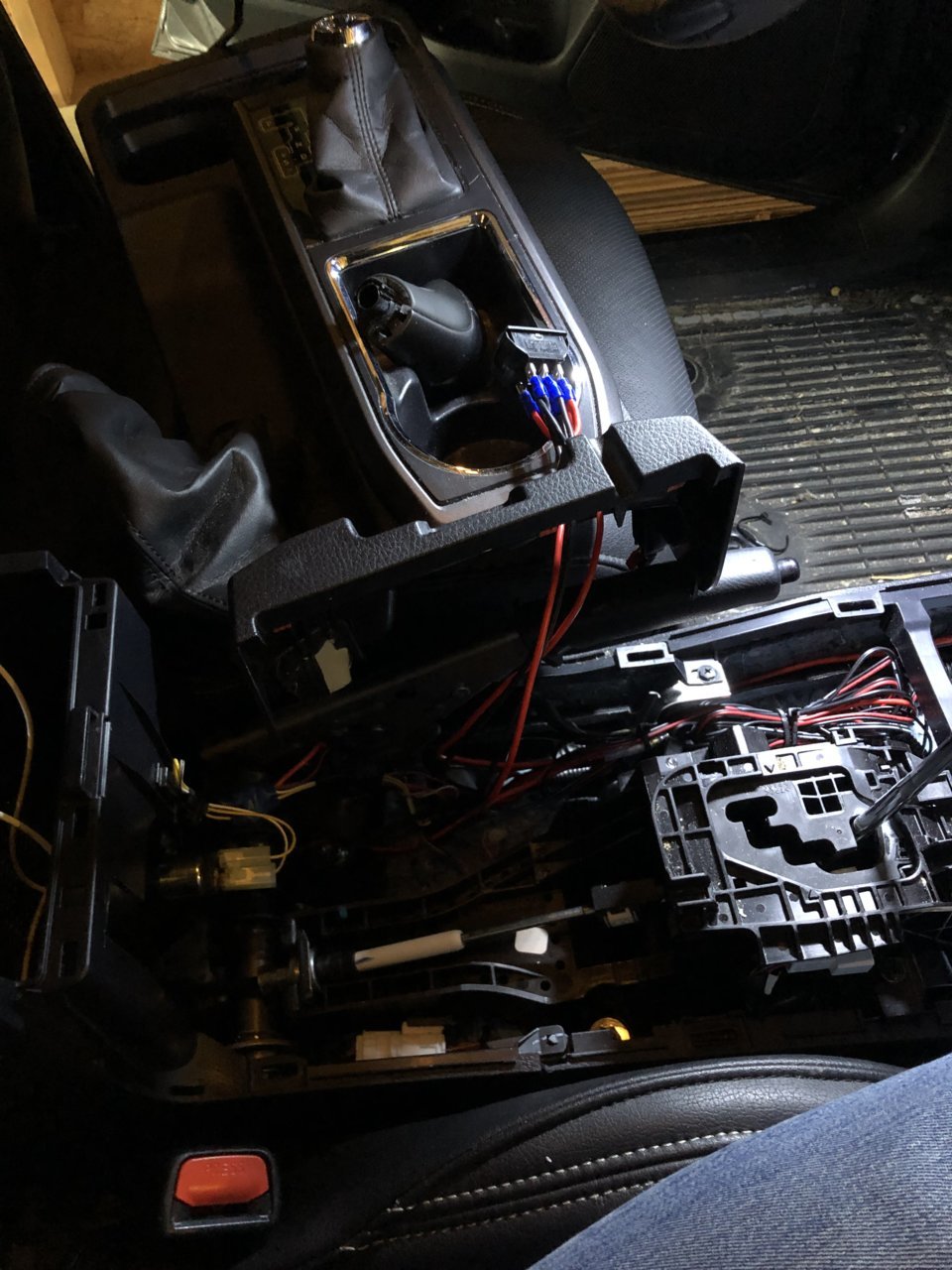

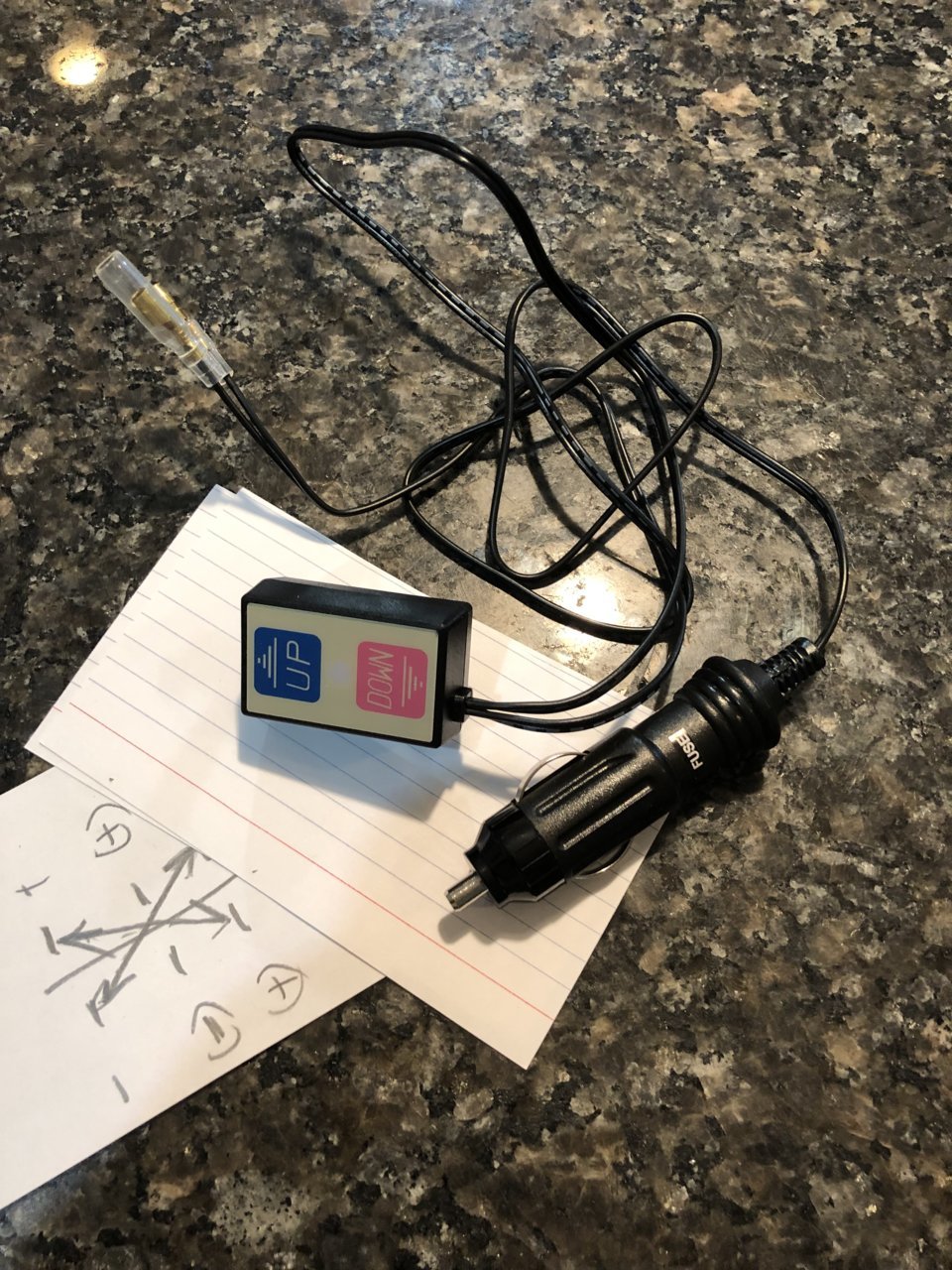

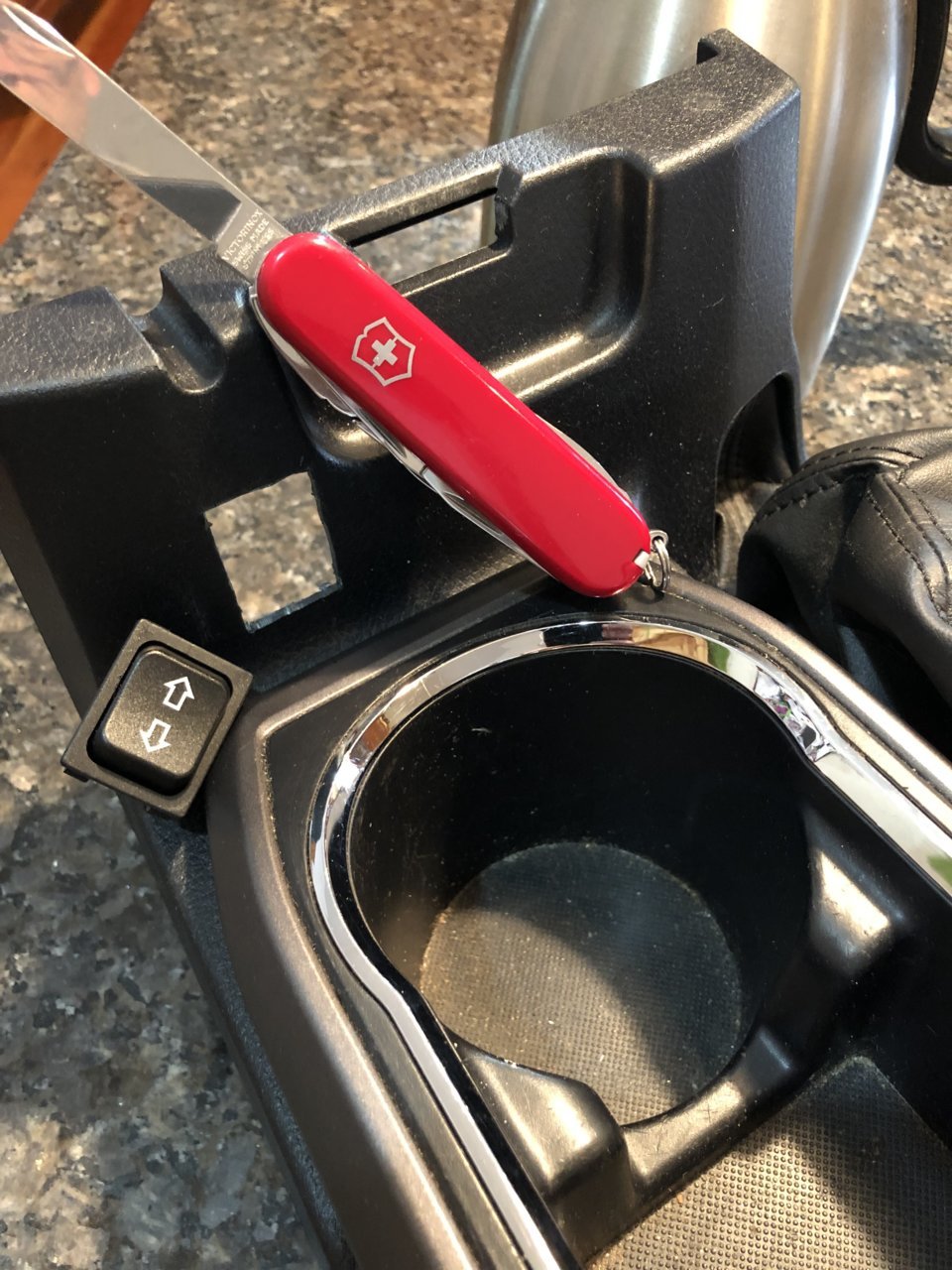

    Did the wiring properly for my Antenna Power Tilt.
    Problem:
    Yesterday I installed the Power Antenna tilt motor and mounts and it really is great (see my hog of posts above). While the motor and mounts are a good balance of durable and affordable, the provided switch which reverses polarity for up/down, is really questionable and of course power plugs for installed accessories is not my full definition of "installed":
    Solution:
    Make a reversing switch with a power window switch (DPDT with cross jumpers): Yes I did a "professional" wiring diagram as well to show my kids how it works!:
    Using the latest lithium powered - lazar guided - GPS enabled - self powering adaptable tools, create the proper opening in some place on your truck that "you" like. I chose console for right handed person:
    Stick it in the hole before you make all your connections:
    Enjoy your earth-shattering mod in ways hard to describe even to us Taco-nuts:IMG_7065.jpg
