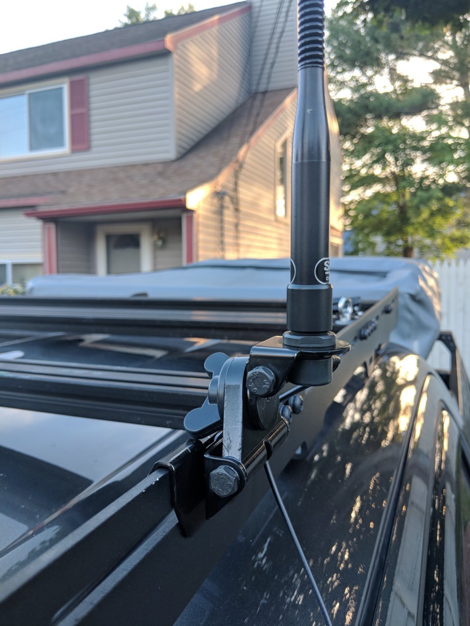

    What kind of antenna and mount is this?

    Well! Won’t get many opinions on an antenna question! The rf mass center of the truck cab and the height of the rack all work in your favor. I chose rack mount forward of center passenger side. Works great. 27 mile hit to repeater consistency and 53 mile simplex test.

    Did your brackets actually line up straight with the antenna? I have a set and I've been debating about doing my antennas instead because the RTT might hit where I currently have them mounted behind the cab.

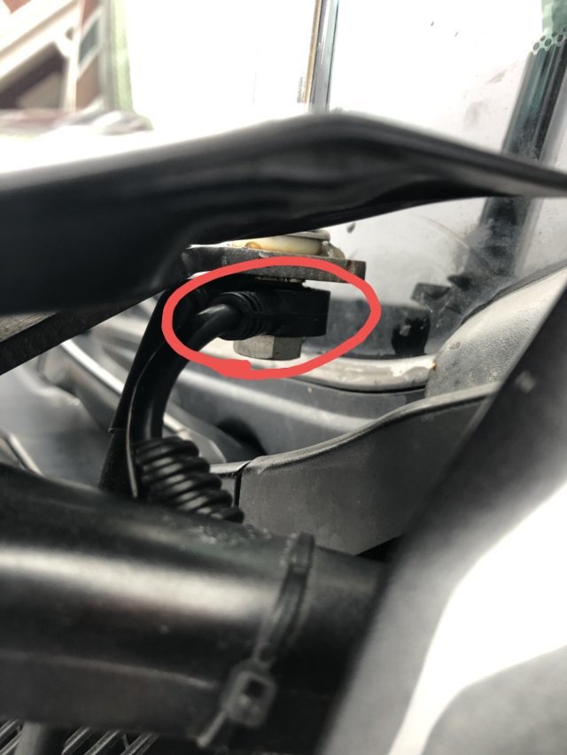

    No luck. Went out to move the ground to where @Bastek indicated, but still had continuity between the mount and the shield on the wire. Came to realize that the terminal ring on the ground wire was contacting the stud. So I decided to scrape the paint off the bracket, and ground to that and then connected my ground strap to the fender. No more continuity between the mount and the wire. Thought it was problem solved! Off to a large field to tune my SWR.
    I still had high readings on my SWR meter, so I unscrewed the tunable tip from the Firestik, and my SWR went all the way down to 1 on channel 1 and 1.5 on channel 40. I sure was thrilled and thought I was totally done. However, I couldn't get anybody on the radio for a radio check even though I did yesterday. So I wasn't totally convinced it was time to call it a successful job.
    Next I looked closely at the wire, and noticed the break you can see in the pictures below. The bracket doesn't put the wire high enough, so the hood put pressure on the wire and caused it to fail. I did some research online and found that there should be continuity between the studs on both ends of the wire (there was) and also continuity between both shields on either end (there was not). So now I know my wire was broken. I had another wire that I also ordered that won't work because its mount is way too long, but I did check that one and there was indeed continuity between both shields. So I ordered a Firestik Firering and corresponding mount that will arrive this week and I'll try again. I do think my grounding issues played a part, but the broken wire really prevented further progress. I will update again once the new parts come in! Thanks to all for the help along the way. I sure am learning a lot as this is all new to me.

    Sorry it didn't work out for you... One of the reasons I was leaning more towards grounding an actual bracket instead of antenna connection.
    Fire-Ring seems like an good option in your predicament. Now with that Please ground your bracket and do NOT stick anything between the ring and bracket, so you don't end up with anything like this
    Not my photo, posting for educational purposes only.
    Good luck, hope it works out ok.

    What is that I'm looking at? Is it a ring terminal wire for a ground? I won't be doing that again!...

    Yes. Kinda hard to tell because of potato quality, but that's it

    Nope I got it. Thank you. I learned why the ground strap to the mount is not ideal. I didn't want to scrape paint off the bracket to leave it protected, but I guess I've gotta do what I've gotta do.

    Rack it is then! That's decent enough range for me I think.
