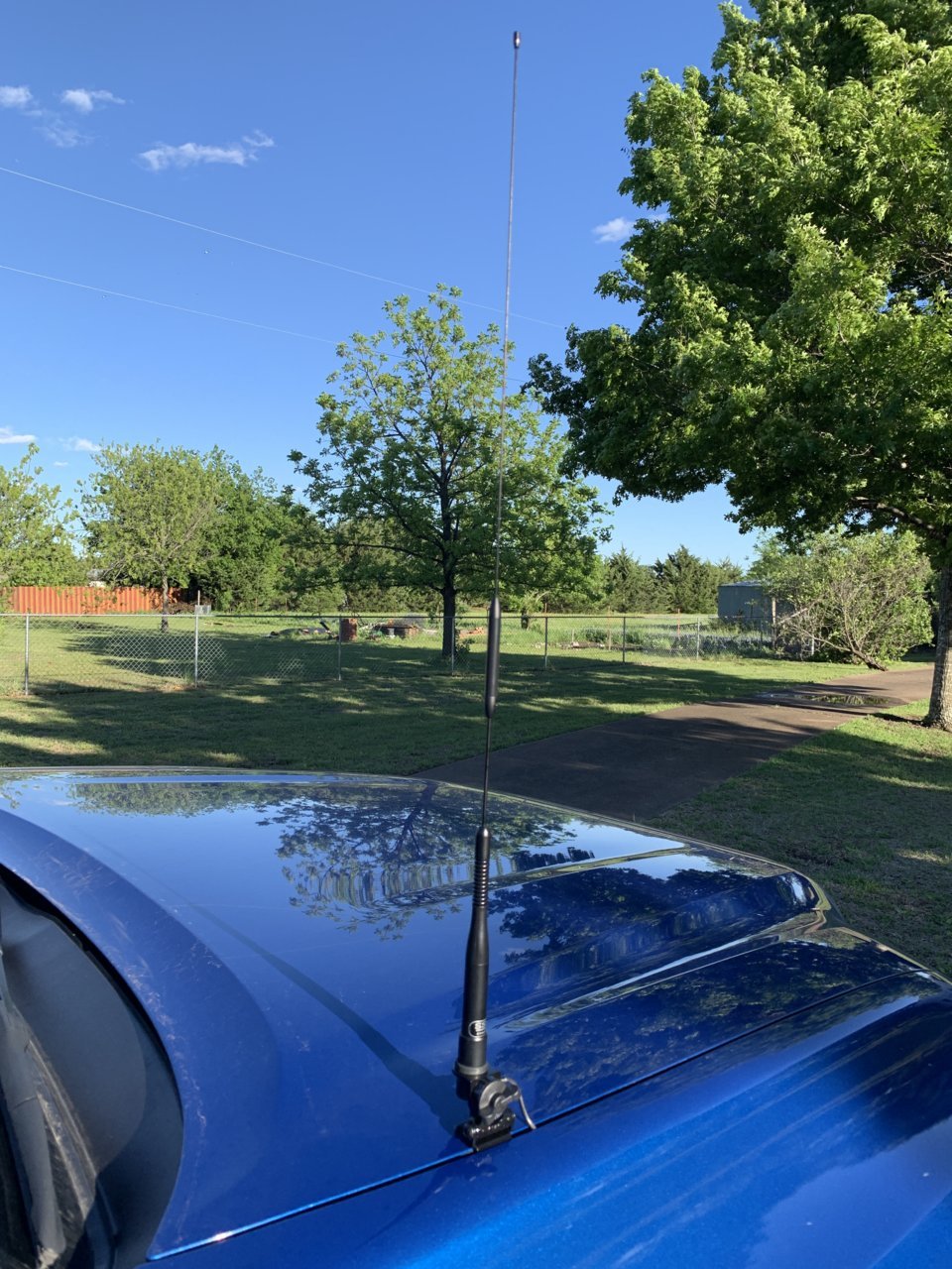

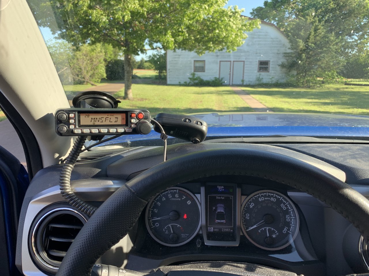

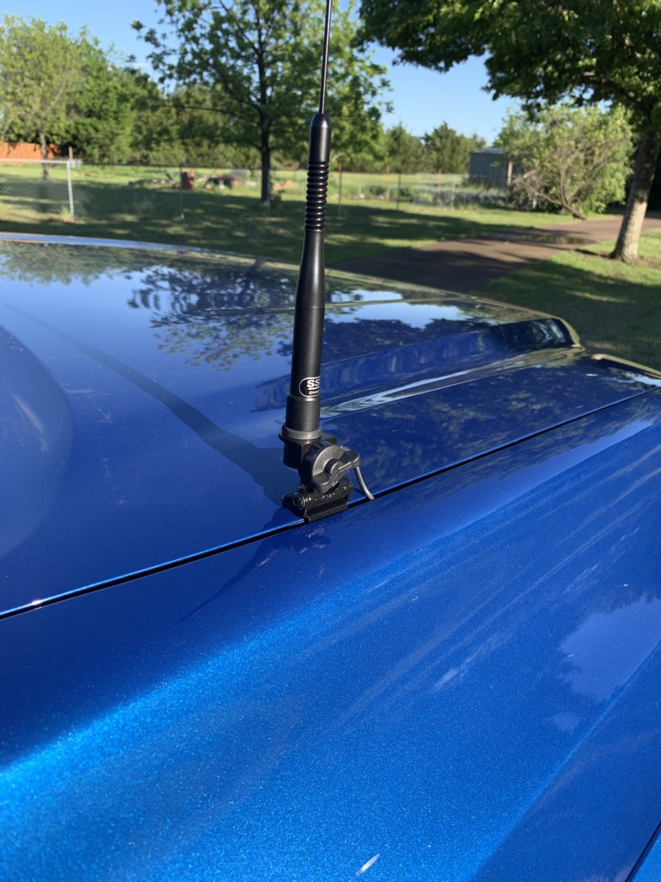

    Finally got around to moving my dual band radio from the jeep to the Taco.
    RAM suction cup mount for the control face, the set is under the driver’s seat along with the external speaker.
    Routed power out through the boot in the firewall and the separation wire runs down the A pillar trim and along the wiring harness to where it goes under the seat. Antenna coax runs out from the floor grommet across the engine bay to the Comet mount and antenna.
    27” whip, lots of spring, tops out a little higher than the cab.
    Nice mount, fits the hood lip and should still allow for clearing the eventual ditch lights. Adjustable in two axes.

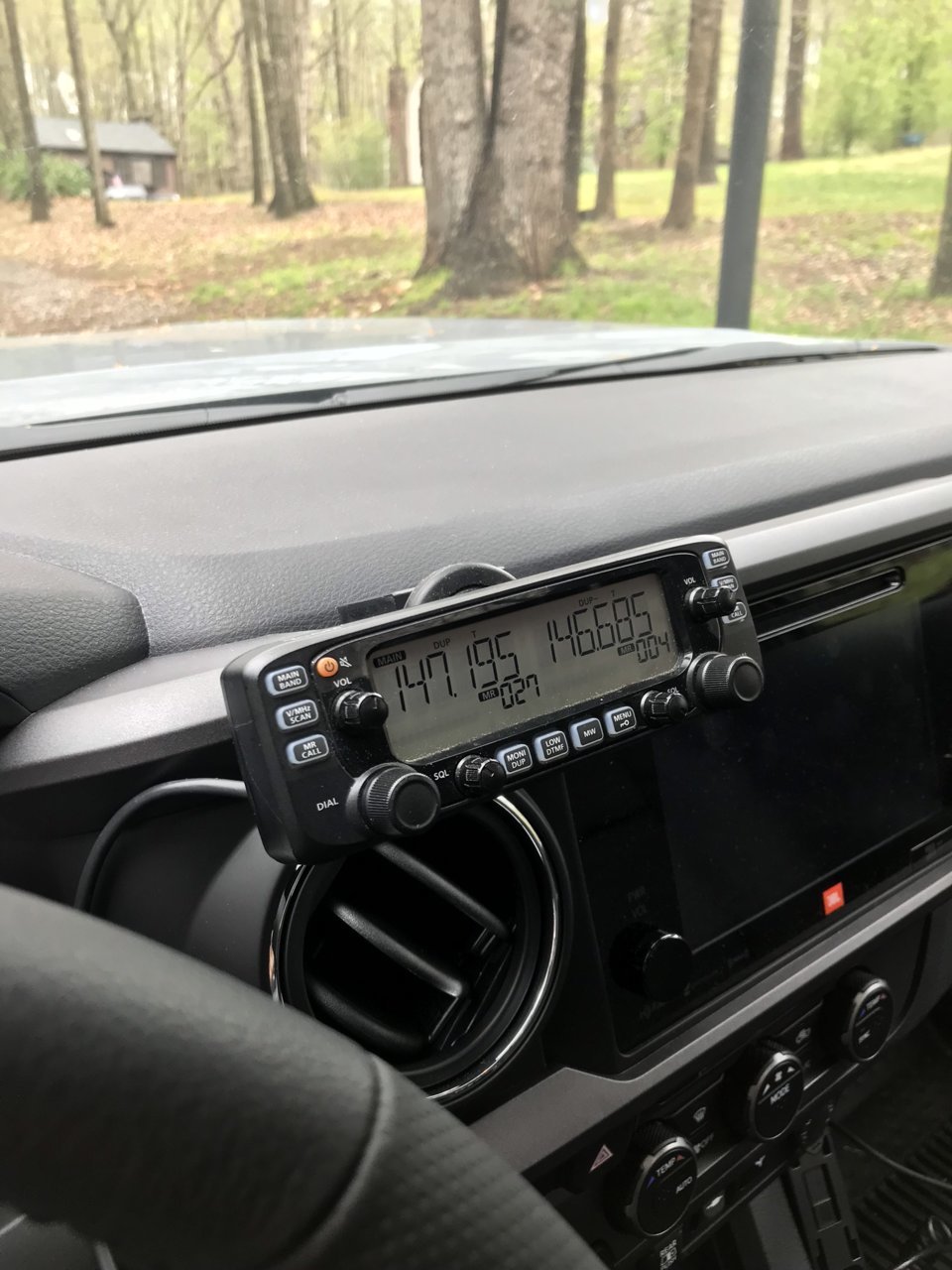

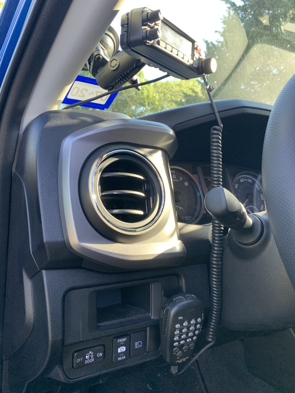

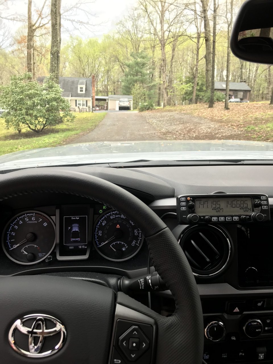

    Got mine mostly done as well. Still may move body to under seat.

    I love that Icom. Such a great radio.

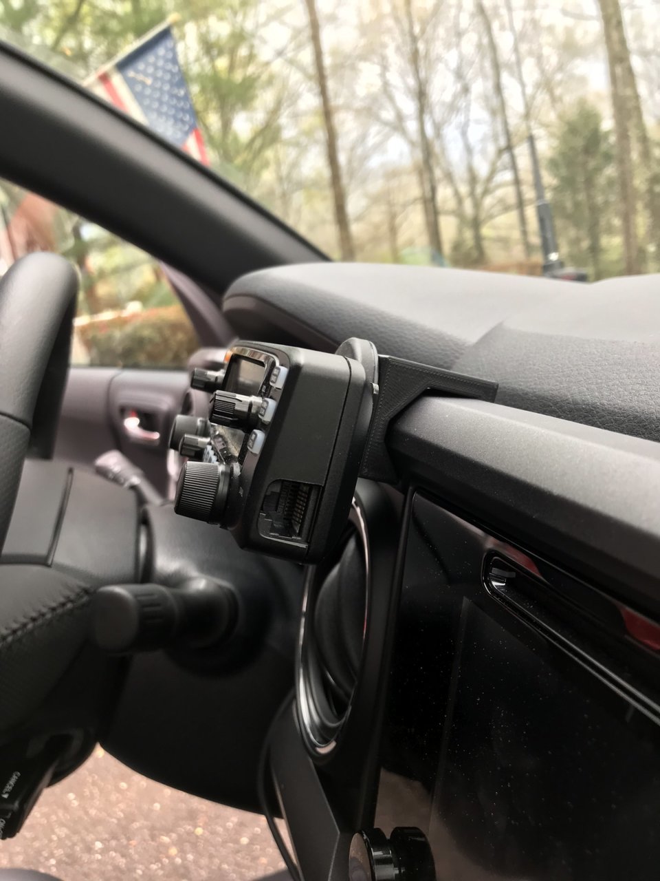

    Nice. Where did you get that dashmount??

    im curious about that front/rear camera button in one -- link?

    looks 3d Printed to me.

    Yes it is. Great display, dual vfo's, and cross-banding. I picked it up used with the mounting plate for $200 a few years back.

    It's the one that @BEAR_KNIFE_FIGHT linked
