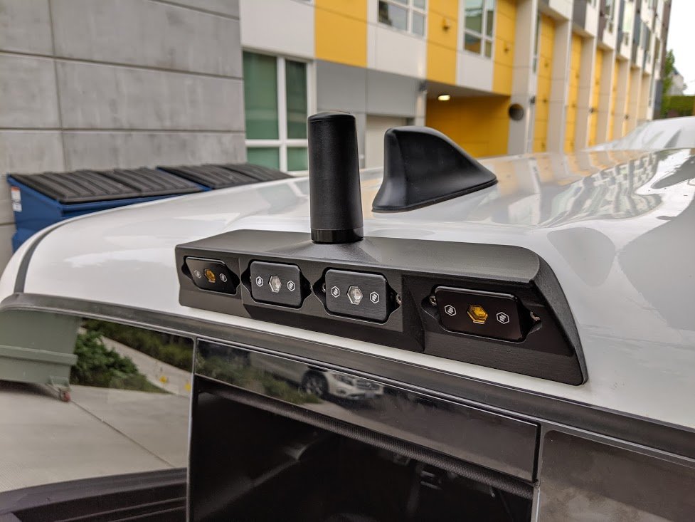

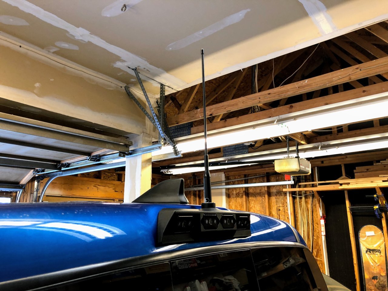

    Thanks for sharing! Could you also share info on that beefy NMO mount?

    It's just a standard NMO mount, I think it's a Larson. I did add a large sheet metal "washer" below the NMO in an attempt to make it a little stronger, I made it using a 4" hole saw. I have no idea if it does anything.

    Where did you get that mount around (or replacement 3rd brake light?) And that antenna?

    For beefy NMO mounts, check out Breedlove machine shop. I was running #503 on my previous vehicle, but installed the #505 on my Tacoma, only because I am running a cr8900 antenna. For a typical (< 20") dual band antenna, stick with the #503.

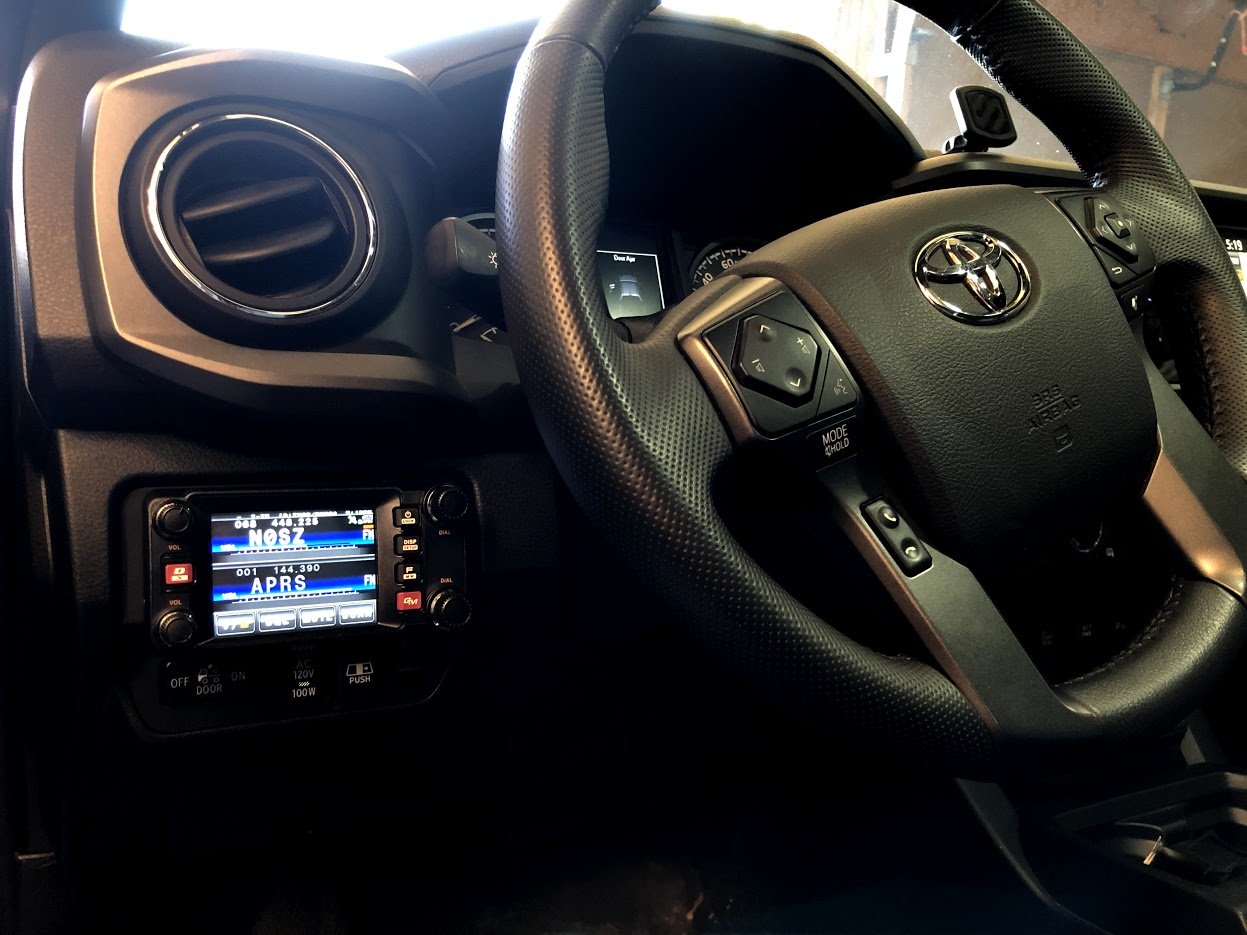

    FTM-400XDR installed with Comet SBB-1 on a MESO brake light.

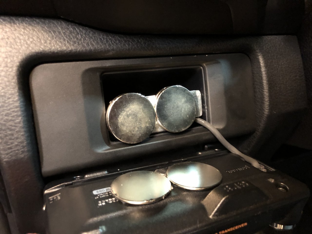

    Got any more pictures of how the unit is mounted?

    MAGIC.
    ...I mean magnets.

    Ha! thats great, I never would of even though about using magnets to hold something like that on.

    It lets me quickly remove it and put it in the glovebox if I want. They are strong niodymium magnets so it doesn't move while mounted and it would have otherwise been difficult to get it this flush.

    That looks like a 1/4 wave on a plastic mount. Did you ground the NMO to the chassis? Did you check the SWR?

    Any issues seeing while driving?

    It's grounded. It has been performing better than I expected, I have an SWR meter on the way. One thing I didn't think about before installing is the RFI from those LEDs in the brake/cargo light. I'm going to have to try some ferrite chokes.

    It's not the optimal position if you're constantly needing to see the screen while driving but I can see it with a slight tilt of the head.
