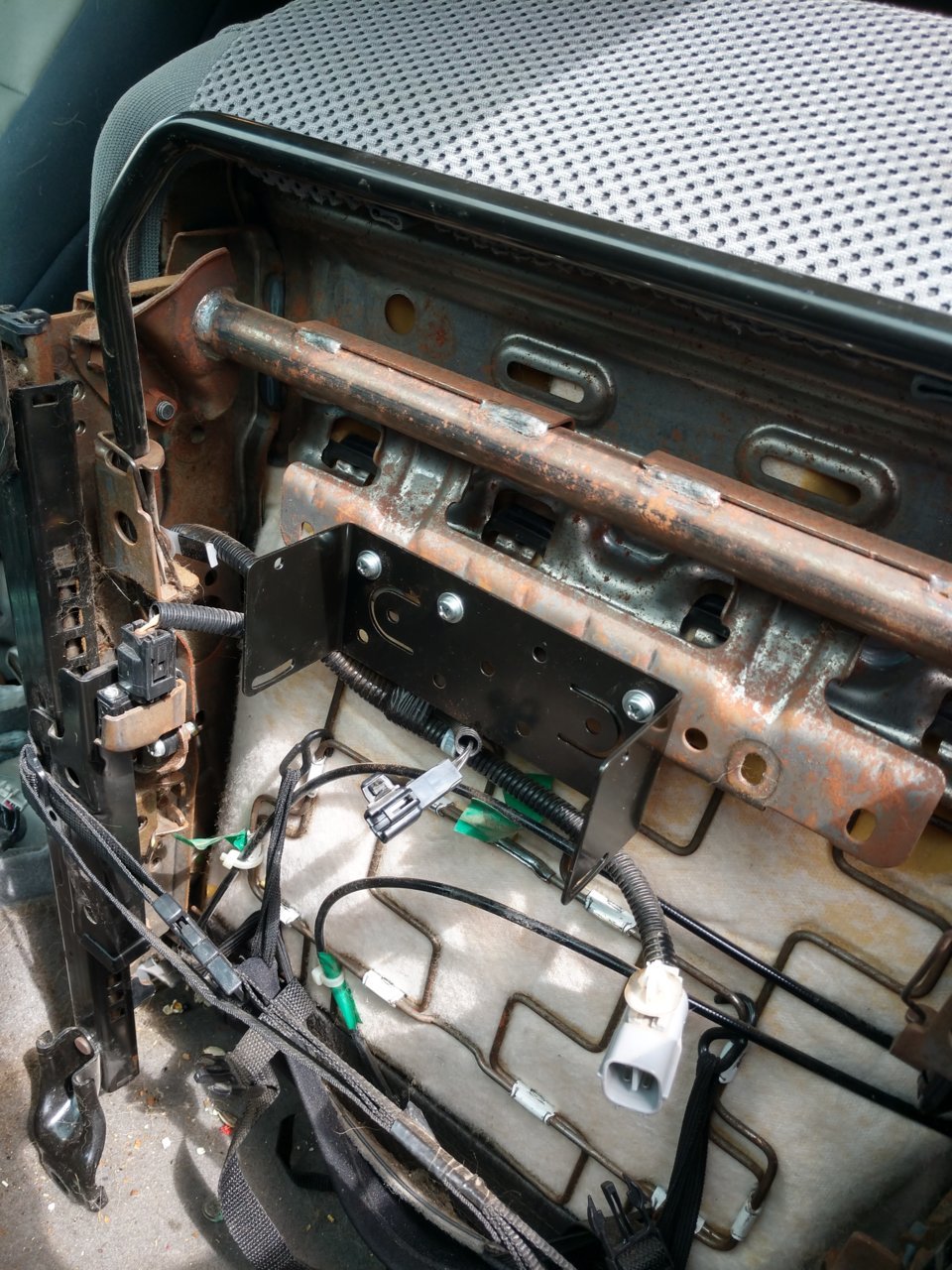

    Finally started my "clean install" of the ftm-400, found that 3 holes under the seat line up with factory hole in the seat frame

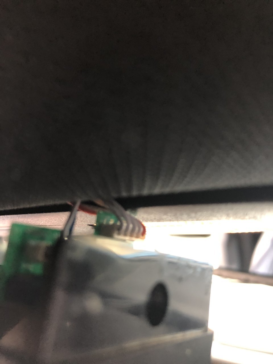

    alright, i need some help from the experts. i dissassembled my uniden scanner the most i could so now i have the faceplate and the motherboard. i took my overhead consol down and stuffed the mother board up in there and put the consol back up and heres what i got. the up close pics are where i have a question. is leaving it like that bad? its a small piece of mother board material for the digital display on the faceplate is resting on the celing. orrrrrr should i do what i didnt want to do and take down my headliner and cut a nice tight clean hole and have the thing mounted nicely? and if u guys think i should do that, and tips/help/advice doing so would help. thanks. also since im mounting up here does anyone know if theres and wires up there with constant power? or do i have to run power all the way down to somewhere?IMG_0626.jpg IMG_0627.jpg IMG_0628.jpg IMG_0629.jpg IMG_0631.jpg

    Tacoman97 I noticed you are from NY. I don't know if you are aware but NYS Traffic Law doesn't allow hardwired scanners inside a vehicle unless you are a LEO, VOLLIE, have a permit, or are a HAM radio operator. Be careful where you locate that thing!

    Assuming the ceiling you are referring to is hard plastic, I personally wouldn't want any part of the motherboard resting on any 'hard' surface.
    Just put a very thin piece of foam between the board and the ceiling to absorb vibration and to keep the motherboard from sliding back and forth on the plastic.
