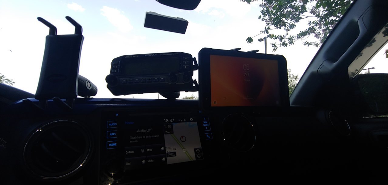

    So its hard to see I know, but got some more mounts installed for the radio and tablet. Now i just need my tnc and rewire my mic port then it will be 100% (and a new nmo connection for my hood mount)

    ProGrille,MesoStuff,Tinted,AllPro sliders, RCI ALL skids, BAMF diff skid, KDmaxPro tune, Demello bumper, Warn evo10s, BD s8 & squadrons, Accutune UCAs, Fox 2.5pes, Eibach & Deaver
    How is that mounting system?
    I think I’d rather mount my radar detector off that instead of the mirror.

    I love the dmm. Been using it for awhile for just the phone or display. Pretty easy to install and phone didnt really move while playing in mud and sand
