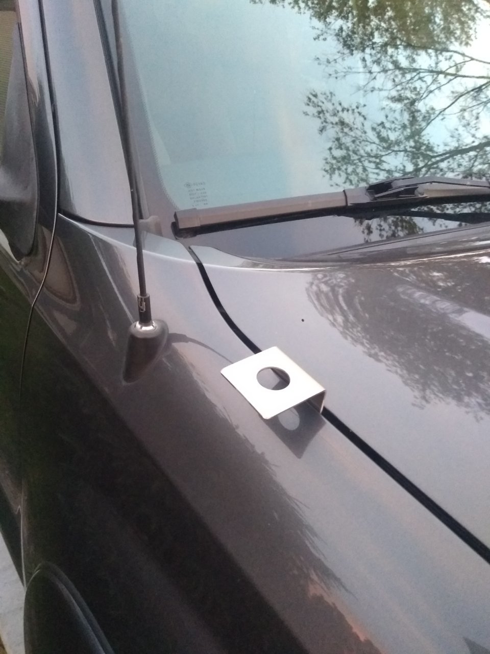

    This is my 2nd gen. Do you think mounting a dual band VHF/UHF in the pictured mount will receive interference from the AM/FM antenna?

    Yes. It will also couple lots of power into the AM/FM.

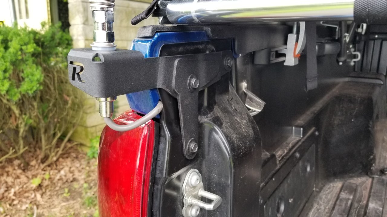

    Yes.
    pickup truck
    This arrangement works pretty well for HF.

    It will not have too much issue with receiving. While it is close to the vertical it is not actually too close. On transmit however you have two issues, one is the loss incurred and the other is the power received on the FM car radio. But technically you shouldn’t be transmitting while you have the FM radio on anyway so even that may not be an issue. Let us know if you cook the car stereo.
