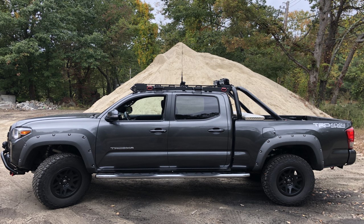

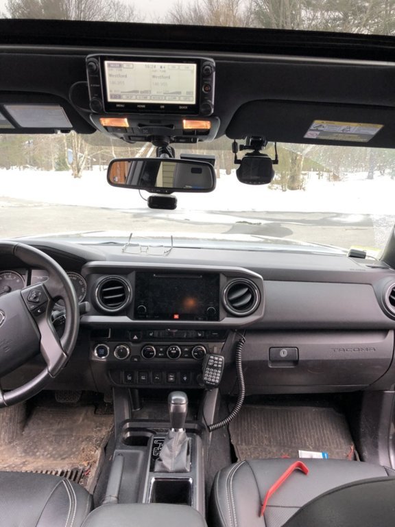

    Did a “clean uninstall” today!
    I’ve been experimenting with trying to fix the poor FM radio reception with various external and properly phased antennas and signal amps. I also had a combo CB/Bearcat Scanner, to primarily monitor the FD when responding to calls. The CB was more of a toy as I have a ham anyway.
    Well I solved the FM reception problem...I gave up. They warrantied the head, I removed interference, I tried 4 different antennas, including testing gain and various cables. All failed to solve the problems so it has to be a bad radio receiver design issue. Hence “live with it”.
    My FD moved to UHF, so I can now skip the scanner as my ham tunes all the locals easily and has basic scanning, and the CB is well, the toy it is, so today I ripped out all the extraneous stuff as my ham covers it all!
    Before:
    After: I centered the ham antenna at mass center for best dipole plane.

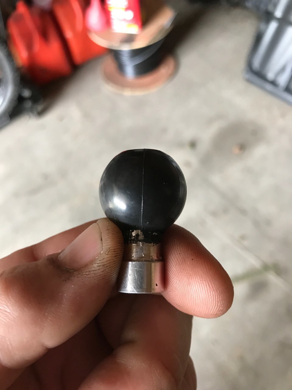

    where did you find the attachment with the ram ball for the radio face plate?

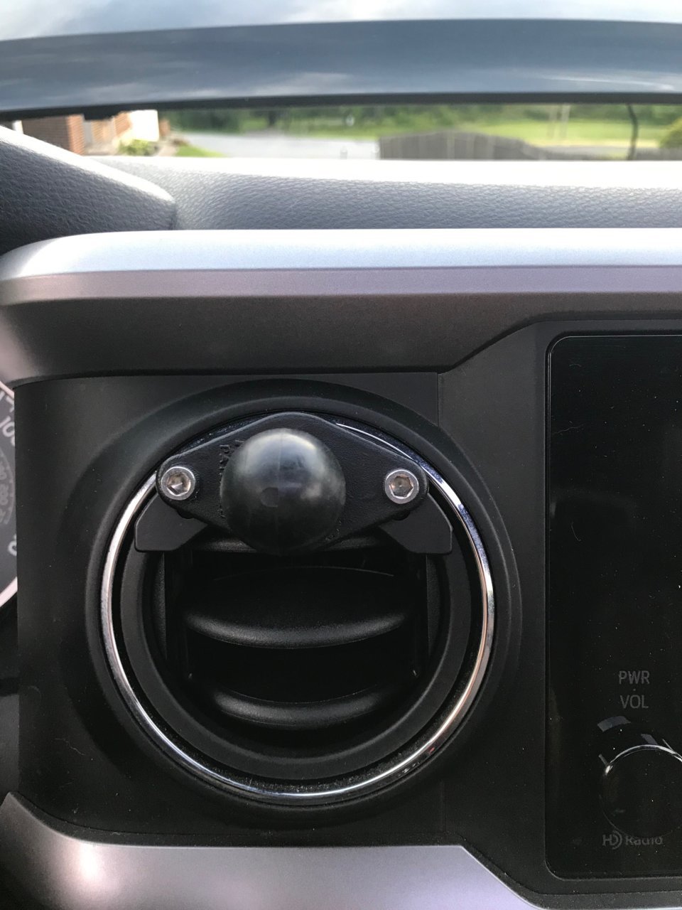

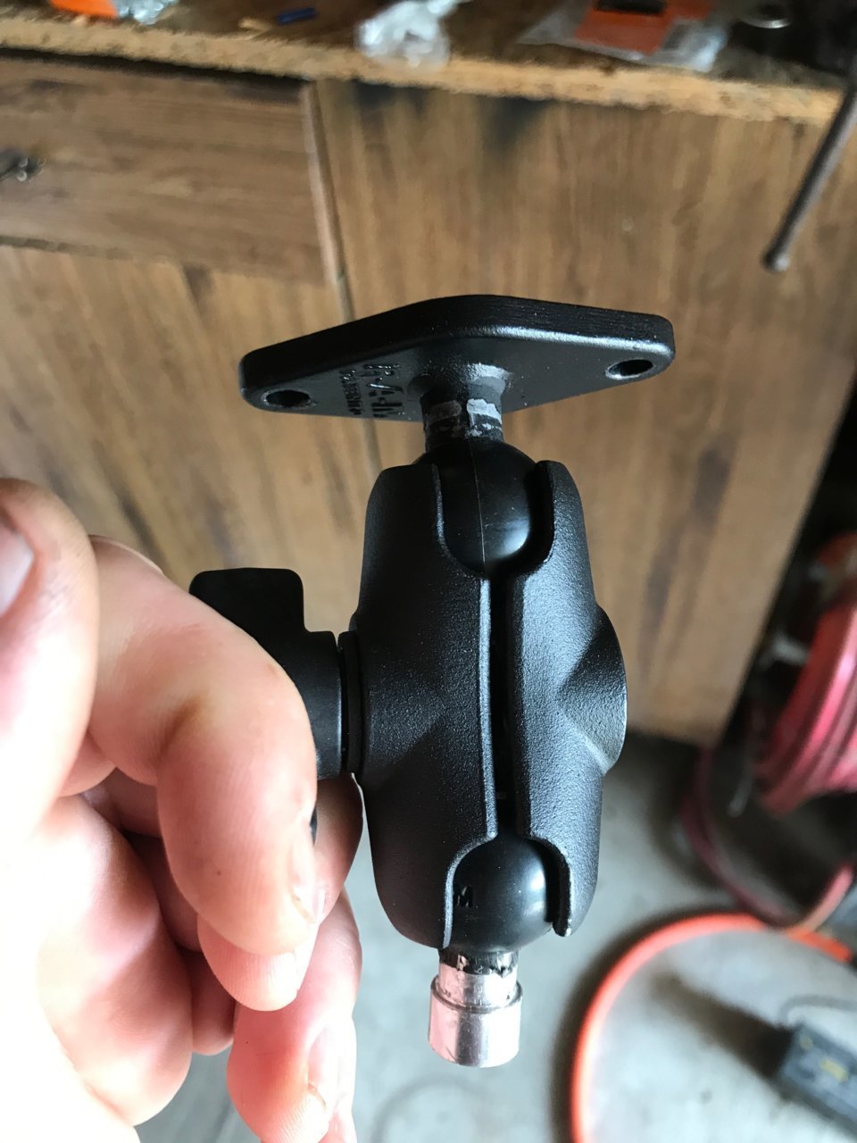

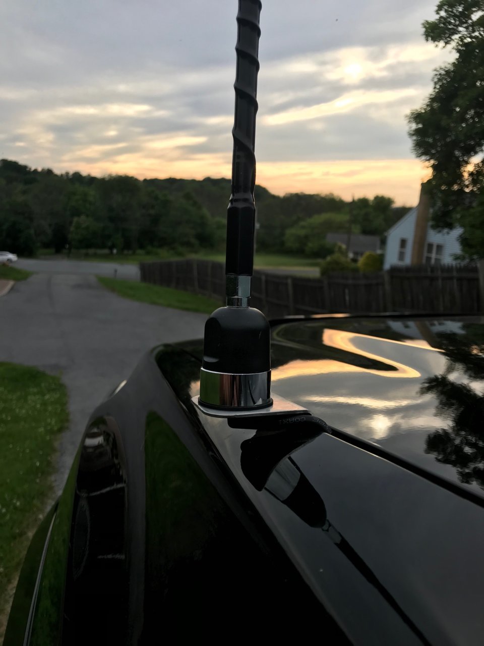

    Found this page while looking for a CB solution, I should add ham setup here. No photos of the transceiver, it's under the passenger seat. It's an Icom ID-770H.
    I bent a long bolt and drilled into the bottom of the radio bezel for the faceplate and had a friend 3D print me a cat5 mount for the mic output. I think it came out well.
    Went with the Diamond NR770HRKS adhesive mount which included a NR770 40" antenna, but I keep that behind the seat and run a Comet SBB-1 16" daily to clear the garage where I work.

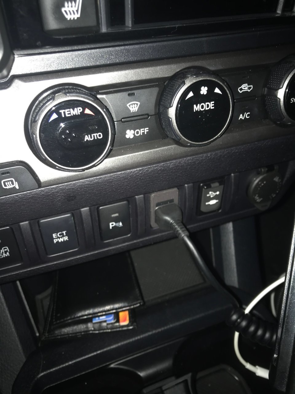

    How are you guys hanging your mic? I still have mine laying in one of the cup holders. Really not interested in drilling into the front dash or anywhere obvious

    3M tape works fine as these mics are pretty light and the brackets have considerable surface area.

    Which bracket? I have doubts tape would stick with the heat

    i have the OEM iCom mic clip. I was skeptical of sticking too. Been two years. One time my passenger “yanked” the mic, it pulled the dash panel out but stayed stuck. I’m a newfound believer in 3M tape. The surface has to be clean and smooth, not textured. Not much to lose if it sticks your good without having to drill.
