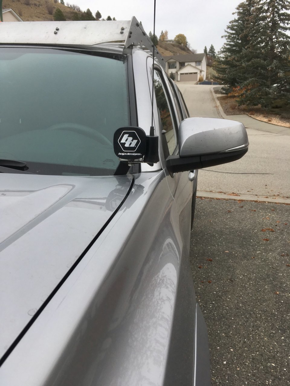

    Most radio shops should have fender mounts available;
    Works for millions of work trucks - was fine for my old 2nd gen.
    I had it mounted on the 3rd gen the same but my ditch light blasted right into it.. so I moved it to the ditch bracket beside my light.
    SWR is fine;

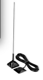

    You could look into one of these...it's a dual band glass mount antenna. I've used them on several vehicles without any problems. As long as there are no AM/FM broadcast antennas (wire type) inside the glass you're good to go.

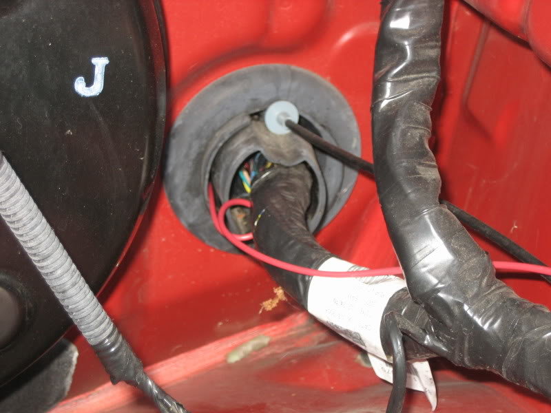

    Or drill a new hole?
    The FM is located in the shark fin too.
    I ended up buying a PL259 from my local electronics store to go through the firewall :notsure:.

    Or just cut it and re solder it on. Would make it easier to get through.
