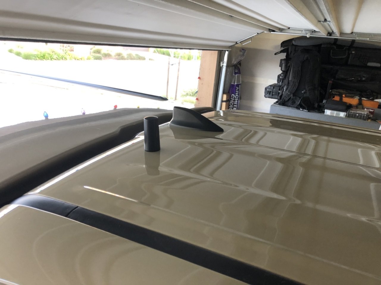

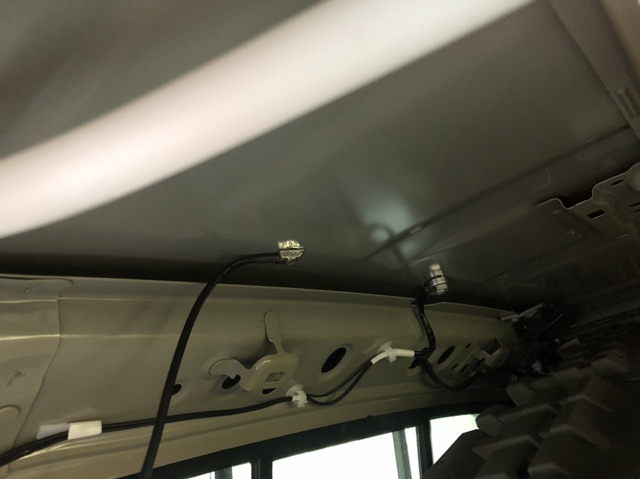

    I ended up with some browning through roof cable and antenna mounts. It turned out fairly well and looks clean. Not super excited about the location but the sunroof dictated where I could put it. Probably be swapping the antenna down the road with a larger whip for trail runs. This is my parking garage antenna but it was working fairly well as is so time will tell. Future HAM antenna will be opposite of this on the drivers side or on a tailgate corner mount from Rago. Haven’t decided yet...

    It looks very clean. In that position you'll have less performance transmitting/receiving behind you, but excellent in front of you. There's a slight chance that the close proximity to the radio antenna could interfere at times, but not certain. I'm curious to hear how the setup performs going forward. Really impressed with how you dropped the headliner. I couldn't figure out how to do that without stripping down the entire interior.
