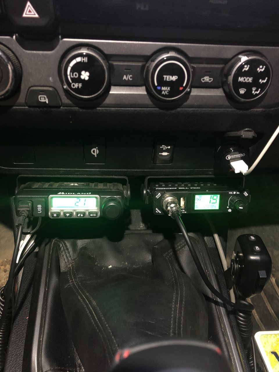

    D139E2EE-5407-468B-8F82-6411932EF2F1.jpgHere’s my setup.. GMRS and CB. Compact design of both made a clean install easy.

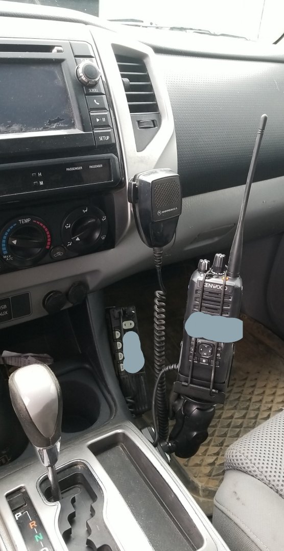

    Here's my setup. Both private band radios. Motorola is VHF.

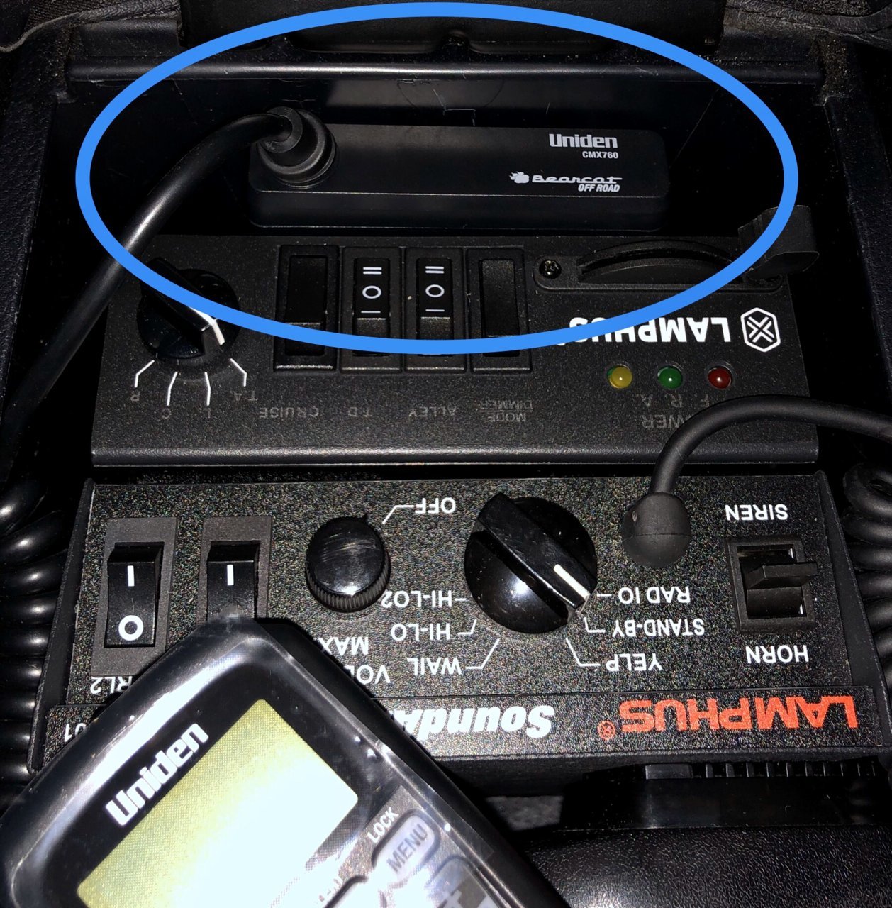

    How's that siren? Do you like it, was it pricey, etc.? And is that a light controller also? I'm shopping around for lights / controller as well as siren, and have just been curious.

    Yes it is good quality. Along with you get what you pay for. For occasional calls it is reliable overkill.

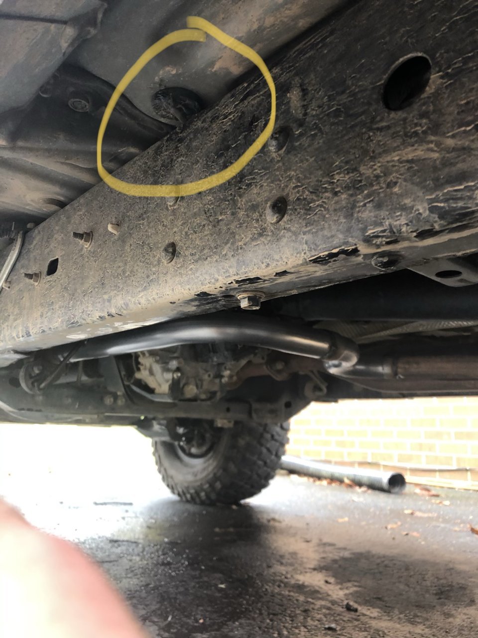

    44E0DE65-FE52-4A15-8A29-DB45C33343BC.jpg There’s a plug on the drivers side, right at the passenger door over the frame that leads into the rear floorboard. You have to pull the carpet back to get to it. I ran my coax through that plug. I slit it with a razor and just siliconed the hell out of it.

    Before you use that one, there is a really good spot on the back of the cab, there is one on each side of the cab about 3/4 of the way down.

    I located this on the outside driver side. On the inside there is the large black plastic wall/pocket. I took off the 3 10mm bolts. Can I just pull this straight off? What is the best procedure?
