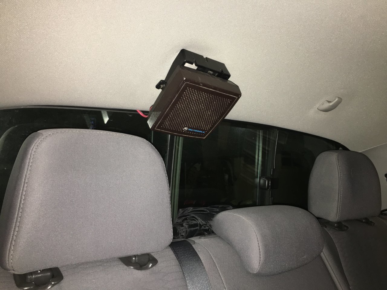

    Had this remote speaker sitting in cup holder for the past year trying to figure out where to mount it. Finally clipped it up here. Not ideal but seems ok for now. Better than the cup holder.

  18. Apr 13, 2020 at 3:58 AM

    No never kicked it! Ive had it for around 2 years looks like there isnt any shoe prints it
