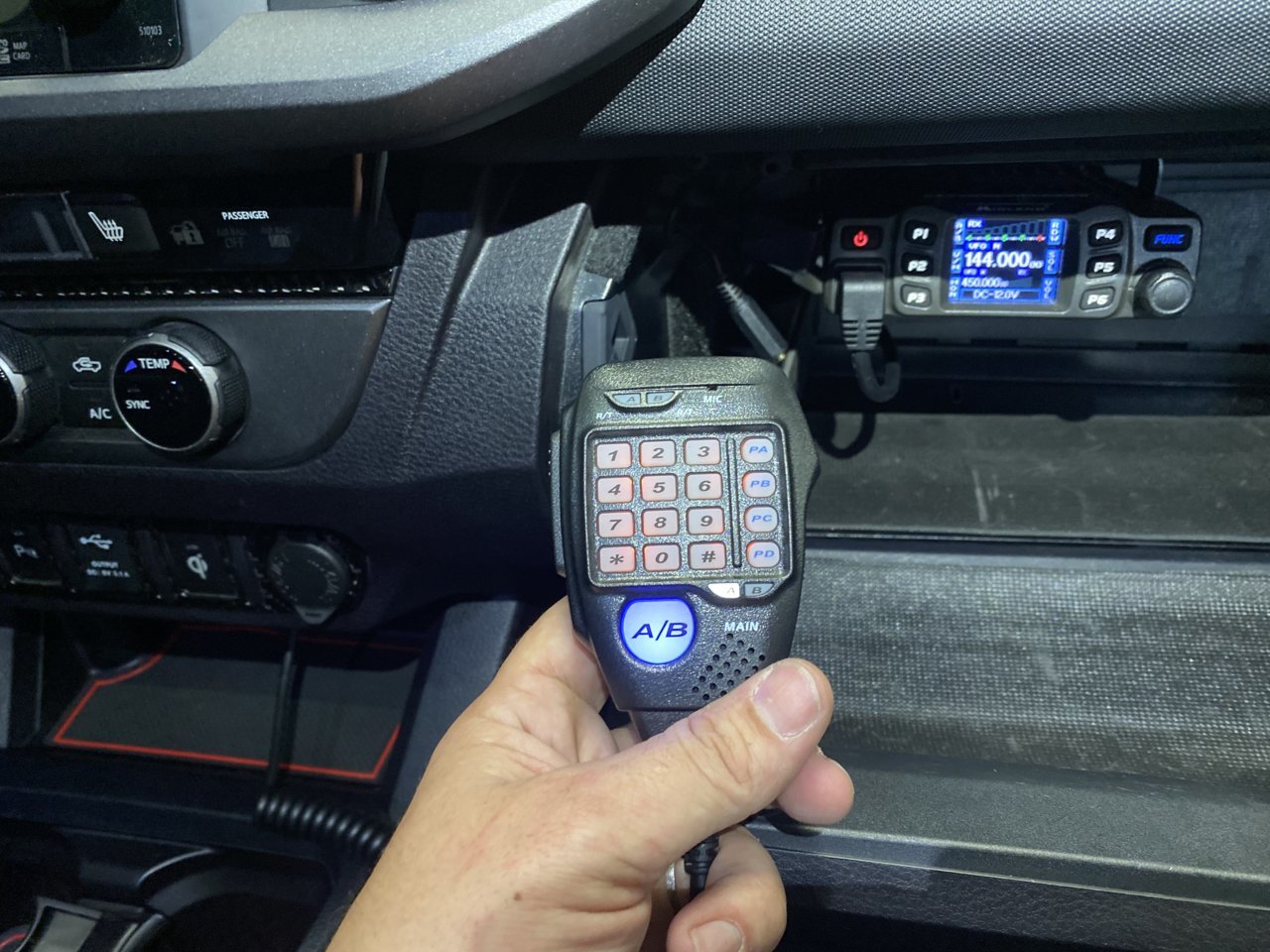

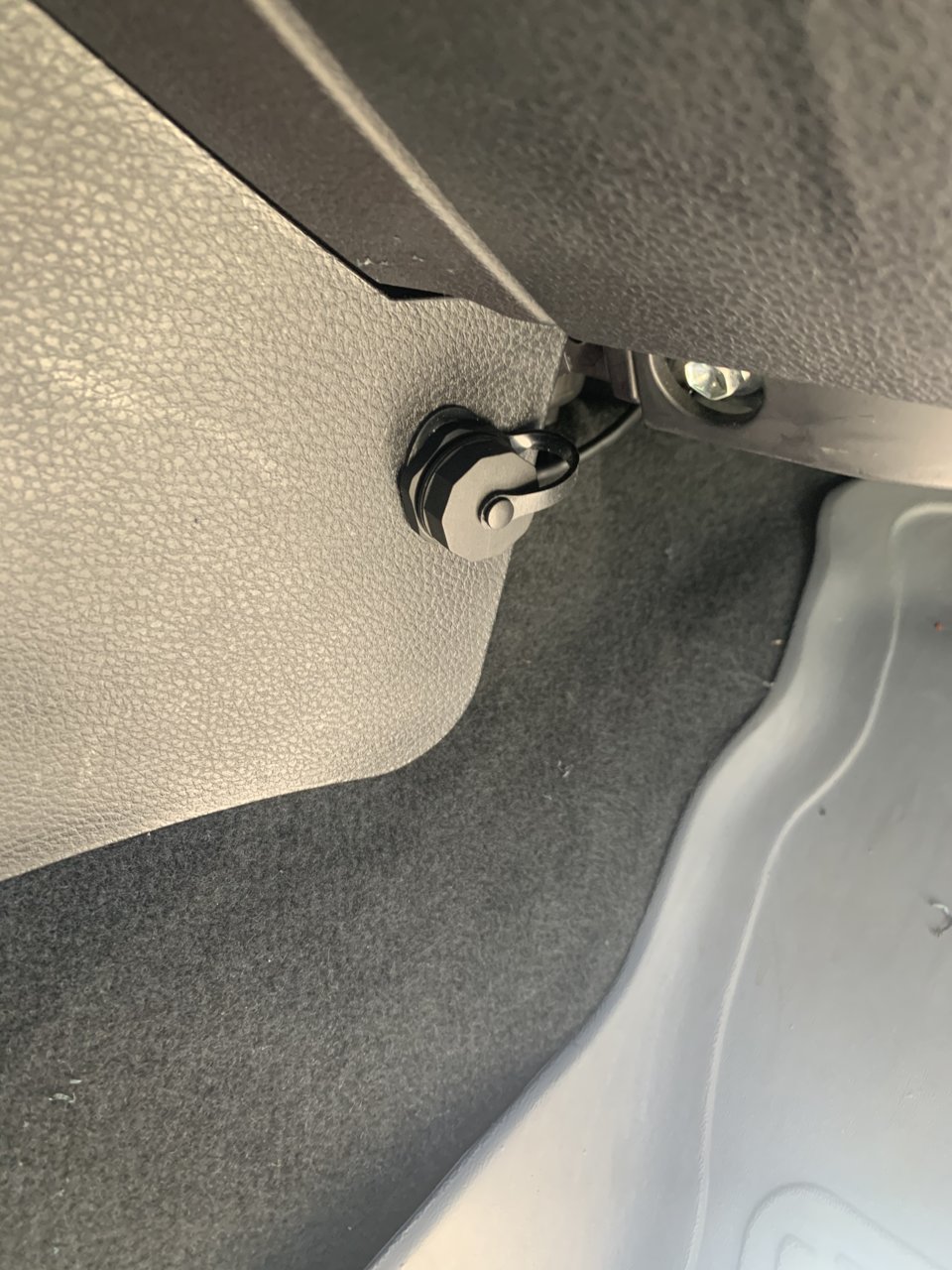

    While stuck at home I figured I'd study for my Technical exam and things went from there... I just finished my Ham install. Went with a Midland DBR2500 to go along with my MXT275.
    I tend not to like anything showing. I already had the MXT hidden under the dash on the driver side with an RJ45 blank in the center console. For the Ham addition, I went with some AirOnBoard plugs under the center console and mounted the unit in the glovebox. My hands are raw from having most of the center dash apart but it was all worth it!
    Tall antenna is Ham and the other is GMRS. Now to take that test... I'm done studying.

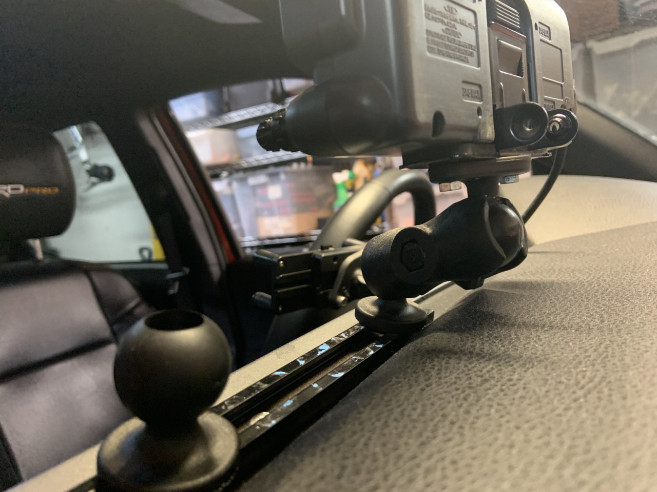

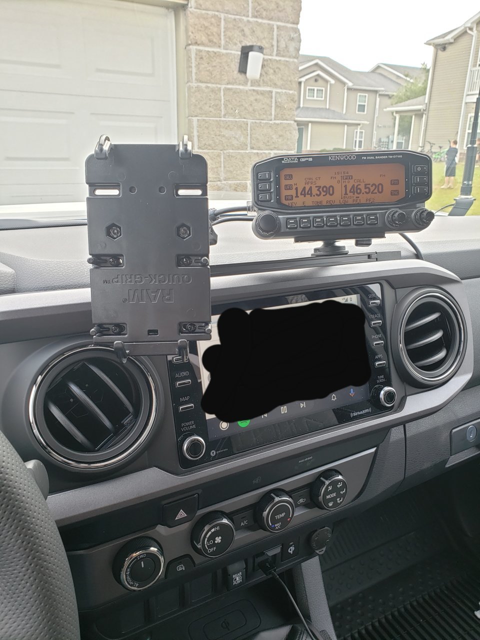

    I tired searching this thread tonight without an luck. Anyone mount their Kenwood control heads with the RAM mount? Just received a TM-D710GA and want to mount the head on my DMM with a simple ball mount. The hole pattern on my spare RAM diamond plate ball did not line up with the control head screw holes. There are a few custom mount options on thingiverse, but looking for a more off the shelf option. Thanks!

    My v71a mount worked fine with a 1/4-20 bolt, I know that doesn't help you but I'm surprised that kenwood wouldn't keep consistency across model lines.

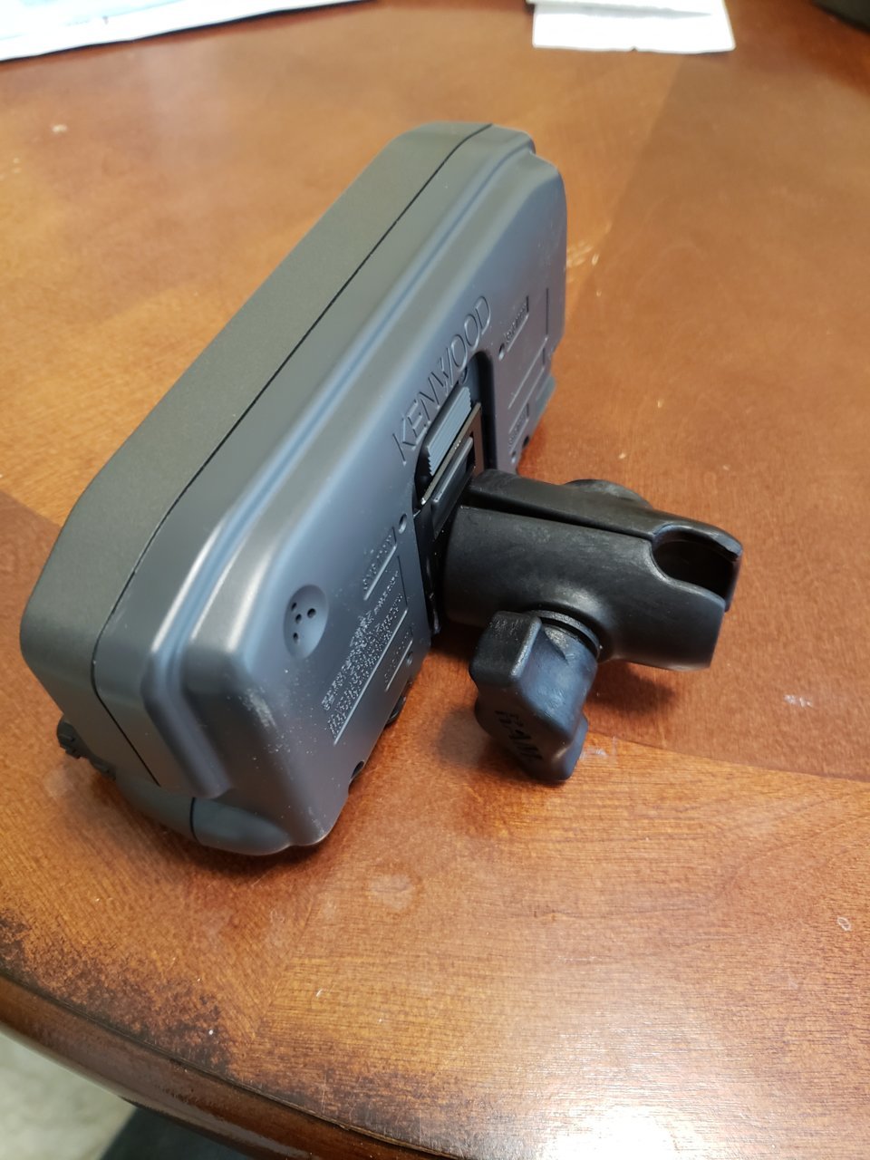

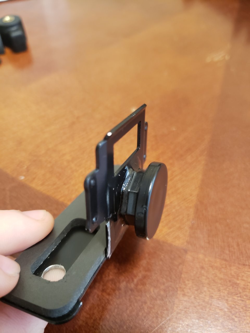

    I modified the supplied bracket to attach it to this RAM mount: https://www.rammount.com/part/RAP-B-200-1-293U . I cut the arms with the bolt holes off the back of the Kenwood bracket, cut down the RAM base to just the octagonal nub, and then epoxied the nub to the back of the kenwood mount.
    If I were going to do it again I would buy this piece: https://www.rammount.com/part/RAP-277U-NP and the socket arm: https://www.rammount.com/part/RAP-B-200-1U instead and skip the dremel mods.

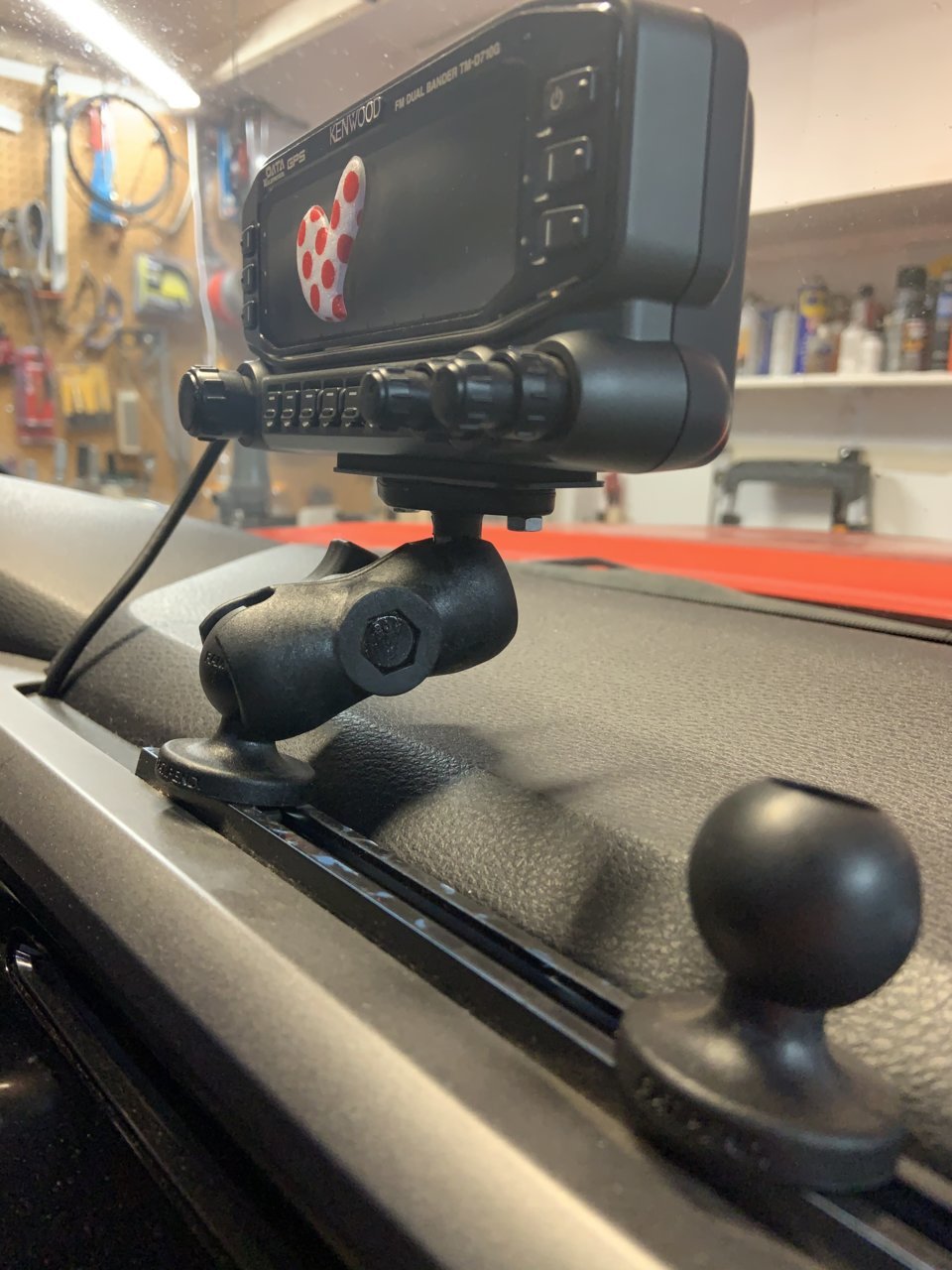

    Stock mount and RAM-B-238U on bottom.

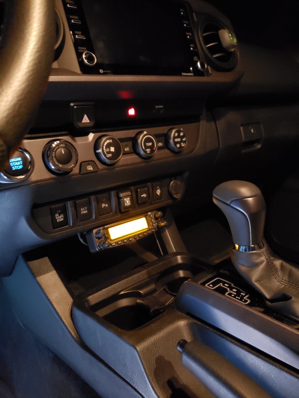

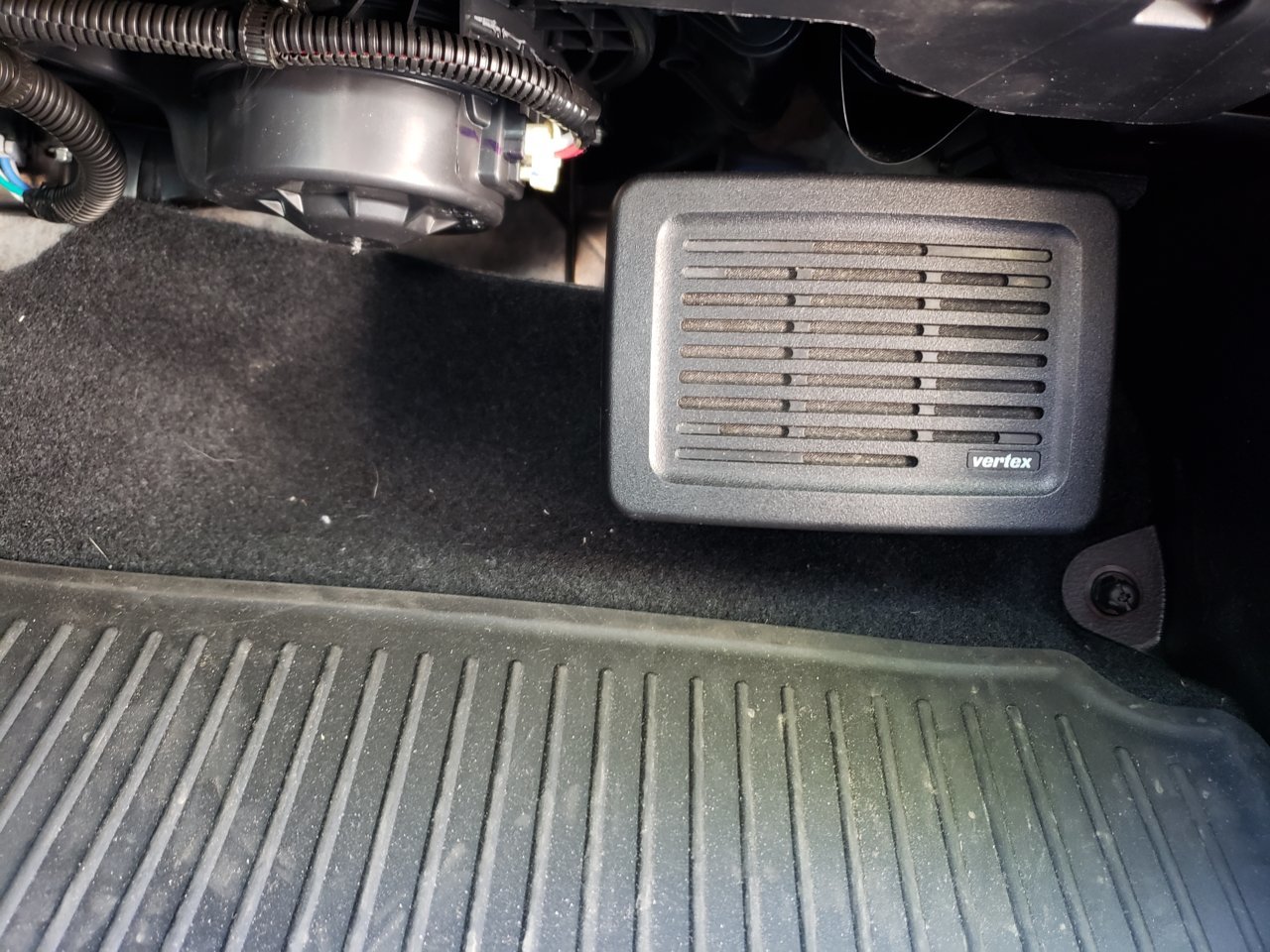

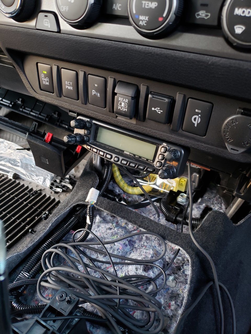

    I finally got my ft-8800r moved over to the 3rd gen.
    ETA: added external speaker picture

    Thanks. It was a major pita getting the dash apart to get the lower switch panel out but so I am happy with the end product. I didn't get any pictures of the external speaker mounted in the passenger footwell. I will grab some shortly.

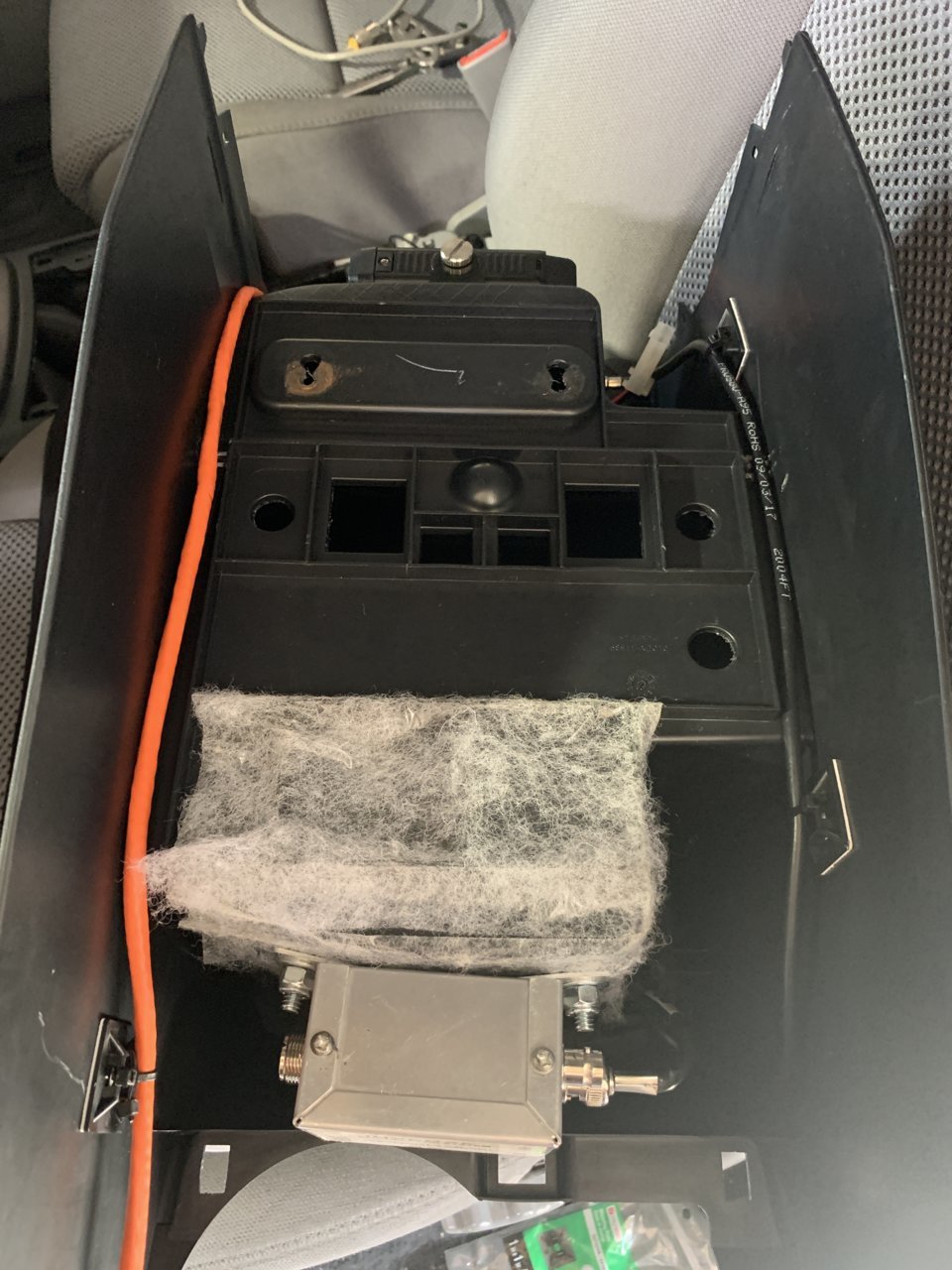

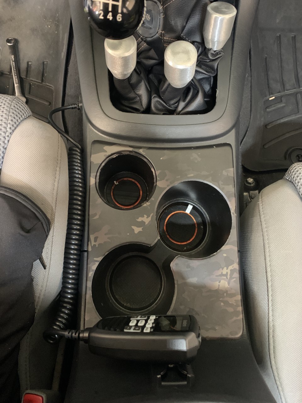

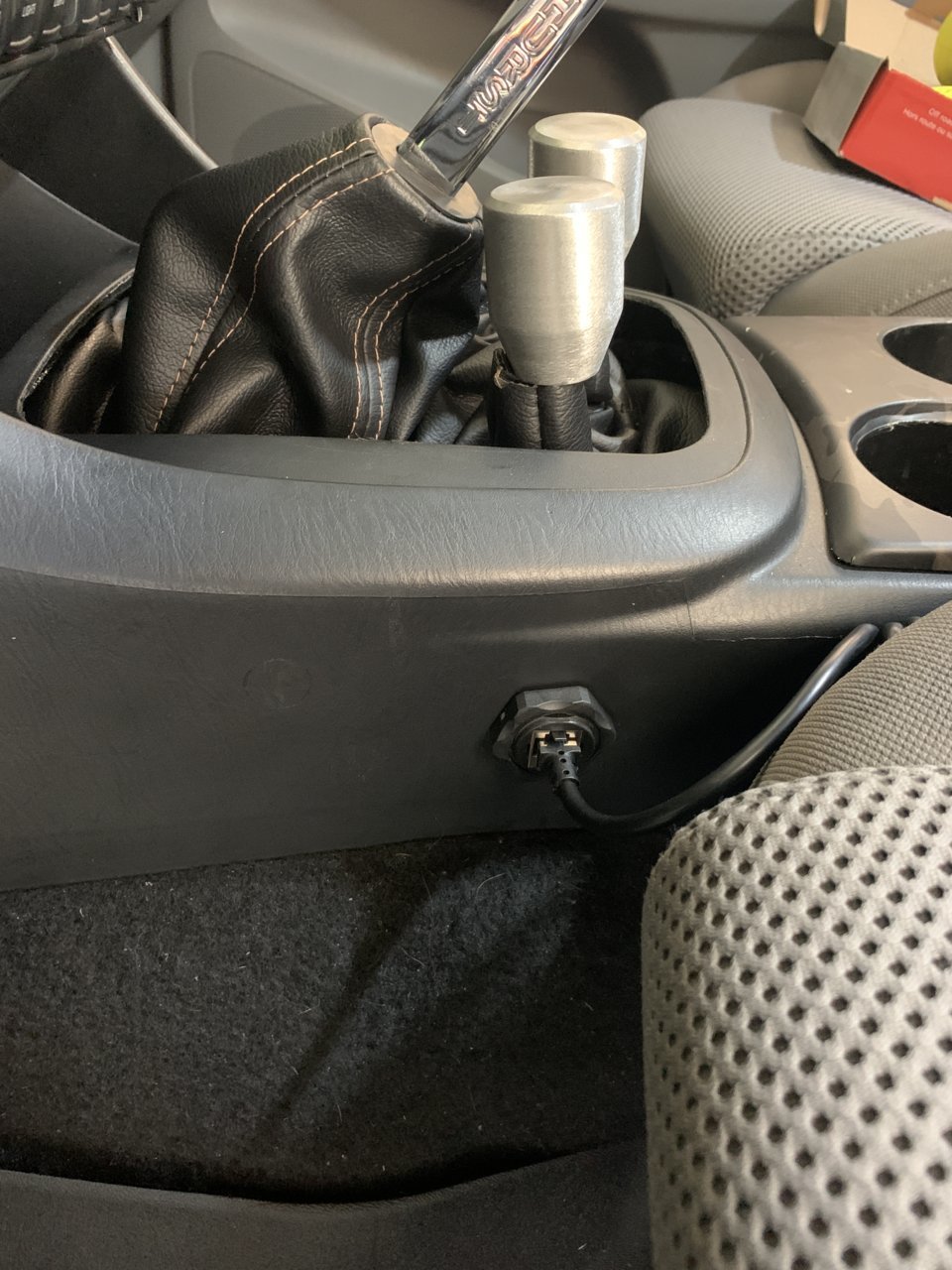

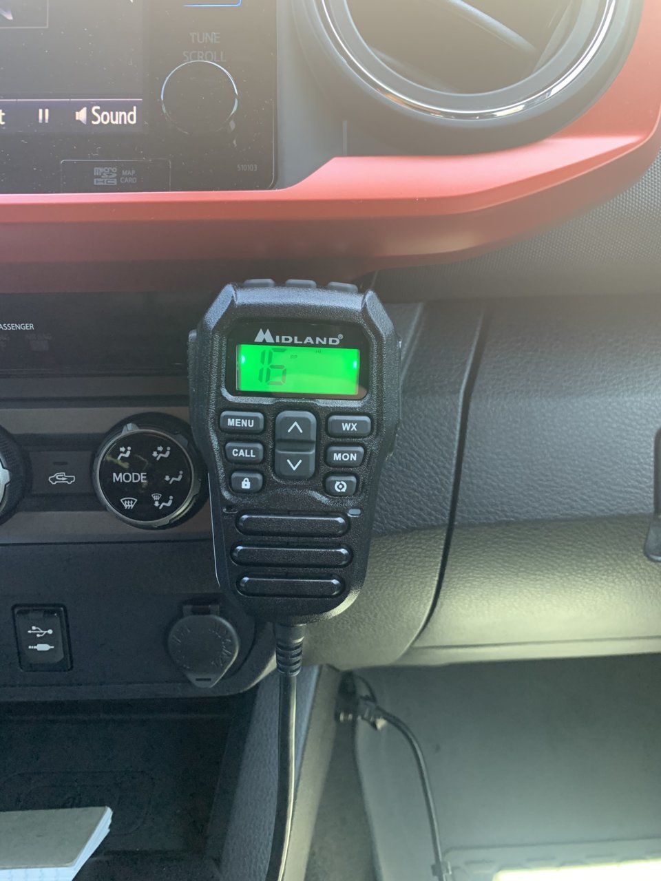

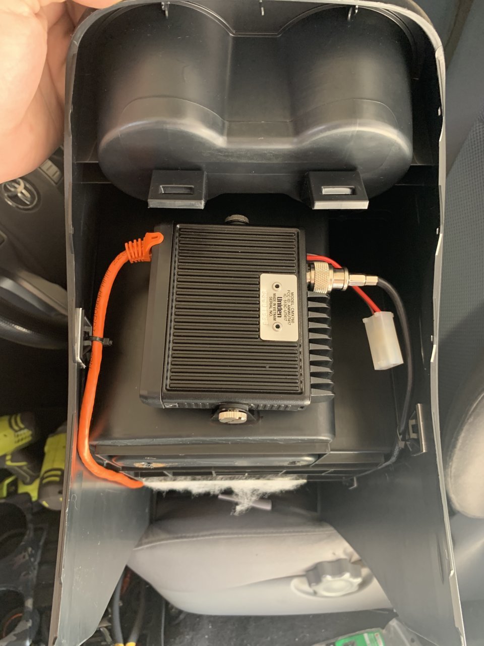

    I mounted mine inside the center console. There's a hollow area inside that's no longer dead space.
    I just used a cat5 to extend the plug for the mic.
    Used a flush plug
    And done
