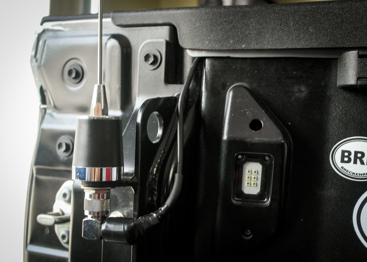

    I have too many reasons to avoid mounting to the top (future rack for ski/snow boarding, existing shark fin and low garage height). A few posts back nixed my hood mount location (radiation from 50W+ VHF/UHF radios).
    Not excited about the back location, but thinking it may be the next best location (unless someone can think of a better clean option). If i go half wave (vs 1/4 or 5/8), that should help out the ground plane issue a bit, right?

    Thanks auskip07. Are you running a topper? Assuming this is CB (for wattage and frequency comparison) and the 5-7 miles transmission is in the forward direction, correct?

    no topper but i have the tailgate cb antenna mount like you described. Yes CB, yes forward direction.

    Every single industrial truck out there be it Forestry, Mining, Highways, Or Govt, have front drivers side fender mounts for their commercial radio.
    Risk for tx above 50w - in the 8 years with my radio in the truck and my 15 year fieldwork before that I’ve never had that situation.
    You will be fine.

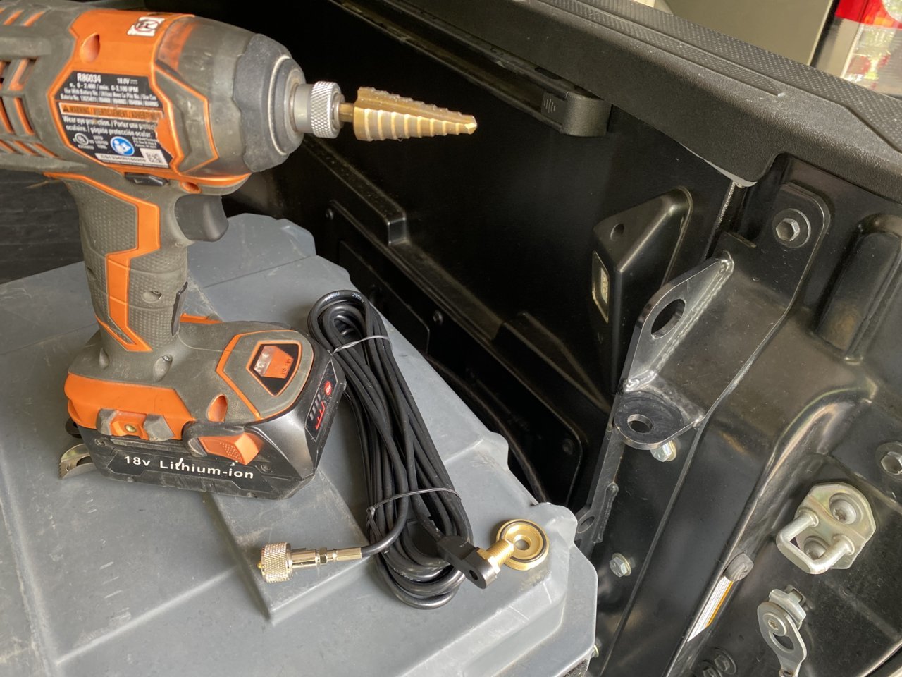

    I have a couple of questions on your setup. How do you have your antennas mounted? I want to mount mine on the inside of the bed. Really do not want to go about the taillights. Can you post a pic? Also, where did you find those RJ45 plugs? Very nice setup.

    RJ45 plugs are from aironboard.
    I have the antennas mounted to my Total Chaos bed stiffeners.
    I’m now using midland low profile cables instead of that 90degree adapter.

    SWEET!!!! I was thinking of doing this but wasn’t sure. I purchased bedrail antenna mounts but I just ordered the Body Armor bed rack and that is going to be in the way of the antennas. Gives me more justification to order the bed stiffeners. Thanks for the pics. Appreciated it.
