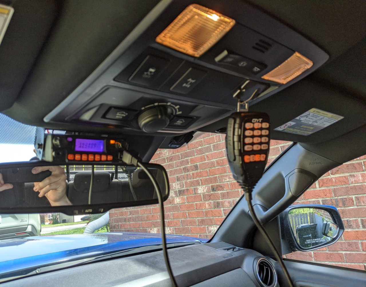

    That is a 3 gen. 2020 TRD Pro with manual transmission. Different cubby than auto's. Power is supplied by the 12V port in photo. No dimmer light wired or required for my taste. My antenna is inside the back window with coax routed under center console and under back seat. Changing to a roof mount in a few days. Got a COMPACtenna SCAN-III to try out. Coax will be routed through my DAI which should be a first for any Tacoma!

    Thanks. I like the dimmer, so I'll try to figure out where to hook into that. Did you take the cubby out at any point? I'm curious as to how many other parts of console or dash panels might need to be removed. I have to ask what a DAI is?

    What's the details on that mic hanger? I like that.

    Very nice job mounting the control head.

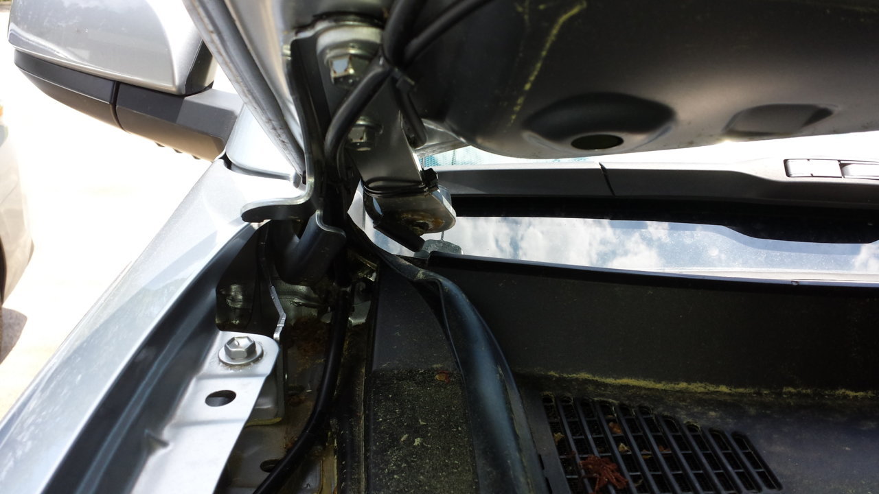

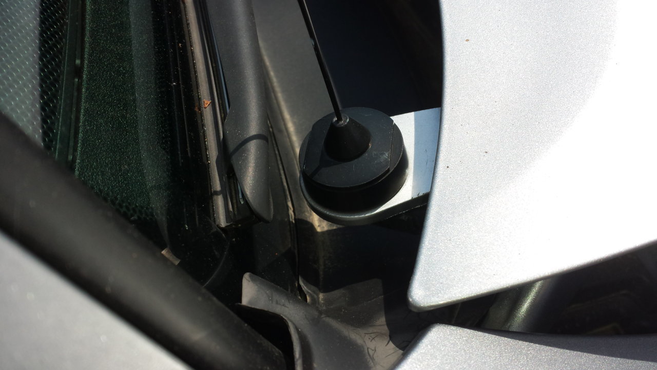

    Close up hood closed:
    Close up hood open:
    Under hood:

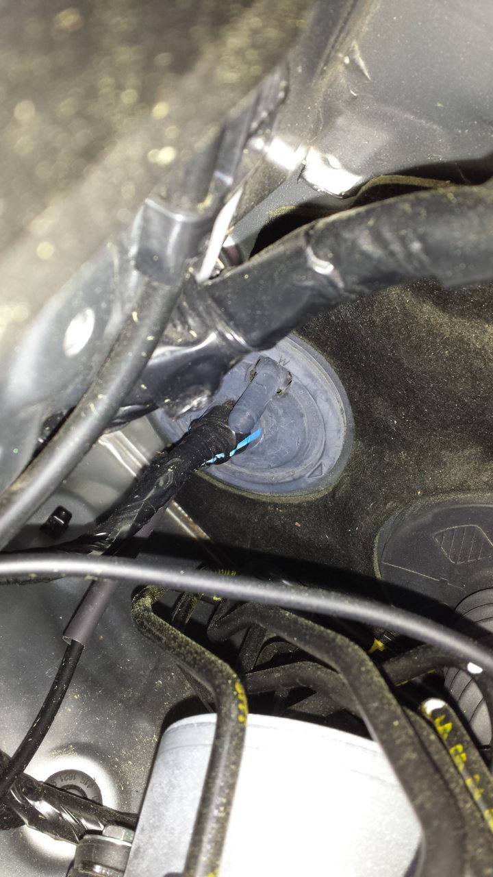

    I ran my coax in through the A/C grommet on the passenger's side:
    Ya' hardly notice the antenna:

    Sorry, it's Mercedes 1988 getting the antenna. Thanks for the pictures they should be very helpful.
