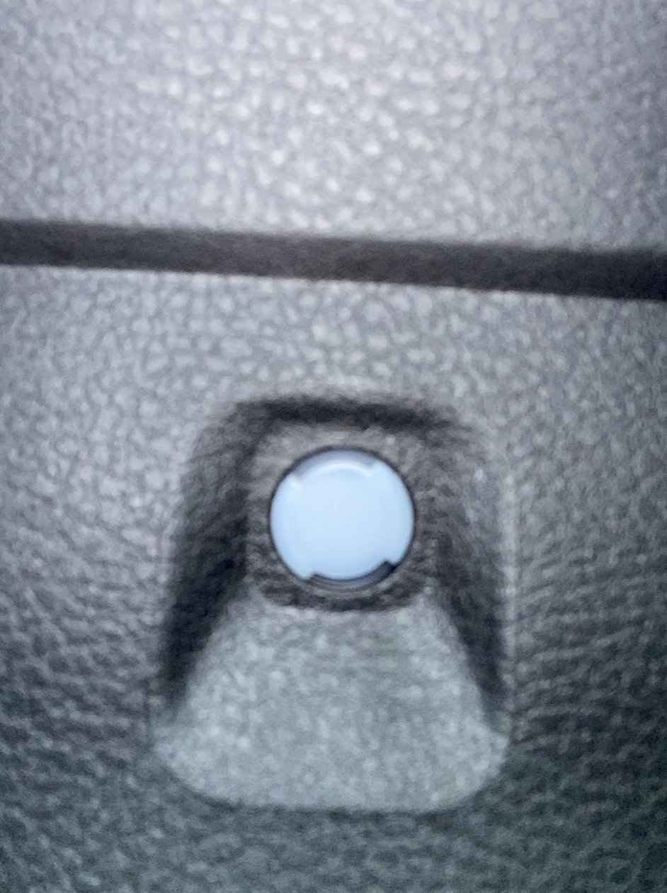

    ETA: I went out to the truck and once again the Velcro didn't hold in the heat.
    So, I took a look and the upper B Pillar trim is easy to remove. I pulled down the weather stripping and pulled off the trim. Measuring carefully, I found a good spot to drill through the trim and still allow the seat belt adjuster to work.
    The screws went in from the back and then the bracket was attached with metric nuts. I drilled the holes very tight and expanded them ever so slightly with an awl. Everything tightened up, placed back, seat belt adjuster operation test.
    Two things I also discovered. There are airbags built into the seats. Which is why there are none in the B Pillar. Yes, I know, I've just won a PhD in "Duh."
    Also, there is a seat back storage pouch on the passenger side. In that, I found a receipt for aftermarket window tinting from a local outfit. Oh, and a panoramic mirror that snaps on over the OEM rear view mirror. I have no idea what I'm going to do with that.

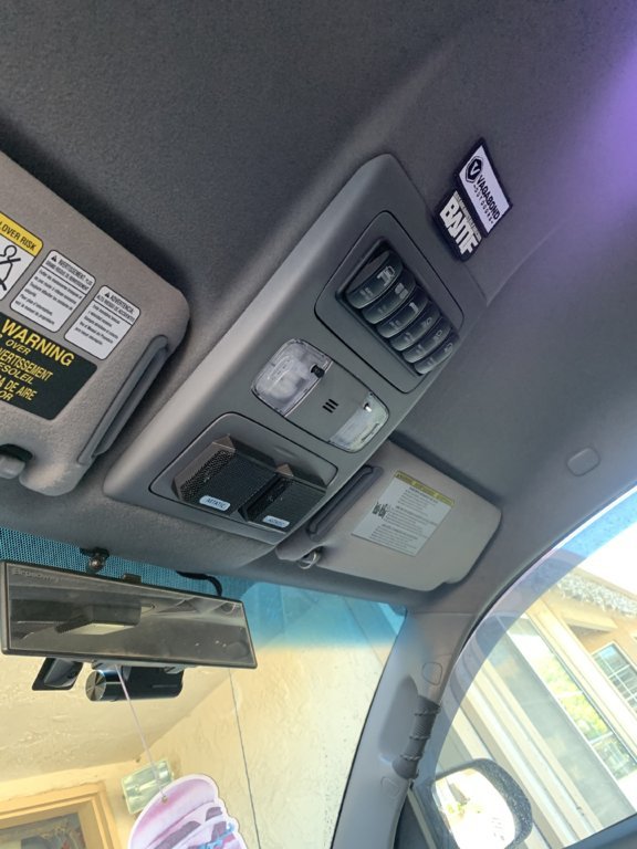

    i like that location. Had I seen your post earlier, I may have done the same. I ended up installing two speakers into my sunglass holder this past weekend. I had the two speakers laying around so I installed them both. No clue what I'll use the second one for just yet (maybe a cb to go with my ham).

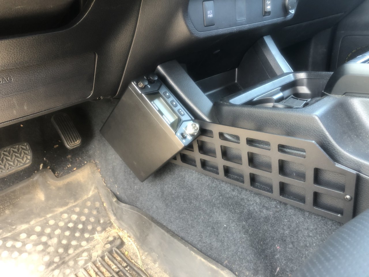

    Realized I never posted my Molle Panel CB. I got a lot of inspiration from this thread as far as making the install as clean as possible. The CB is held on by industrial Velcro. I ran a CB like this in my last vehicle and really liked it. I tried installing it with the speaker facing out but found it's actually louder with the speaker side facing toward the center console. Probably because the sound gets amplified that close to plastic.
    For my antenna I used one of those ditch-light extension brackets and a 3' Firestik. It's pretty flimsy when you physically wail on it, but I haven't noticed it moving all that much under normal driving conditions. To keep the connection low-profile I used a FireRing.

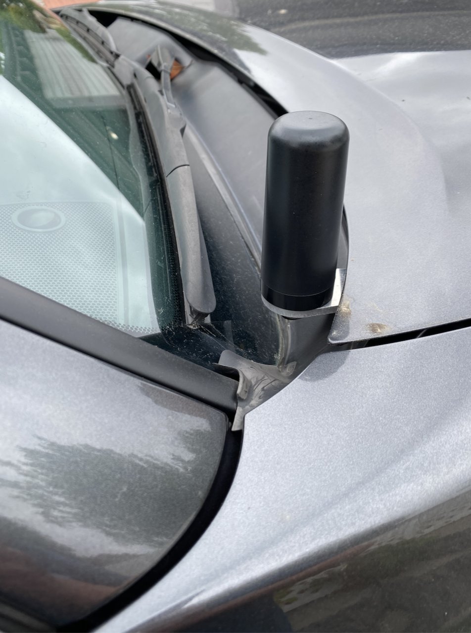

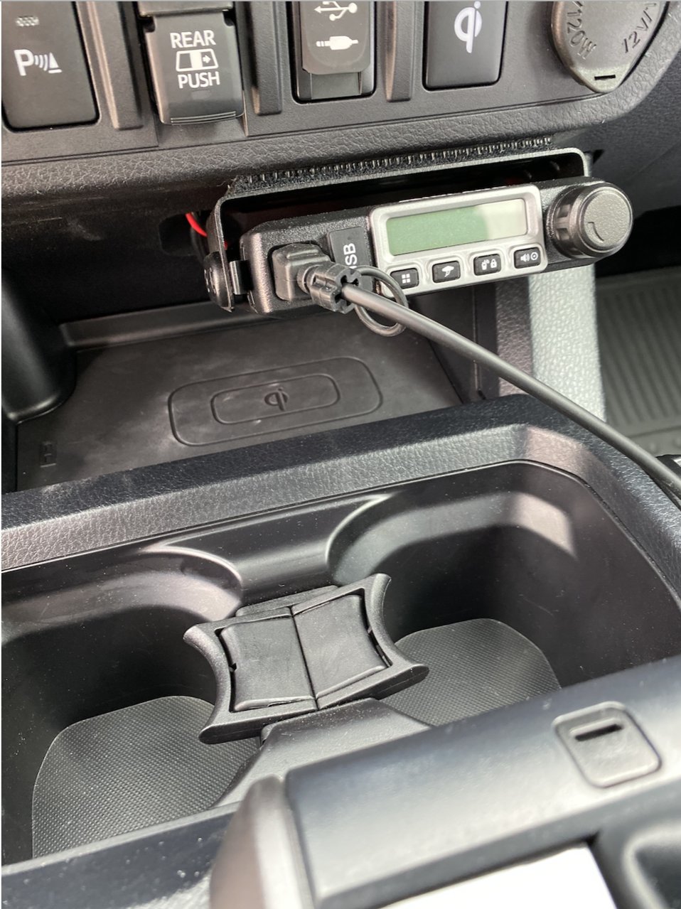

    Pretty simple install of the Midland MXT115 GMRS radio.
    There's a little light above the Qi charger that is easily unscrewed and I pushed it inside (didn't want to fully cut it, so just left it inside the dash). The light is extremely dim and I didn't even realize it was a light until I was looking for ways to get my wires inside. Not much of a loss to lose it.
    I fed the antenna and power wires through the light hole and into the dash. Industrial strength velcro to the radio bracket and dash, no screws. Soldered the power wires onto the cigarette lighter. I debated running the power directly to the battery but decided against it. The DC power is easy and shuts off when the truck is off. I ran the Midland MXTA24 6m antenna wire with NMO connector behind the dash and through the passenger front firewall hole, connected it to the midland MXTA25 antenna on a Victory 4x4 Antenna Mount.
    Amazingly, the antenna does not hit the windshield when the hood is up! Probably not the perfect mounting location for an antenna but it's great for my needs. I like it being on the passenger side but the Victory bracket can be used on either side.
