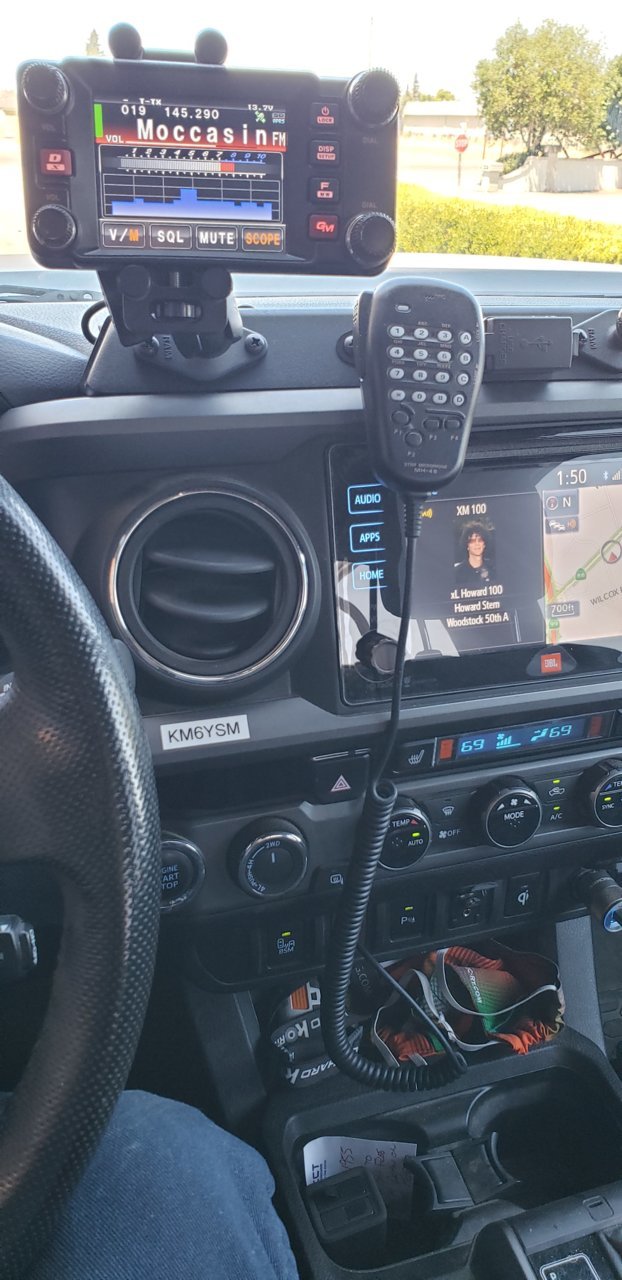

    FTM400 in my 2016. I rewired the ECT to a MESO stealth pro shift knob. Installed a keystone where the ECT button was. Ran all the cabling behind the stereo and installed a powered accessory mount by Expedition Essentials.

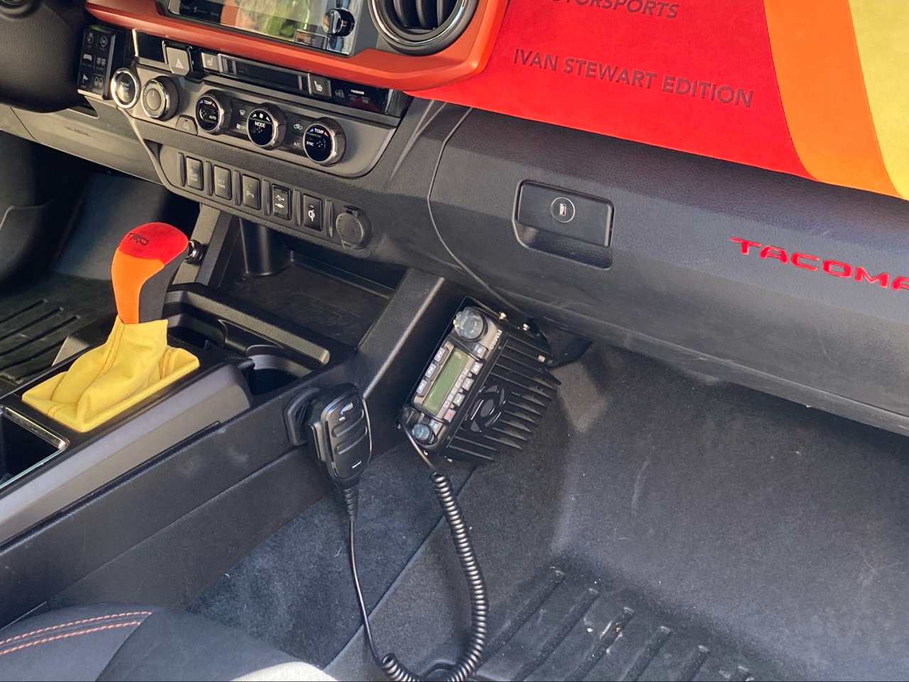

    Here is my set up . The magnet mic is super cool. Rugged Radios are the bomb F4C0B0A0-420F-46CD-A722-E53081E4C975.jpg
