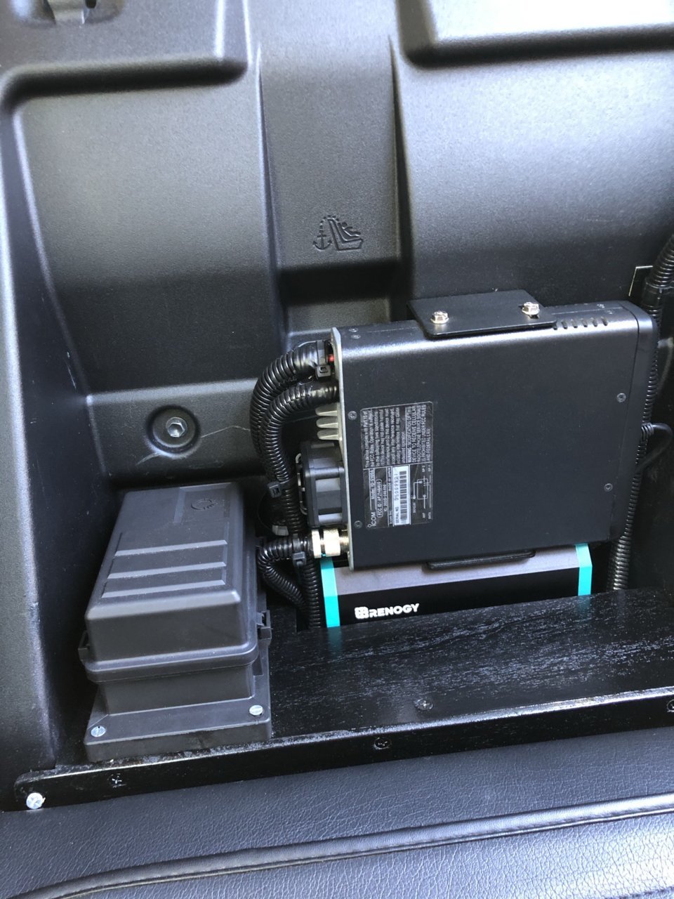

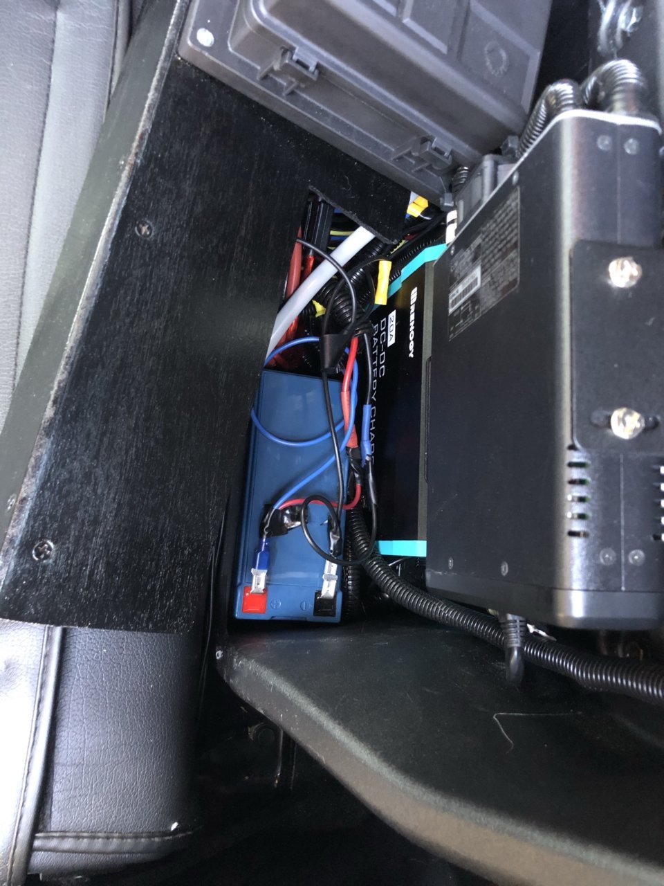

    Installed a new auxiliary battery in my “Whiskey compartment” as my two year old one died. Went slightly bigger to give more run time. This is isolated from the main run battery when engine off and has its own charger also in pic.

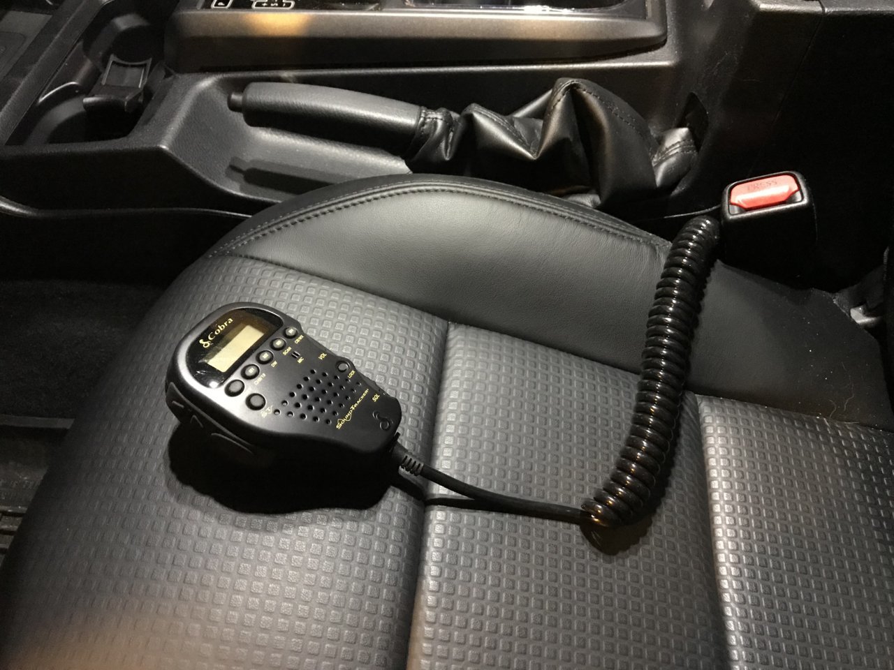

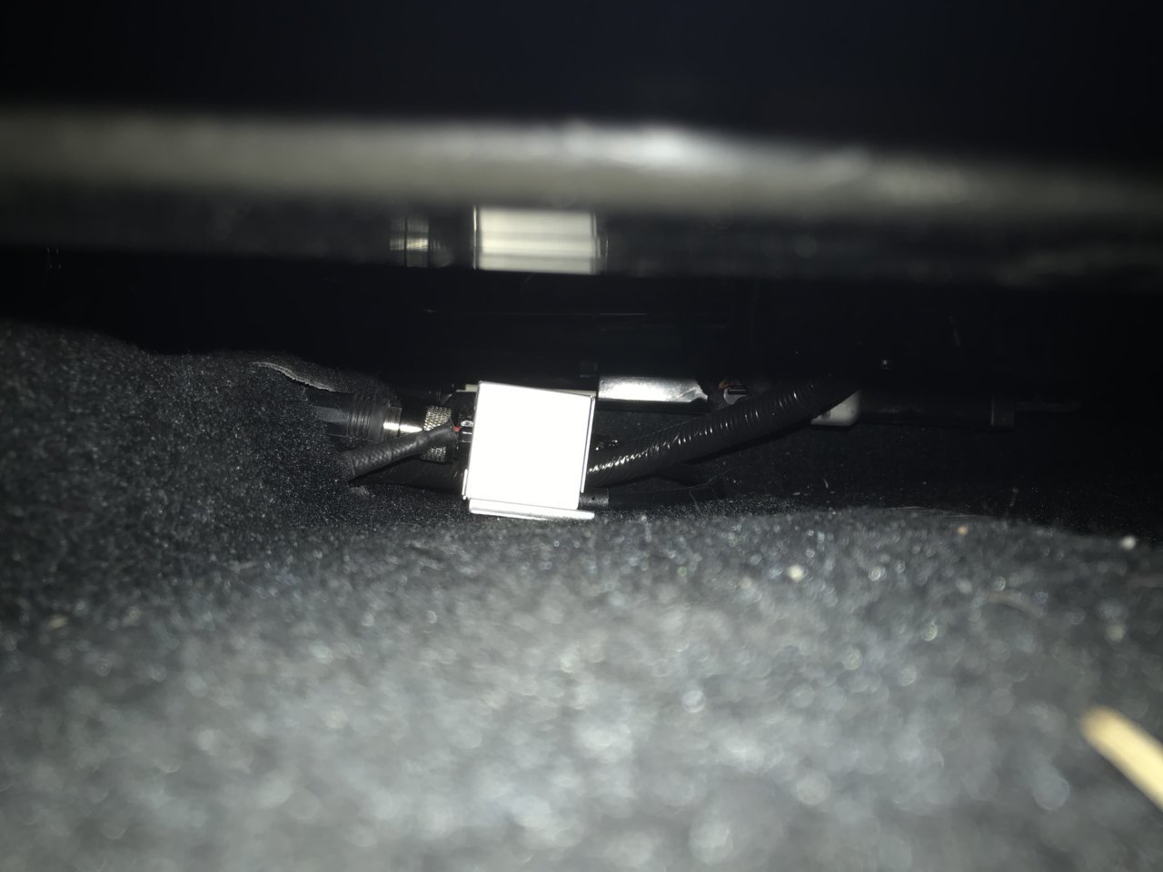

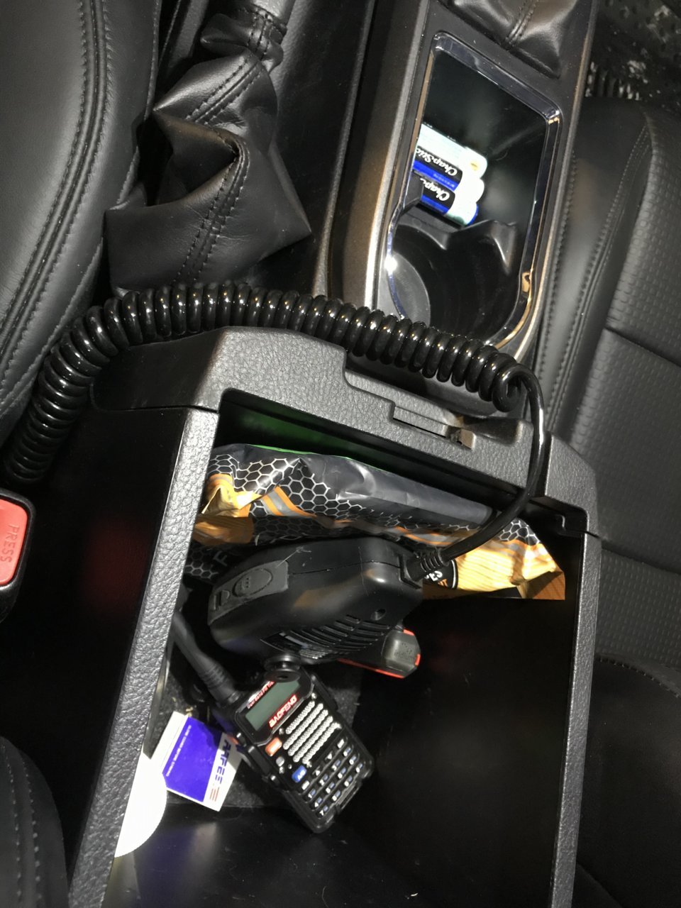

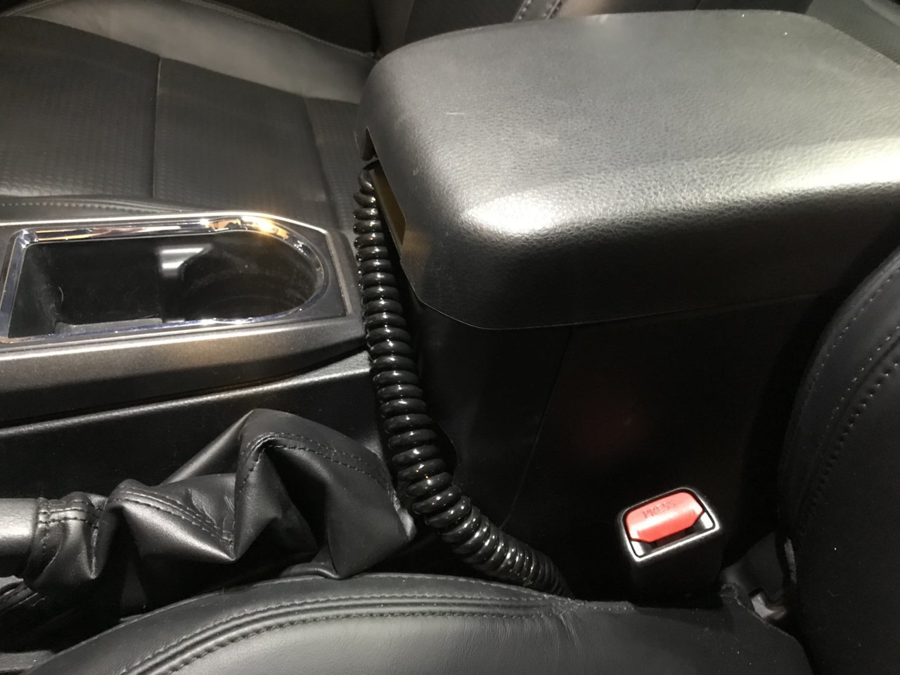

    I used a different CB but I did something that might be the look you’re going for.
    Ran the small connector box that the antenna cable, mic, and power wires connect to under the driver seat.
    Then ran the mic between the seat and center console, and when I don't need the mic it goes into the center console via the cable indentation.
    [​IMG][​IMG]
