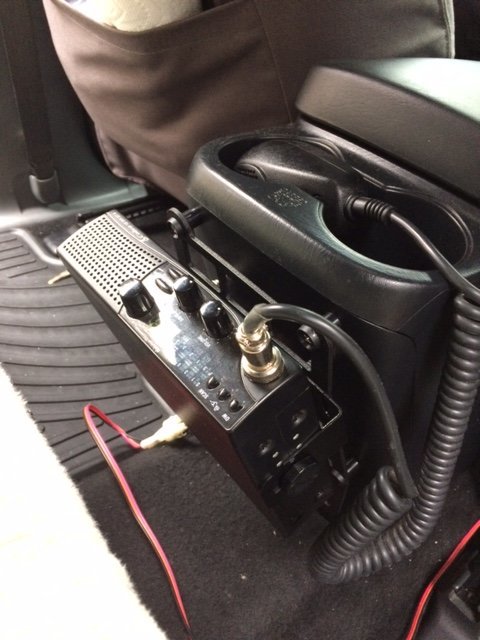

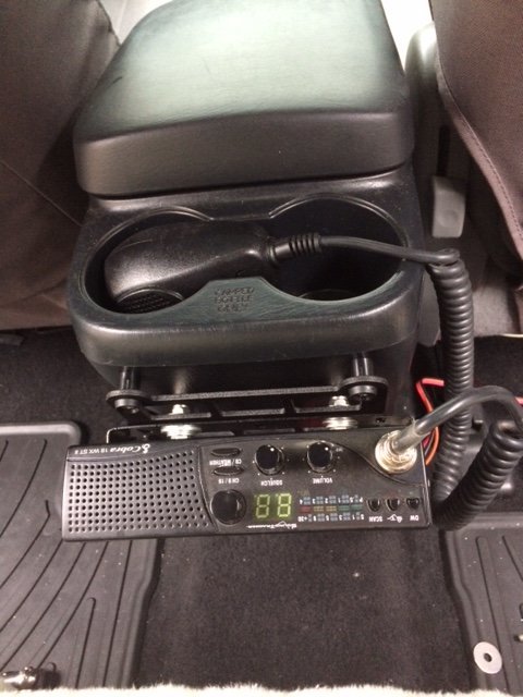

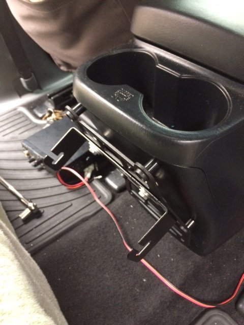

    Installed Cb on rear of the center console via a Molle Panel/Rack. This mod will not allow you to extend the bottom passenger side seat forward/upward. On a 2 gen the Drivers side rear bottom section of seat will still extend forward as will the back rear upper part of the seats. (Both drivers and passenger)
    Thoughts on this? The only thing stored under the passenger side rear seat is the bottle jack which I do not use anymore! All tools are stored in accessible compartments. I just didn't want it up front taking up room!

    will this interfere with tall people sitting in the back?

    I assume by your response that the speaker isn’t mounted on the C pillar like I thought it was.

    It's mounted on the B pillar, so mine is the only head in danger if the seat mounted airbag doesn't do it's job.

    I’ve been thinking about mounting mine to the c pillars. Maybe that’s why I interpreted the pictures like that.

    And the C-pillars have airbags. F.
