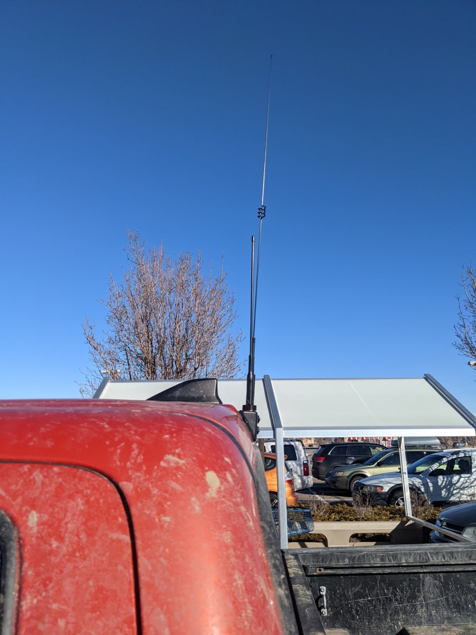

    Having my dual band near the center of mass makes for excellent dipole transmission. 35 miles is common. Being above the cab likely helps as it’s a decent surface. It is off center right so I “feel” like more of the lobe is to the left, but I’m mostly hitting repeaters so frankly can’t tell.
    With all the true body mass in play at 2M, I’m not too worried about extra bonding for the rack itself as the whole truck is really in play.

    It will couple to the pillar, the cab will block the signal in that direction. Plus that puts the main gain lobe right into your brain. Which is the same reason I'm not a fan of hood mounts.

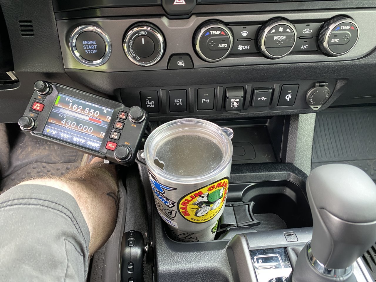

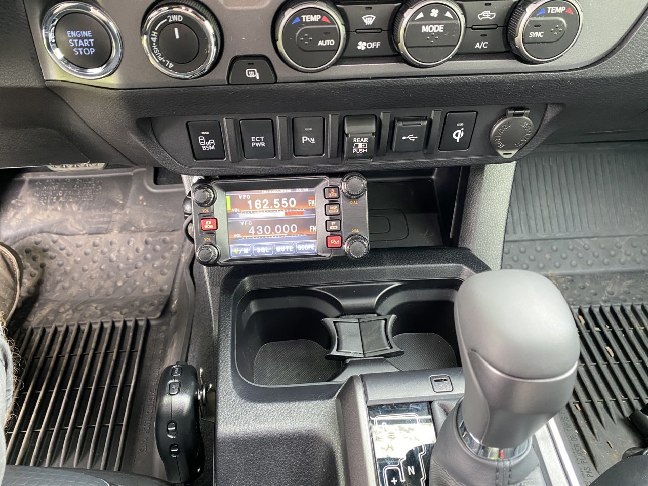

    I have a Yaesu FTM-400 on a short RAM arm mounted in front of the wireless charge cradle. Radio body is mounted under the driver seat.

    How's the GPS signal for aprs with it mounted low like that? Still sitting on mounting my 400's control head while I finish running everything else for the system. 1st choice is up on the taco garage dmm on a ball mount. But my gut is telling me our socal desert sun (which I spend a lot of time in) is going to cook the head, and I don't want to deal with unmounting it all the time. So my next thought was pretty much right where you've got yours, but I'd like to ensure gps/aprs works to its best potential.

    I’ve got my 400 mounted in the front left cup holder. No problem with GPS signal.

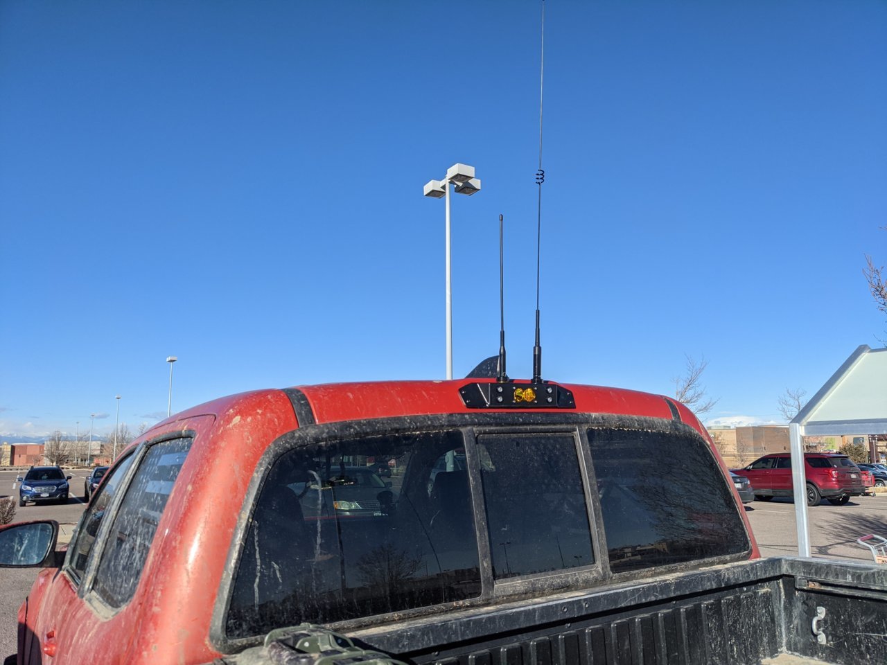

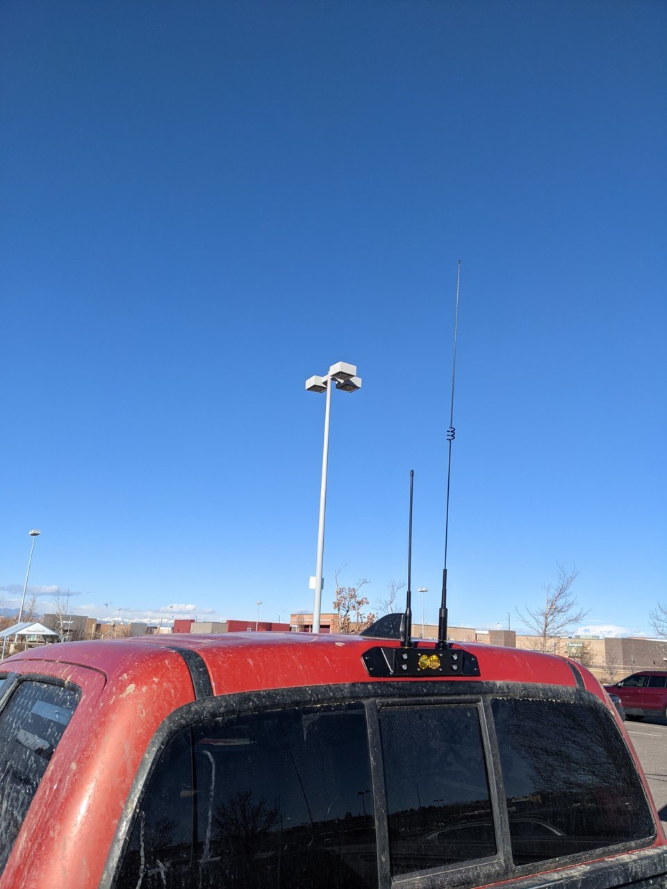

    Some really nice installs on here! Some of yall are really brave punching holes in your roof! I guess I had to punch a few small holes for my rivnuts, but whatever.
    Just installed my Evil MFG Third brake light mount and I am loving it! Looks amazing, works well so far, and well get to test the range on the HAM here in a couple of weeks!

    What’s the VSWR like?

    I'm not going to lie, I have no idea, I dont even know how to test it. This is my first HAM setup. I would be happy to test it out if you let me know how or a good place to learn how?
