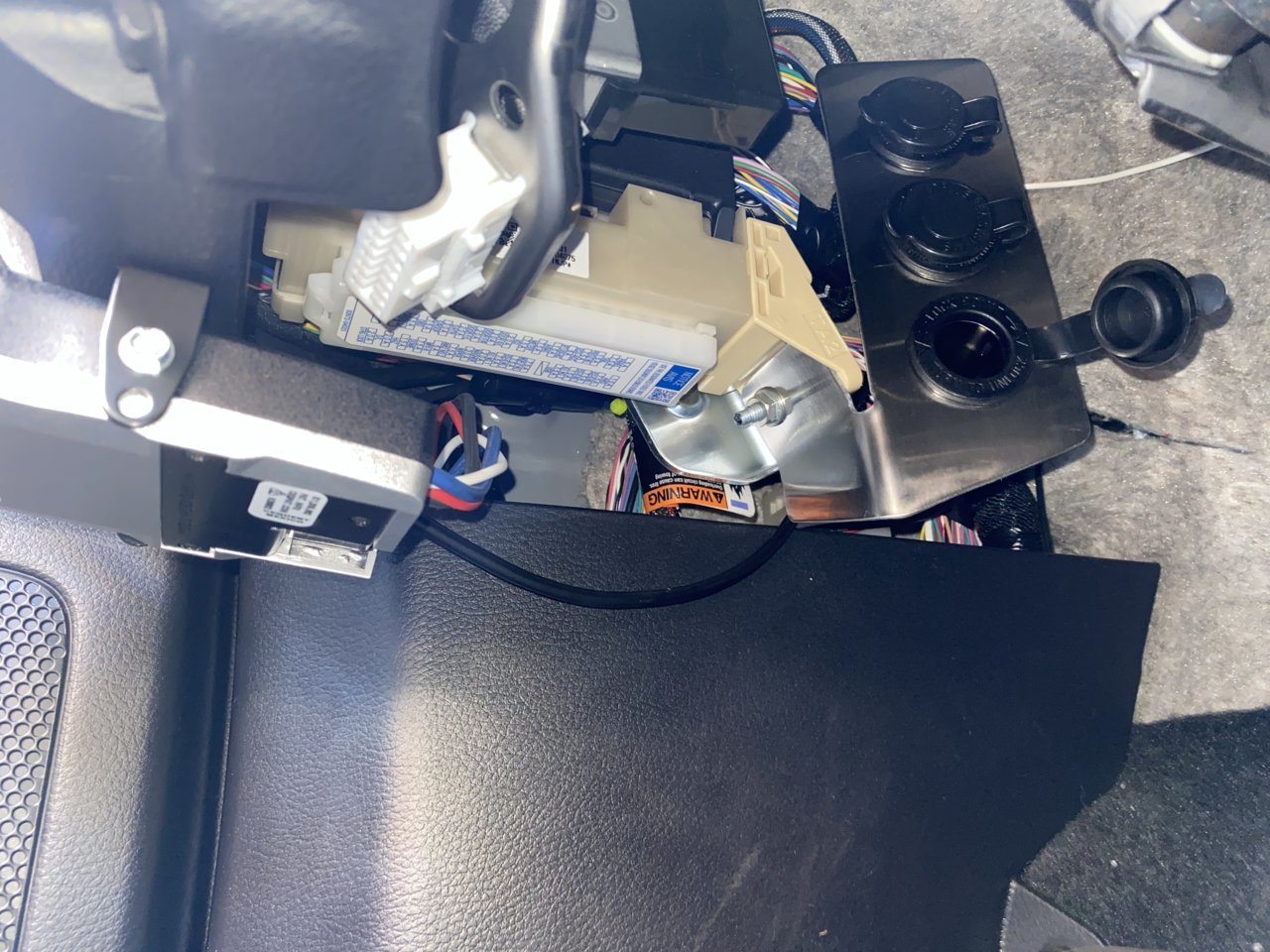

    How’s this for stealth power ports? Made this for the drivers footwell for dash cam and external GPS receiver.
    shiftd, GarlicFarts and Hemibee like this.
