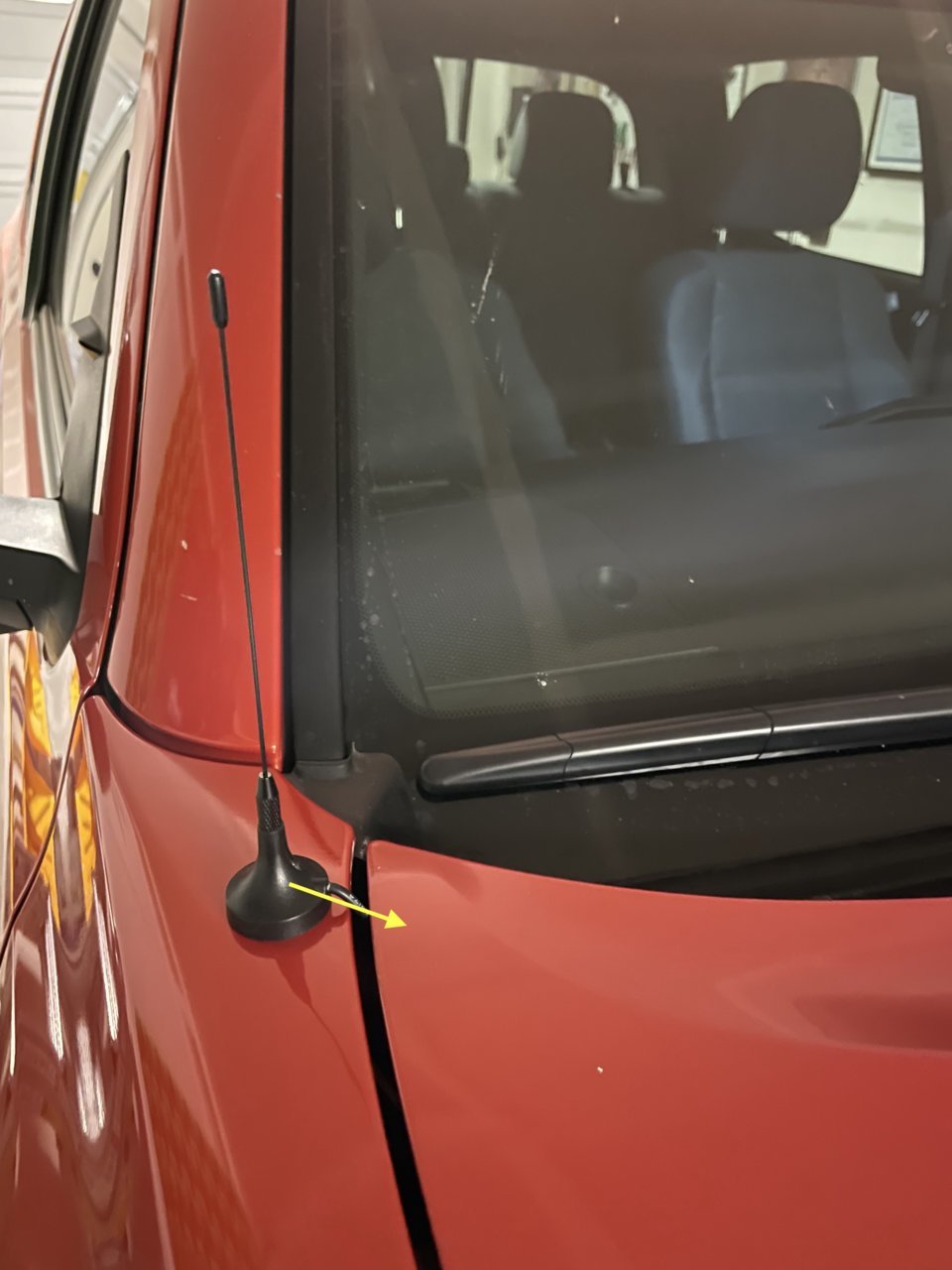

    How would I apply the braided ground strap on this?
    Also, do you think the Midland stealth antenna (3db vs 2.1db) with the NMO wire and ditch light bracket combo from Midland would make a significant difference over the magnetic antenna stuck to a ditch light bracket?
    EDIT: Also, yes, I know the roof is better but I like...put stuff up there...frequently and it covers all of the not curved surfaces, so that's not really a great option.

    Considering how reliant GMRS is on line of sight, I don't see 0.9db affecting anything at all. In general, 3 db is a two fold increase. Don't worry about 0.9.

    Thanks! I got this feedback from Midland on the same question. It sounds like the magnetic is the way to go with my ditch light set up (provided that the LED light driver doesn't cause interference (that's what they said was the issue in the earlier portion of the thread):
    "Thanks for the reply and glad it wasn’t too big an issue. The MXTA25 is generally about the same performance as the MXTA13, but needs to be mounted over a decent sized metal surface (generally at least 12” diameter). Otherwise it may perform worse than the MXTA13."

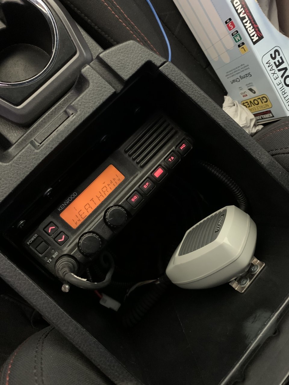

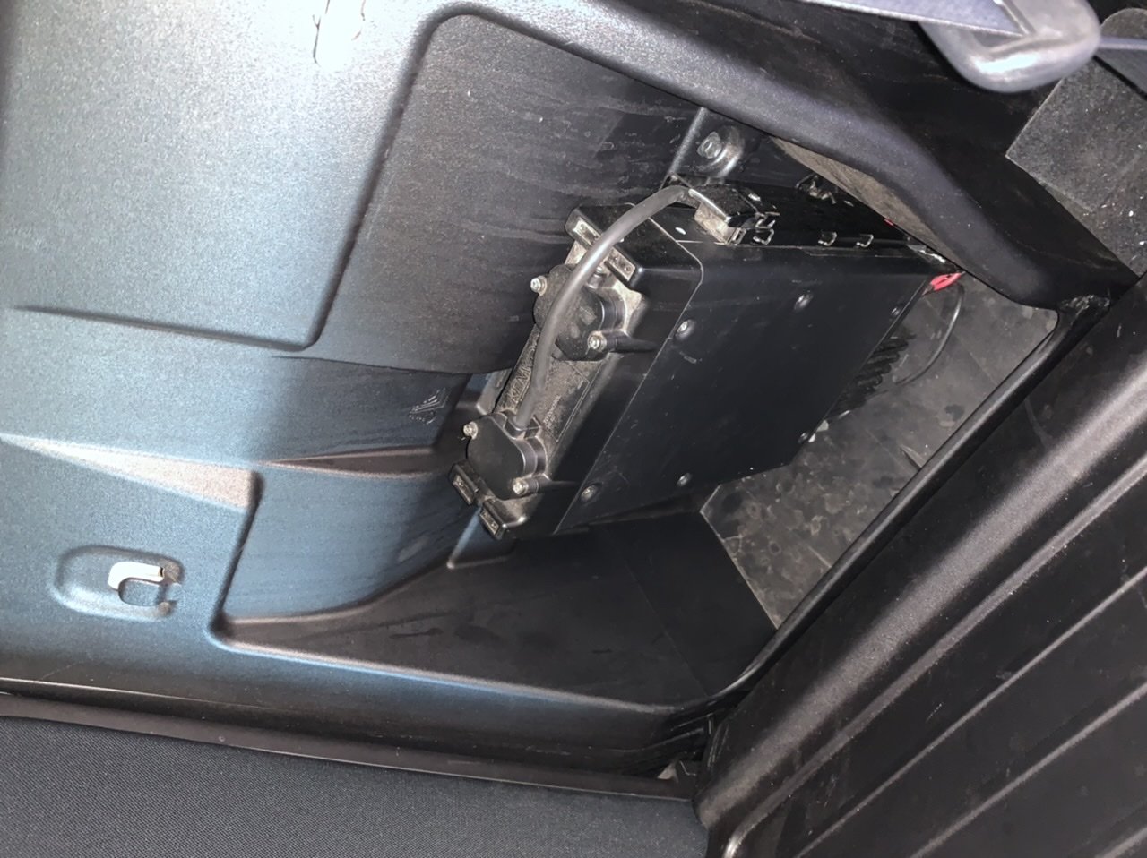

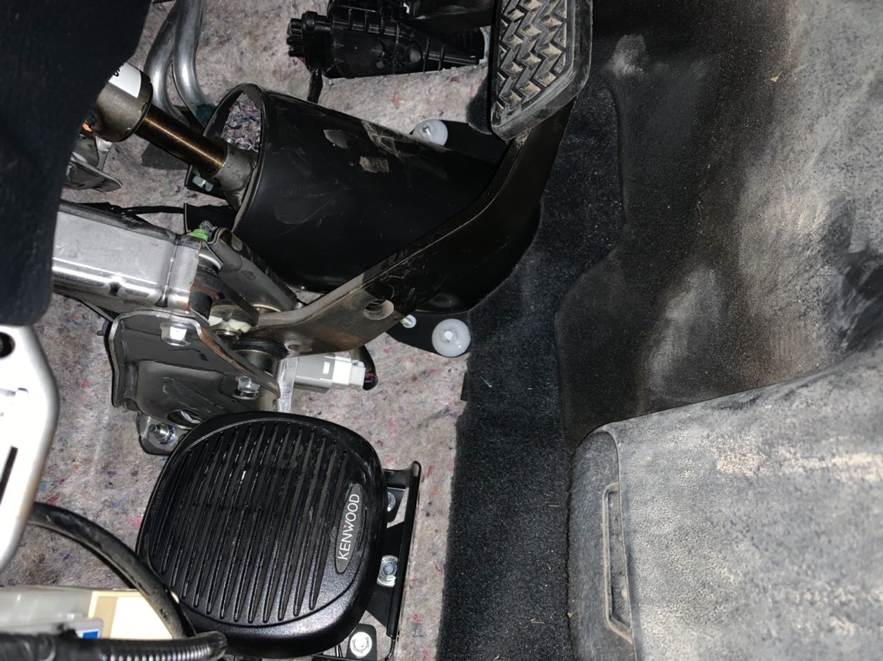

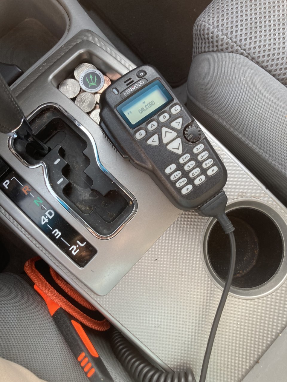

    Kenwood 100W VHF. Deck under seat. Fender NMO.
    SJBrown likes this.
