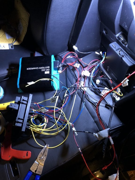

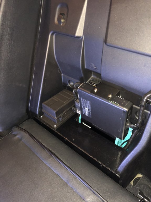

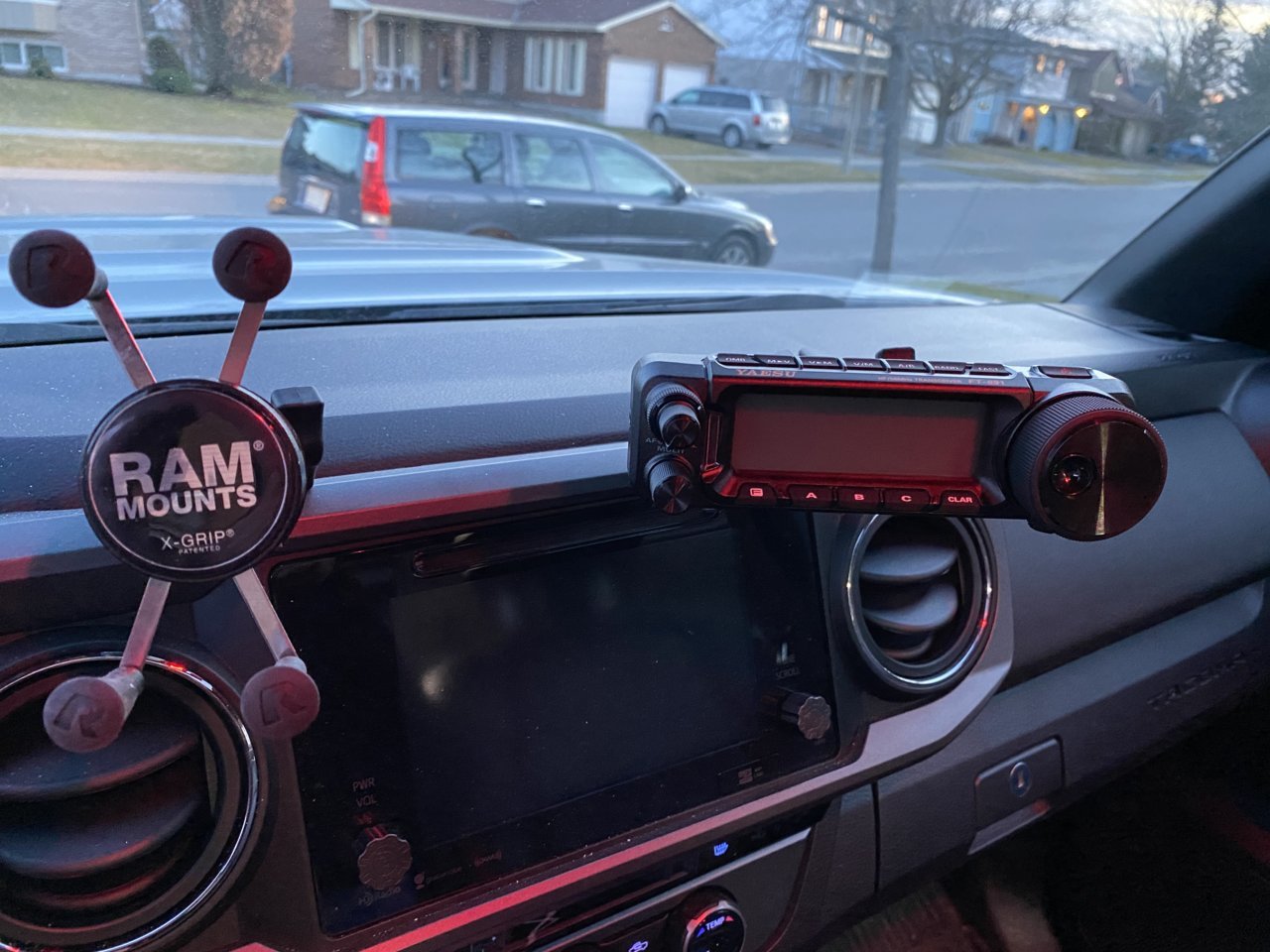

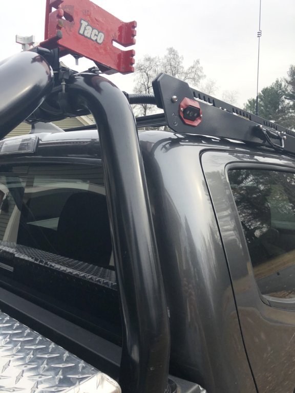

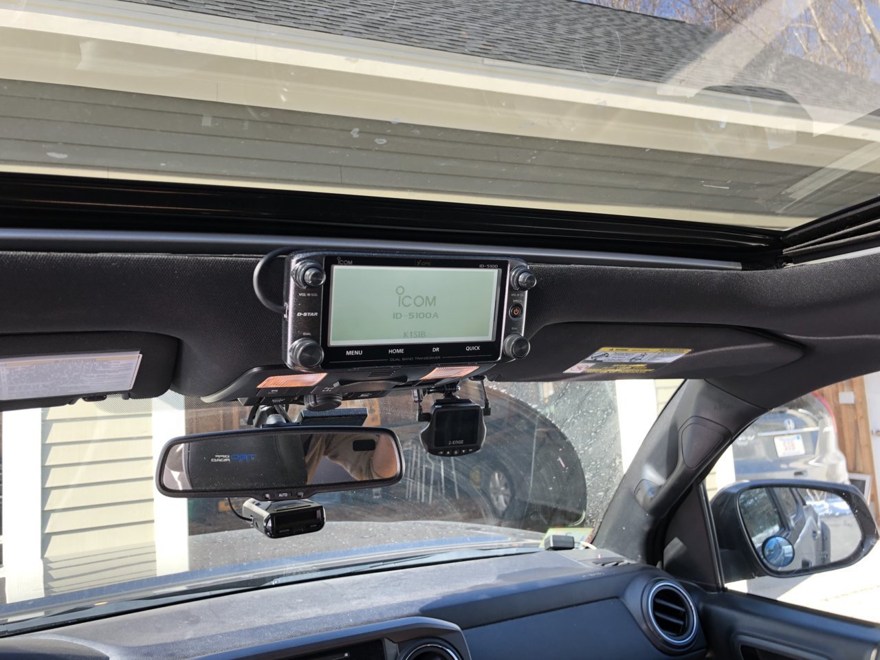

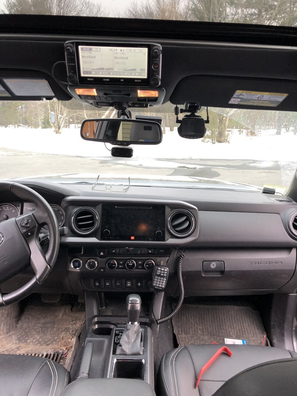

    Been a while since I did this so hopefully you new guys get some ideas on other options:
    Head mount:
    Wiring isolation battery, charger and transceiver behind rear seat:
    Mounts:
    No line of sight blocking and out of the way but accessible:
    Antenna is on power tilt. More info in build thread.
