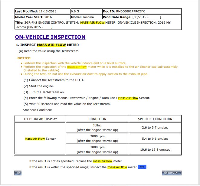

    Actually MAF range is available for Tacoma at idle, 2000 and 3000 RPMs. I have driven 35K on paper filter and 47 on toyota oiled one. MAF readings are the same
    Cleaning MAF is a placebo.

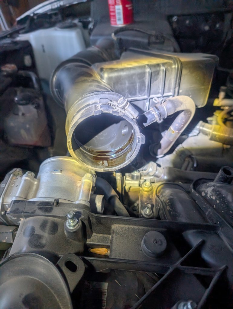

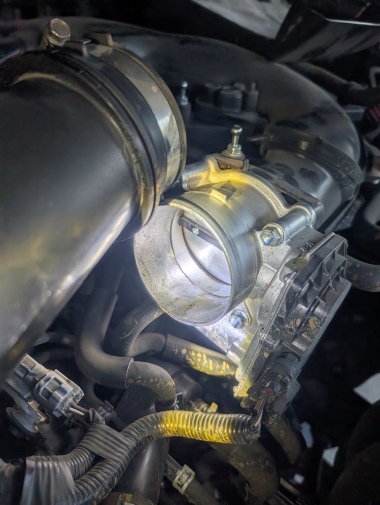

    I just did mine today. Once I got the air hose off I found a smear of sludge in both the hose and in front of the butterfly. The cleaning went fine but is that more gunk that I should have expected?

    Looks fine. You should see Prius's intake.
