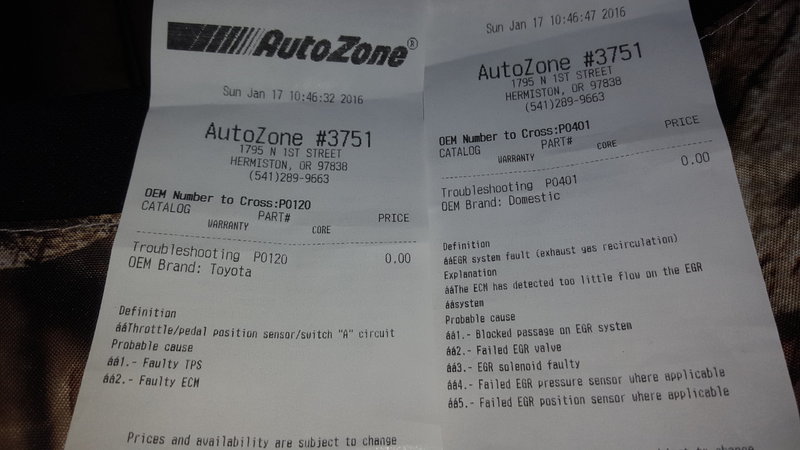

    This what it's saying...I cleaned the EGR with deep creep seafood and unhooked the negative battery cable to. Light was off and truck was running OK and then 20 miles later the light came back on. I've been reading about deleting the EGR...I don't need to pass smog so I don't care, I just want my truck running good and the engine light to come off lol.

    TPS code is very common and is rarely a TPS. Check for vacuum leaks...
