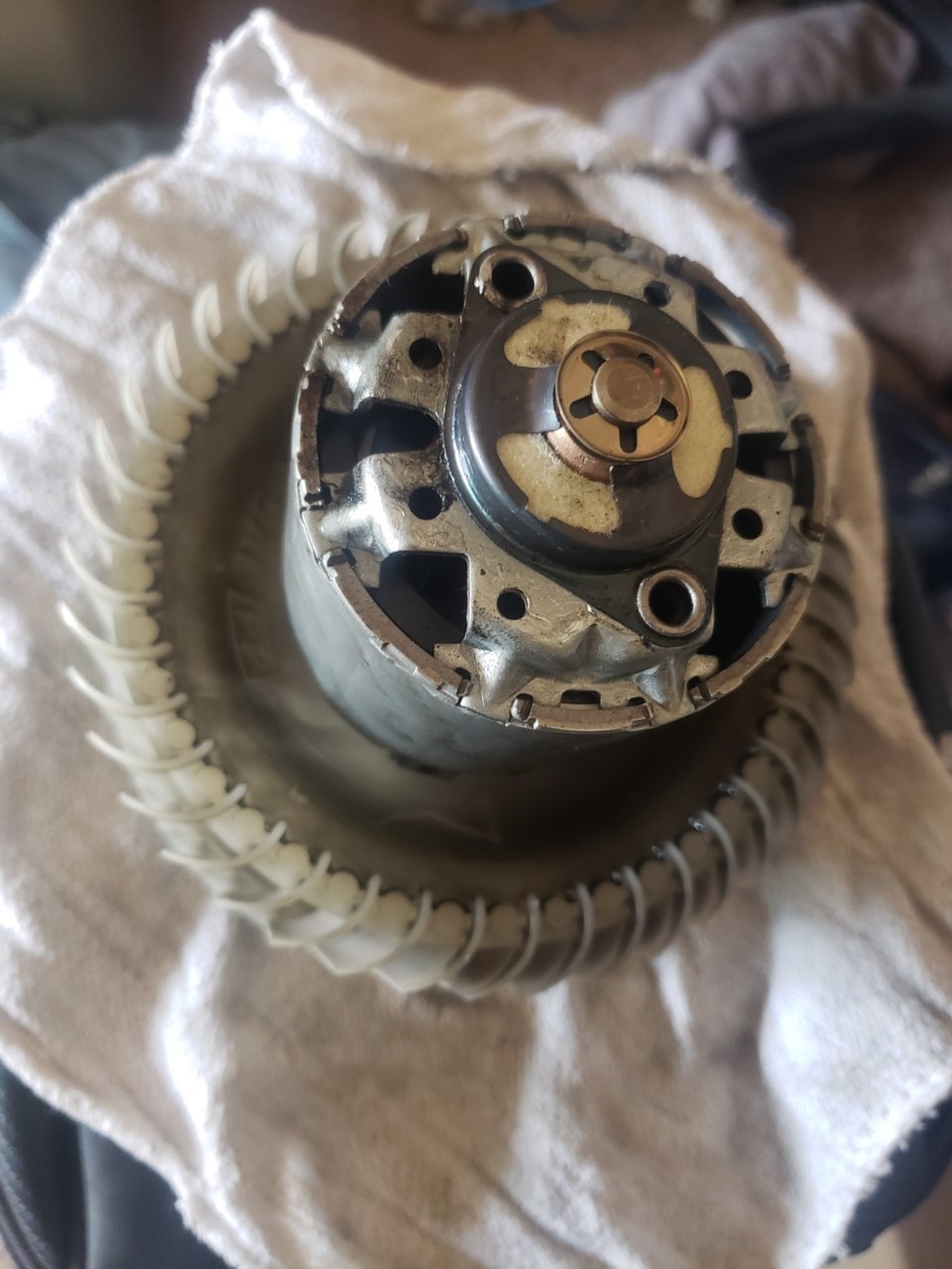

    2002 2.4l 4cyl, blower motor hardly works on low, works ok on high. removed motor and the fan is sluggish so needs cleaning but I can't figure out how to take it apart (a rare thing for me). I ordered a new one anyway but would like to clean this one still.
    thanks for the help.

    The motor comes out in the direction of the squirrel cage .
    After all these years it might be stuck. Silicone spray might help
    While your in there replace the blower motor resistor

    Other than cleaning the cage, there isn't much else you can do. I think a member here managed to take it apart further, but if you already have on on the way, just sit tight.

    You may know already, but that white Felt material, the felt washer is there to hold oil for the bushing/bearing for that motor. That design with the felt washer to hold oil has been done for over 100 years. It looks dry, I'd saturate both if there's another one around the other bearing on the fan side, might have to take the fan off. I use 3 in 1 oil, for electric motors, ..blue can. I'm guessing you don't need a new motor, at least you have an extra.

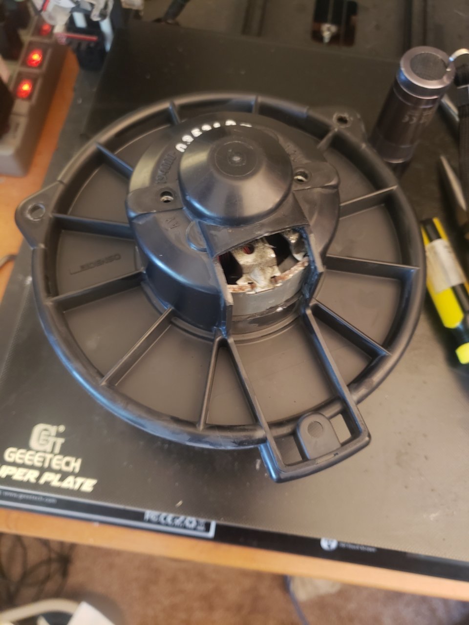

    There's a good chance the other problem
    Is in the switch in the dash and or the wires that go into the switch.
    The contacts in the switch do burn up and the wire plug that goes into the switch also burns up.
    I had to replace the switch and the wires that attaches into the switch as they were burnt and only 2 fan speeds were working

    #335235
    896
    wow, thats fried! i'll see if the new one is noisy, i can always re-oil the old one.

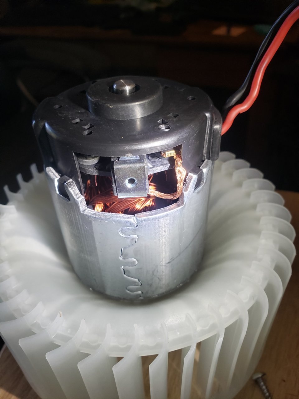

    new blower.. no felt to lubricate that i can see.

    Newer motor !!
    It has been years since I saw bearing able to be lubricated

    should i add a dab of PTFE grease to the top?

    nevermind, the part wont fit, the lip is a tad bit too large and the cage is bigger. returning it.

    That reminds to not throw away my old parts if I have room to keep them. For the sake of curiosity, like a lot of C-frame electric motors, if there's felt to hold oil on that one, it's under that raised area where the shaft is coming out. If that motor was usable, I would've put drops of oil down next to the shaft or would've tried to hit it from the other side with a syringe. I have a computer microscope, I would've tried to use it to see if I could see what's on the other side. My 86 Toyota's blower kinda looks like yours, some things they don't change much.
