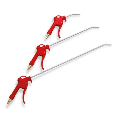

    swiffer duster
    compressor with a blow gun and a long ass nozzel
    vacuum on the side where you are blowing the dust out to, to suck it all up (try a hepa vac if you have one, standard shop vac will probably just throw it all back out if its really fine dust)
    Last time I did it I used my festool vac
    blowgun like the bottom or middle one.
