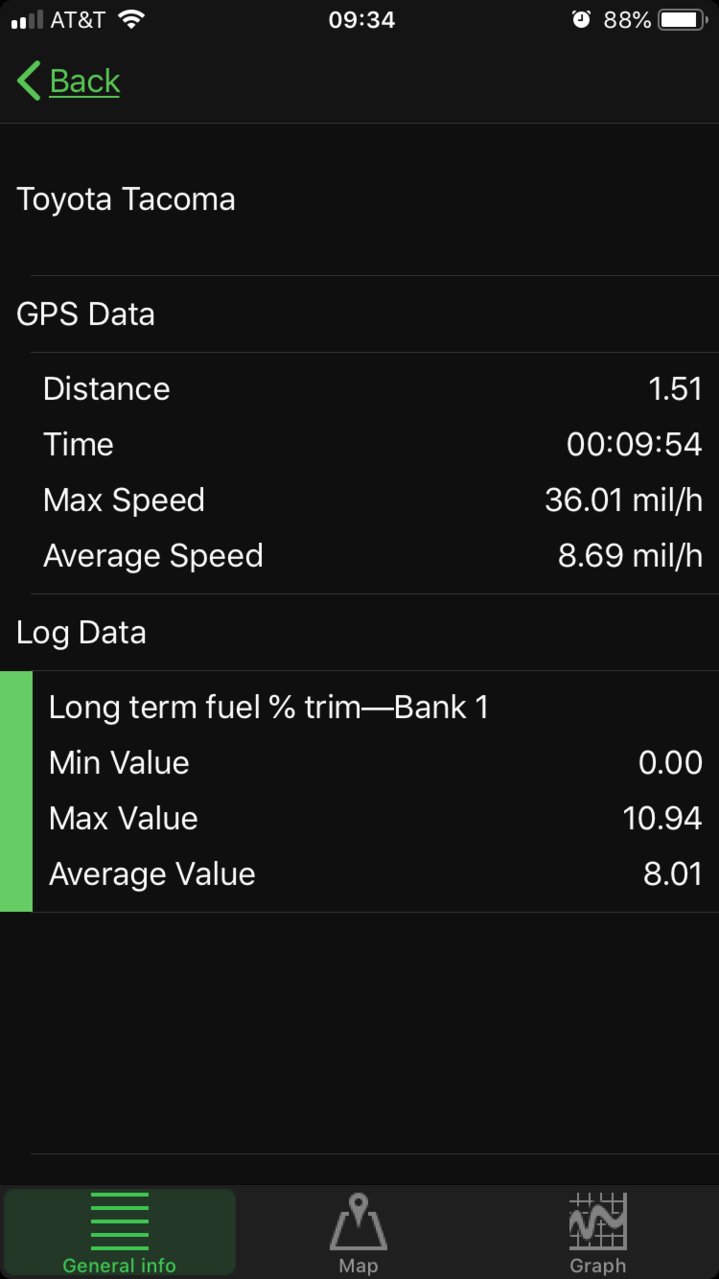

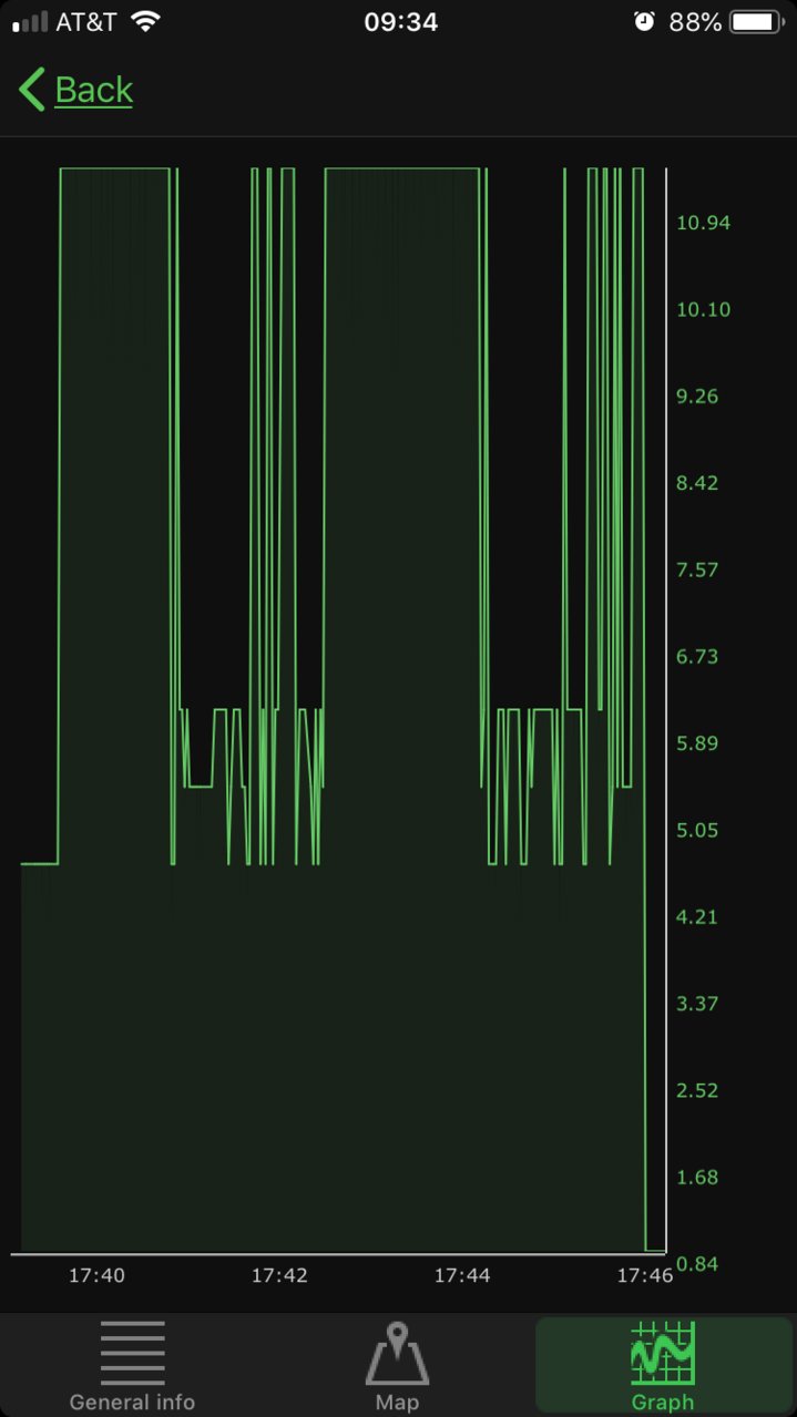

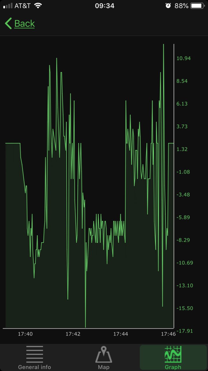

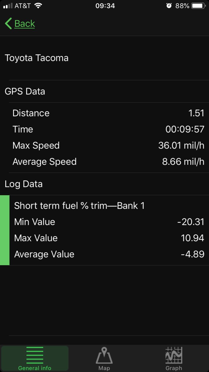

    81
    Tanner
    Anchorage, AK
    02' SR5 Ext Cab 2.7L
    Here are the short and long term fuel bank readouts from a drive I did yesterday. The vehicle was close to cold at start, I think it was 60 degrees when I started it, so about 20 warmer than outside air temp
