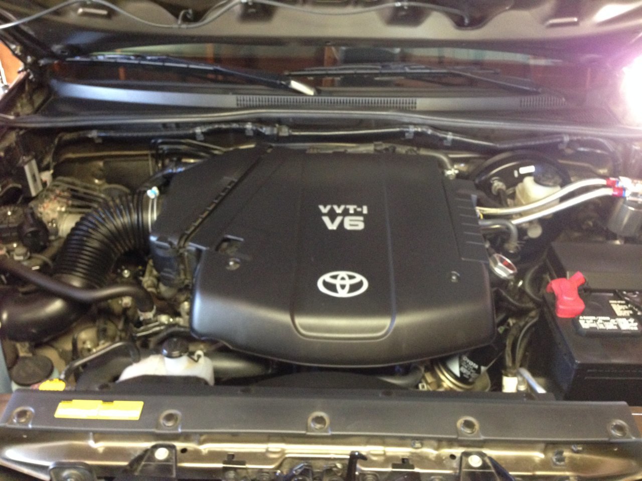

    2008 tacoma - super white
    flatbed and working on more

    it is the post above yours.
