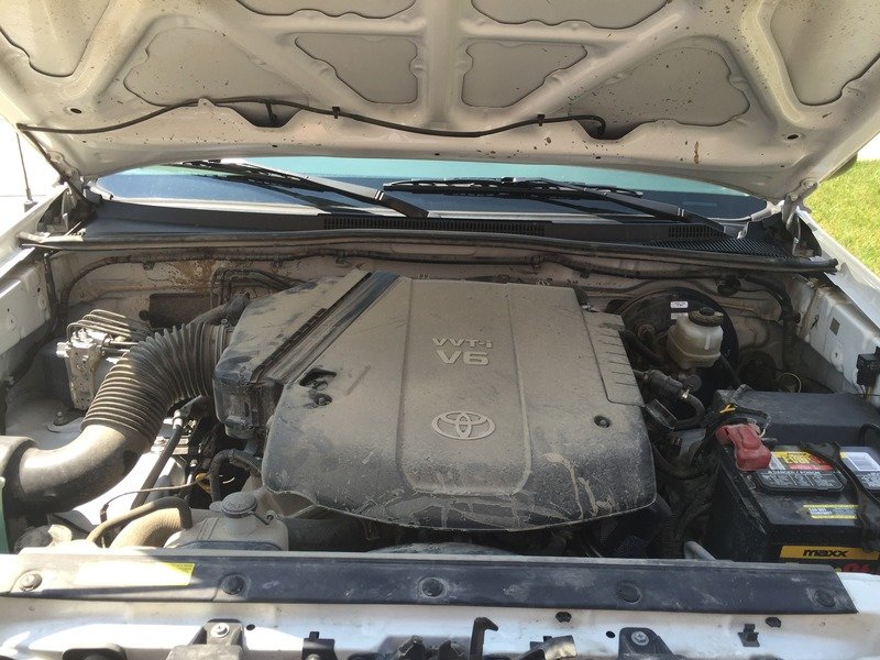

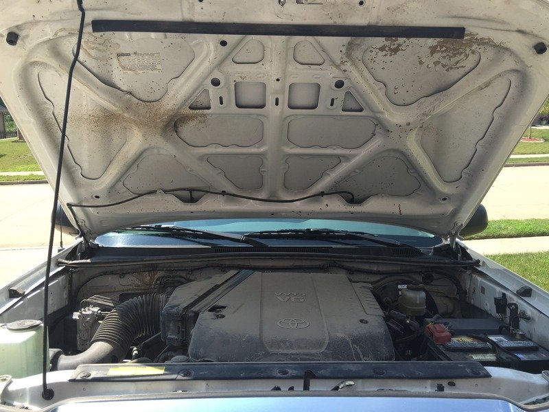

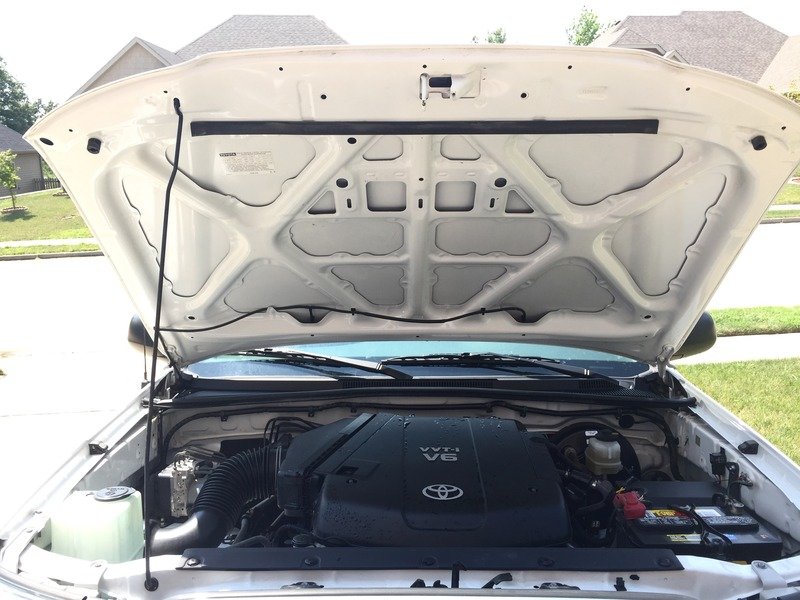

    I just cleaned my engine bay as well. Hit a mud hole on the way to a fishing spot a couple years ago and still had mud spray up under the hood! I really just wanted it to look neat, not spotless, so I didn't even scrub. I used Purple Power ($4/gallon at Walmart) diluted to 1/3 strength with water. Used about 10 oz total, so about 40 cents worth. Pre-rinse/spray with degreaser/rinse.
    Before:
    741B1D1C-56FF-4312-8A63-9A312FB8CD69_zps_5e5c66b43697ce6292ee7c17f7e0d87caf9aa651.jpg
    8D6427AF-B6C6-413E-B135-804AD7D8C634_zps_72ad938a8327c375373f08abadaf2429e744ce07.jpg
    After:
    C6301537-8429-4A83-911C-C1AD71567132_zps_8458266fa1b9d9879817f86c98c5a1e57125d88a.jpg

    Be careful with purple power, it will etch/corrode aluminum.

    Agreed. Chemicals are usually either idiot-proof and therefore too weak to do much harm (or good), or strong enough to require some precautions. Purple Power is a highly basic chemical. Dilute it and rinse well and you shouldn't have problems.
