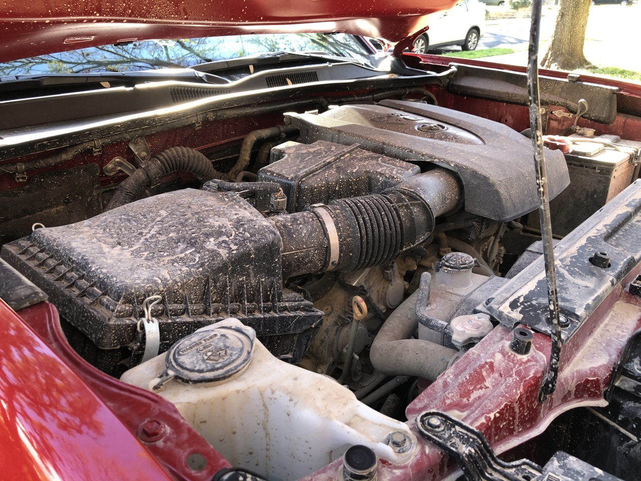

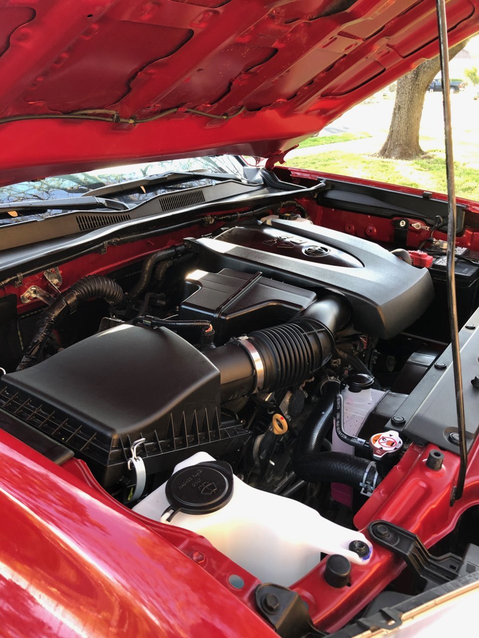

    I second this. This AllClean+ worked wonders! Took my new truck through some serious mud and after about two weeks, decided to clean out the engine bay. Sprayed it down with water then hit it pretty hard with a 5:1 dilution of AllClean+ and water. Worked the crevices with a detailing brush and the larger areas with my tire brush. Rinsed it off and hit it with a leaf blower for about a minute to push most of the water out then dried it with a microfiber towel. Couldn't be any happier with the results. Also, this cleaner works great on tires.

    For anyone still reading this dont spray water on a hot engine. It can cause certain metals to crack due to the temperature change.

    I read through this necrothread as if my engine bay was caked in detrius. It's barely been offroad.
    Stunning work in there!
