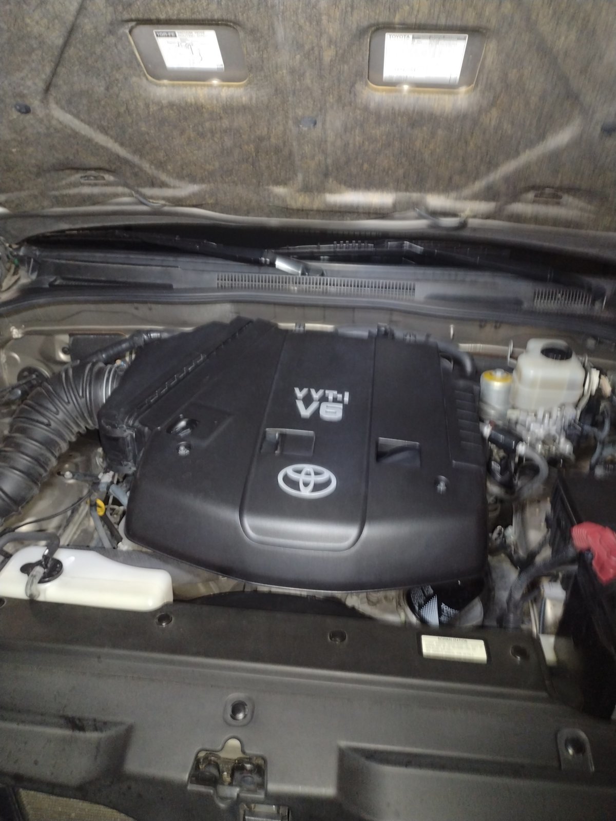

    17106127790782668451469852831427.jpg For years I've successfully cleaned my engines by spraying Simple Green on cold engine and then starting engine and spraying lightly with water hose ( avoiding direct spray on alternator and electrical components ) This is my 08 4Runner
