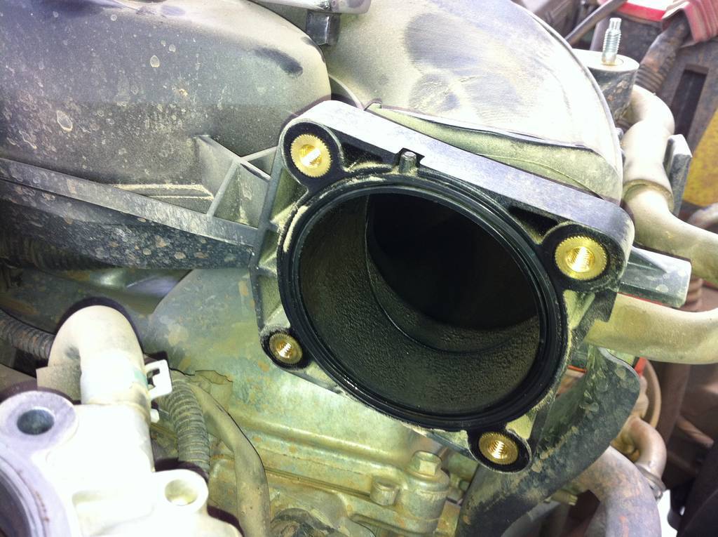

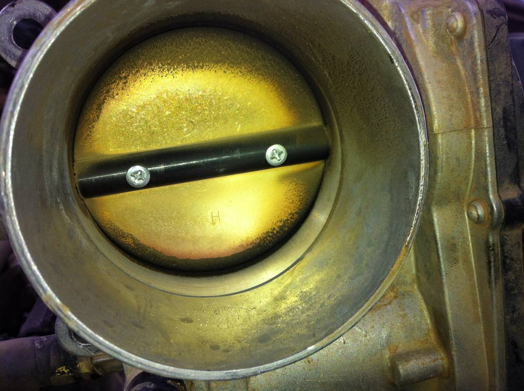

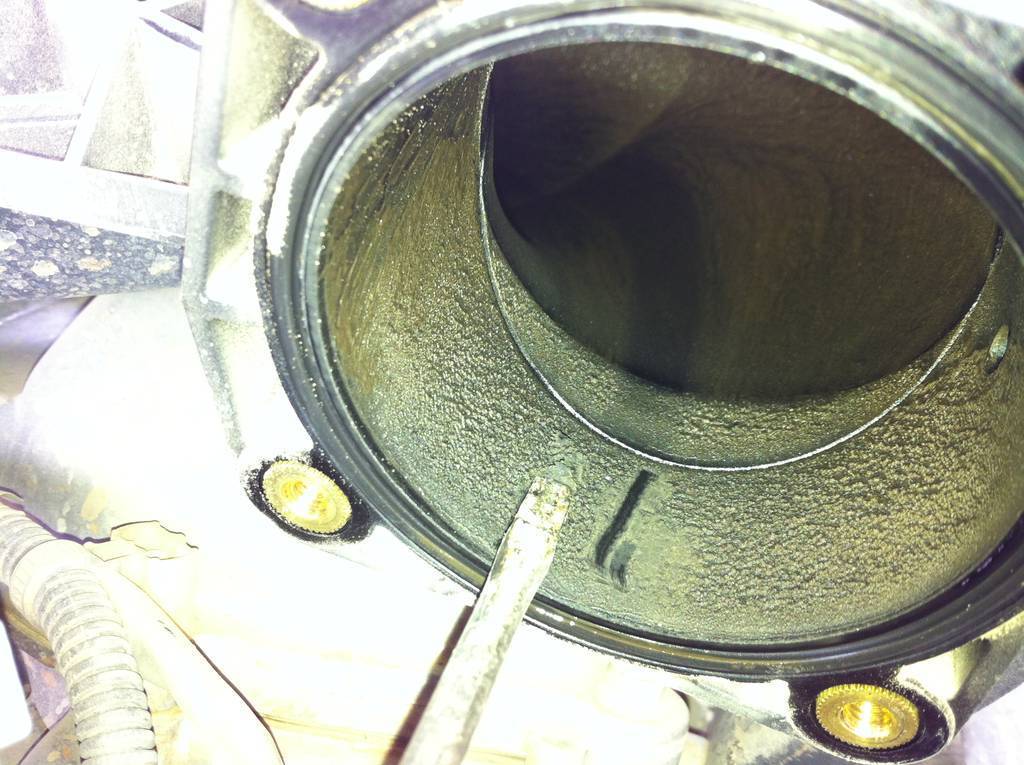

    I took apart my intake to clean the MAF and throttle body today. After removing the throttle body I took a look inside the intake manifold and was amazed at all the gunk inside.
    It is a thick black tar like substance all over the inside of the manifold. I used some throttle body cleaner to clean the gunk off of the throttle body and clean the opening of the intake manifold.
    Here are the pictures. The gunk is black, the camera flash makes it look brown.
    Anyone else notice this? My 4.0L V6 has about 72,000 miles.
    I am considered removing the intake manifold and attempting to clean all of the gunk out of the inside.

    Maybe a combination of pcv valve residue and dust from off-roading?

    never spray alot of gum cutter inside the intake because all that crap will go right through your cats no good. also having some oil residue inside your intake is normal. but your looks like alot of dirt is getting inside id consider a different filter

    It looks like what you would find when you run an over oiled K&N but he's using a dry filter. Time to check the PCV valve and maybe run a catch can to cutdown on the residual build up.

    Every intake I have taken apart has looked like that.

    That's not too bad for the mileage. Clean it out, hook back up, and you should be fine. Chris2x4 probably has some good advice on this. Wherever he may roam.

    This. Filters are not 100%, some shit gets in. After 76k miles, that's pretty normal for the throttle body.
