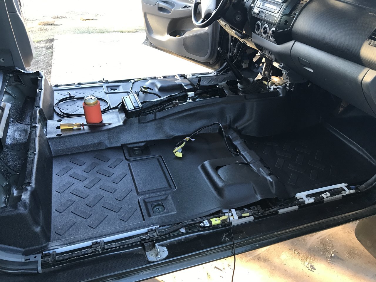

    Pretty cool! I like it. If I ever had to ditch the carpet, I'd probably go with this option as well.

    Good time to lay some sound deadning!

    Great idea but I wonder if that will interfere with fitment of the new pre-formed flooring?

    It shouldn't as the sound deadning materials are not that thick. I remember seeing a thread about this same exact mod already with sound deadning underneath.

    It wouldn't hurt at all. If I was going thru the trouble to take the seats then carpet out, I would absolutely lay down some CLD tiles, closed cell foam, and mass loaded vinyl under the new flooring. It would cost maybe $150 more and make a huge difference in ambient road noise. Reading thru various threads about this flooring I'm actually shocked no one did sound deadening too, that seems crazy to me to skip that step
