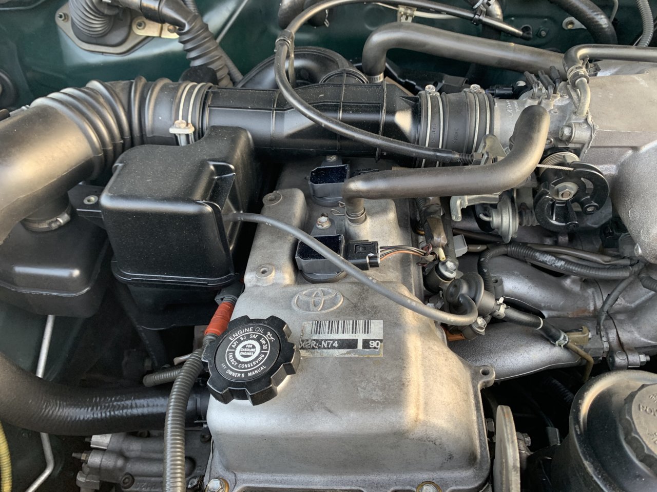

    This is the most recent picture its pretty clean but i just wanted to maintain it the way it is. Ill try some simple green thank you

    So just i just spray the motor with it or spray it on a rag and do a wipe down?

    Yeah, I spray it down with water, spray some blue dawn mixed with water on and then I spray it off real good. I just cleaned it up when I changed the spark plugs.

    sounds great it wont affect the wiring and such correct?

    Na, I like to spray it down when the motor is cool. Just don't blast it right on the electronic connections. It probably cleans a little better with the motor warm but I just don't like spraying cold water on a hot motor.

    I like to use a pump sprayer and let it work in. Then I pressure wash the grime off. Follow up with some compressed air to clear excess water.
