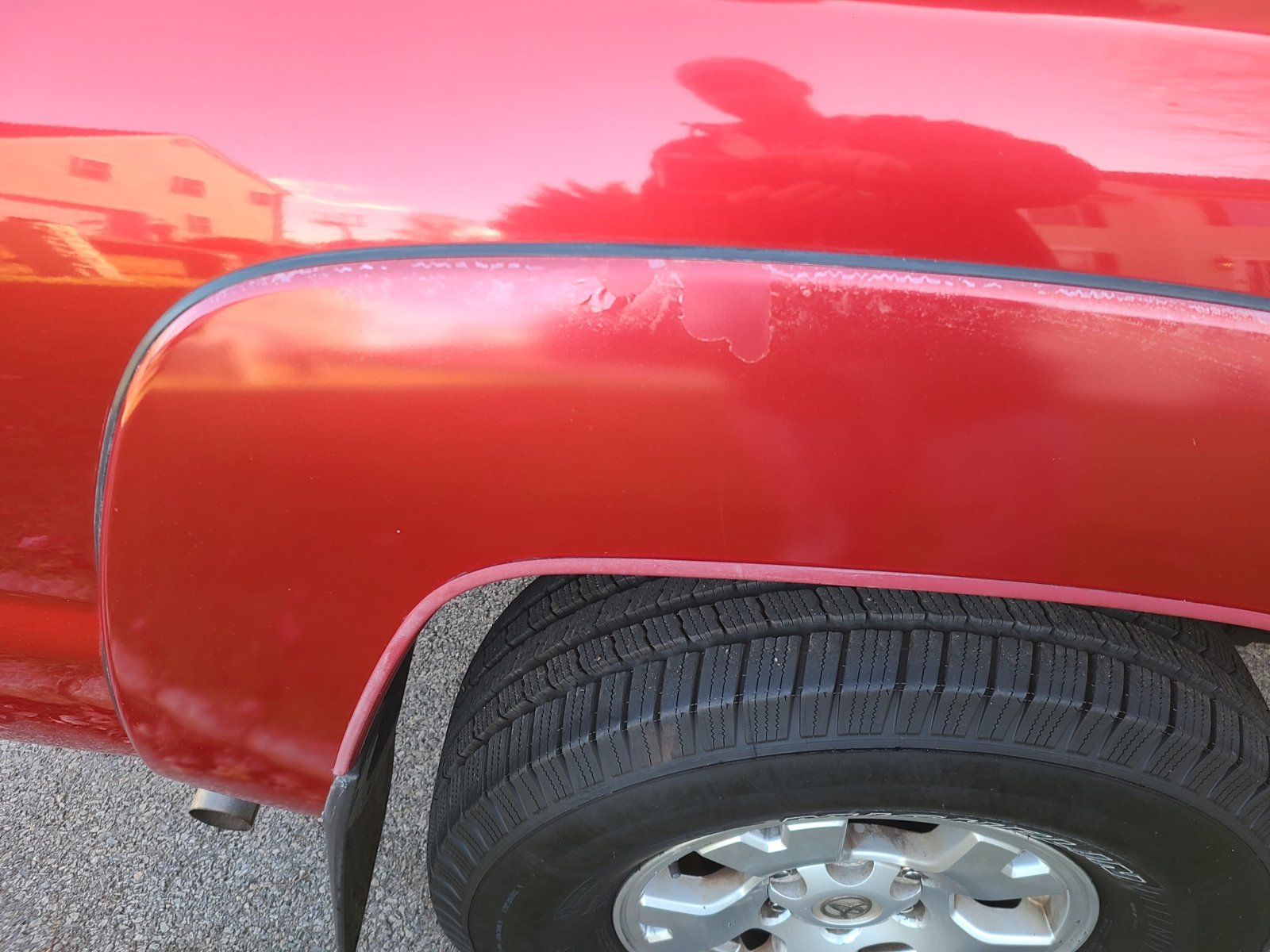

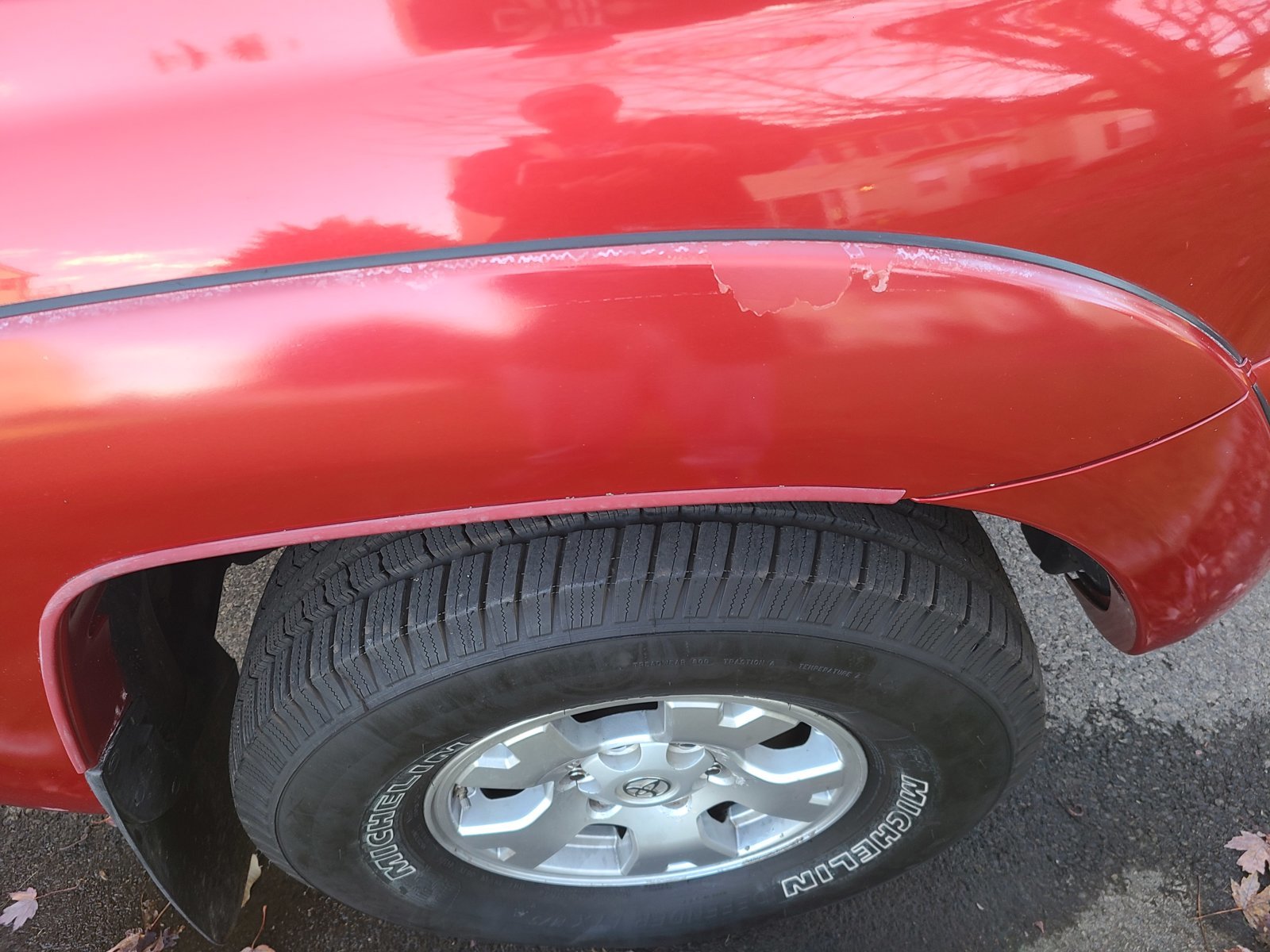

    Hey all, so the clead coat failed on the wheel trim on the passenger side.. any suggestions on managing it? Not looking for miracles, just to protect what I am able. Thanks!20231118_100037.jpg 20231118_100031.jpg

    I'd just pull the flare, lightly sand the clear coat off and then respray a new clear coat.

    As has already been stated, the only true fix is to remove all of the failed clearcoat and apply a new clearcoat layer. To do this correctly, you really need to go to a paint / body / collision shop. There are just too many variables to get wrong at home - especially if you have no experience in working with paint.

    Once the clear coat has failed like that there's no such thing as just putting on new clear coat. Has to be sanded, painted, and clear coated. That is unless you want it looking all ghetto like.

    A local automotive paint shop can mix you up a spray bomb of the paint for your truck and then coat it with a spray 2K clearcoat. It won't match perfectly as the factory paint is 13 years old by now, but it'll look better than what you have.

    Clear coat failure is typical for Tacos 10 or more years old. Once it starts there’s no stopping further peeling. It just gets uglier and uglier. You can try different things but it'll just look like shit. The ultimate solution - take it to a shop for full paint job.

    If your flares are peeling, check the roof. Careful where clear coat has failed, the color paint is exposed and will wear off.
    Looks like ass, just keep a coat of wax on it and don't look at it.

    Once it starts wax isn’t going to stop it. Most often the clear coat starts on the roof and hood. UV’s are the primary cause of both oxidation and peeling clear coat. Wax products will protect and preserve the paint and clear coat and delay oxidation/peeling but after 10 years or so it’s much less effective. In your case it’s doubtful the wax will do much of anything. The UV’s are relentless.
    I had my 2009 painted about 4 years ago. Looks fantastic, looks like new. I get compliments on it all the time. If you plan to keep your truck for awhile get it painted. If not do what you can but you are fighting a losing battle.
