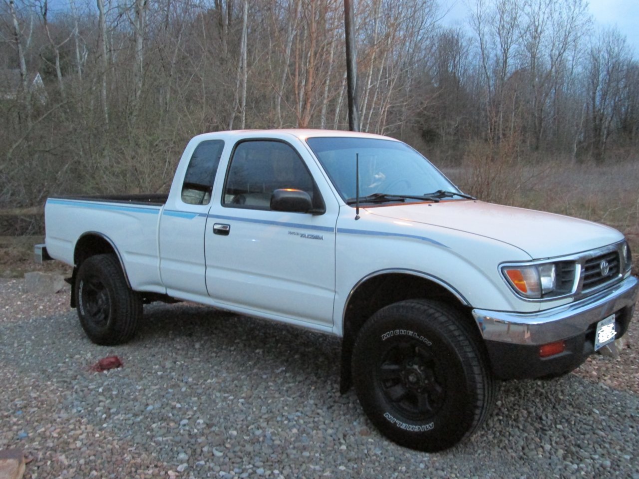

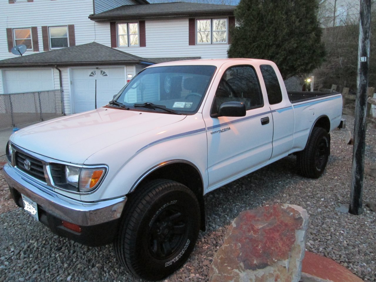

    Just my hood has the clear peeling in spots. If I painted it white, it would never match. Thinking about flat/matte black maybe?
