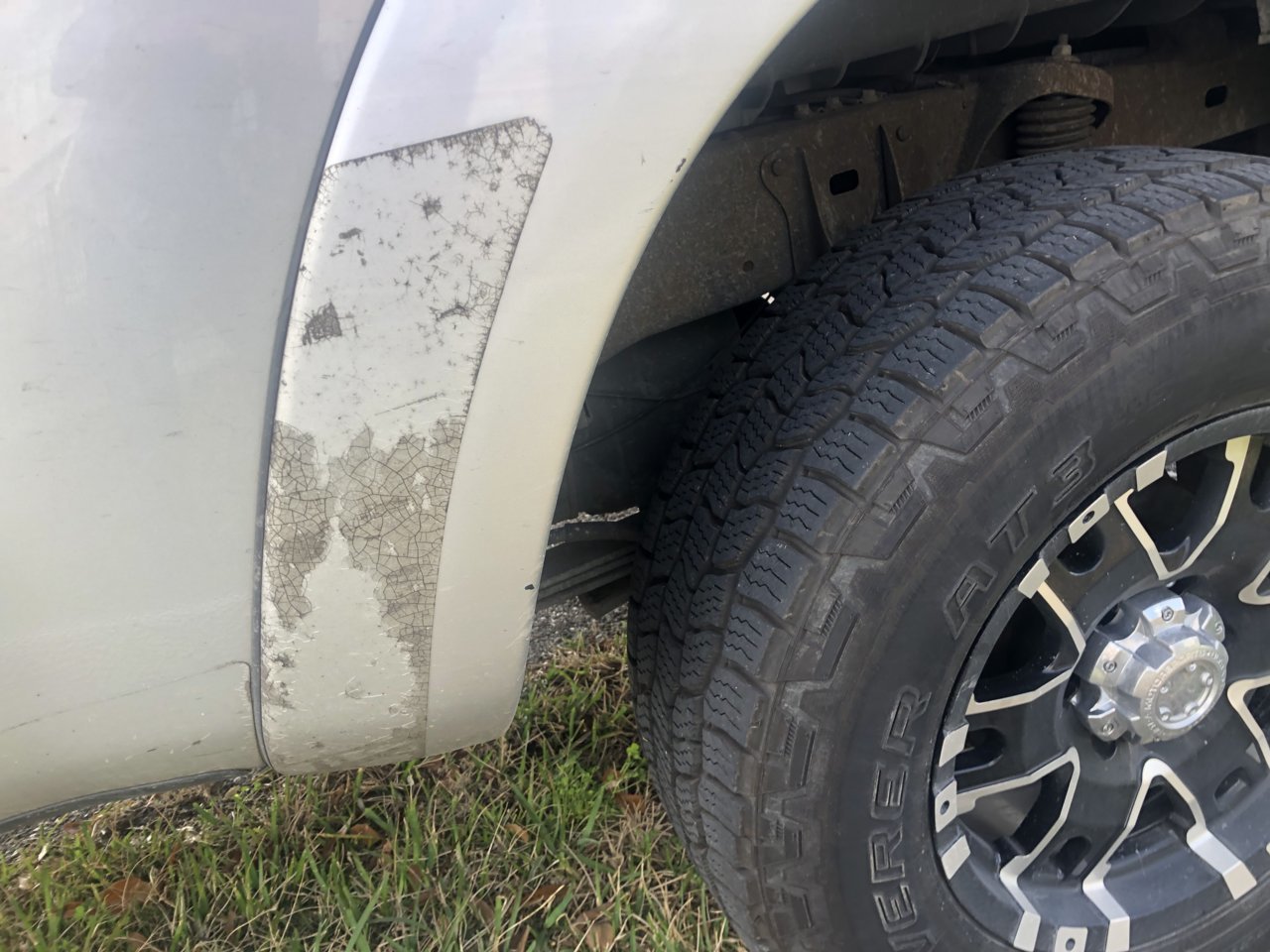

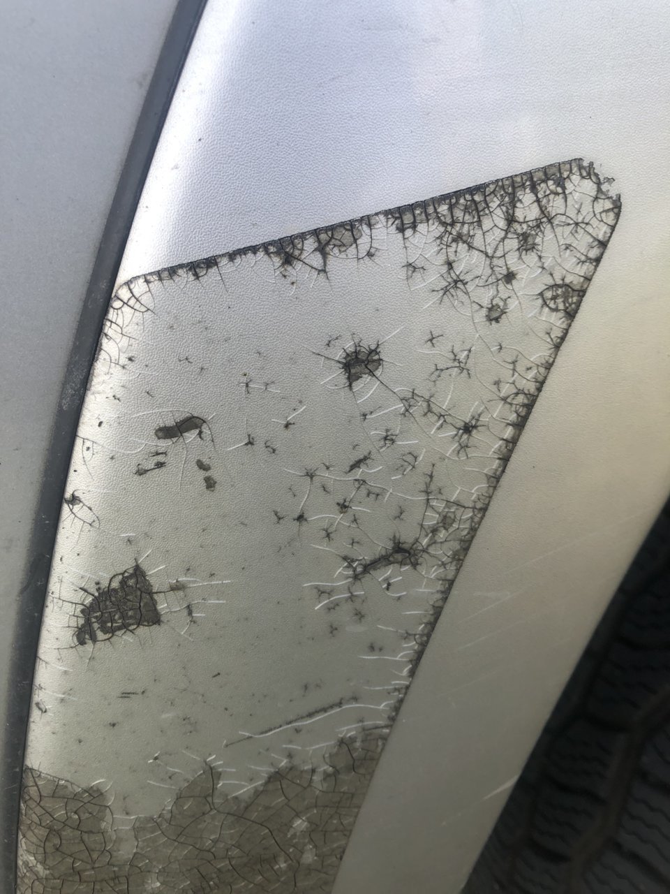

    These clear rock guard decals have gotten awful over the years, and I see the same thing on other Tacoma's of the same age as mine. A body shop nearby says he has had bad luck with them and when they are fragmented like mine (looks like a broken egg shell), there is no way to effectively get them off, and I would be in for a lot of frustration. He suggested I find a vinyl shop and have them wrap over them.
    Has anyone found an effective way to either remove them or resolve the fouled look?

    Those are beyond resurrecting. Steamer and adhesive remover with plastic razer blades. Lots of elbow grease.

    heat gun and a plastic scraper...
    look into Xpel protection film... covered my headlights/foglights with it 14 years ago and it still looks new.

    OK get a heat gun put it on low setting or get the wife’s hair dryer and put it on high setting get yourself a plastic razor and go to town it took me 20 minutes to takeoff those

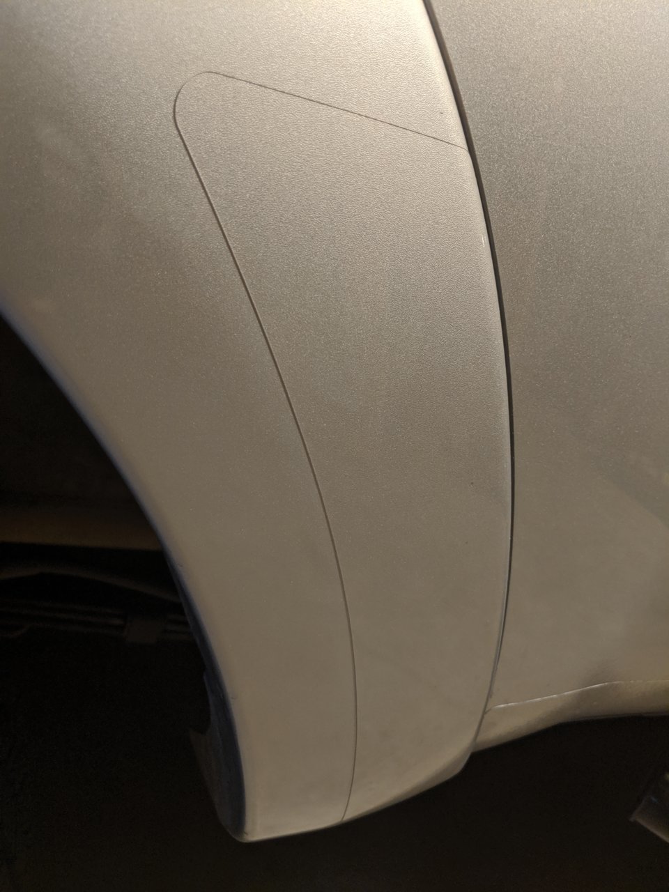

    Thanks for this, glad to see someone who has done it right. From what my body shop guys said it sounded like an impossible task.
    Great to hear, thank you.
    Actually I already bought one of those to do this task, I just didn't want to get halfway in and find out it was impossible, the way it was all fragmented. I will use a plastic puddy knife like Geeves77 said and this as well. I do have a heat gun. Well I have a small torch, and also a steamer. both maybe just as good. Have you tried this Wonder Wheel on something like this?

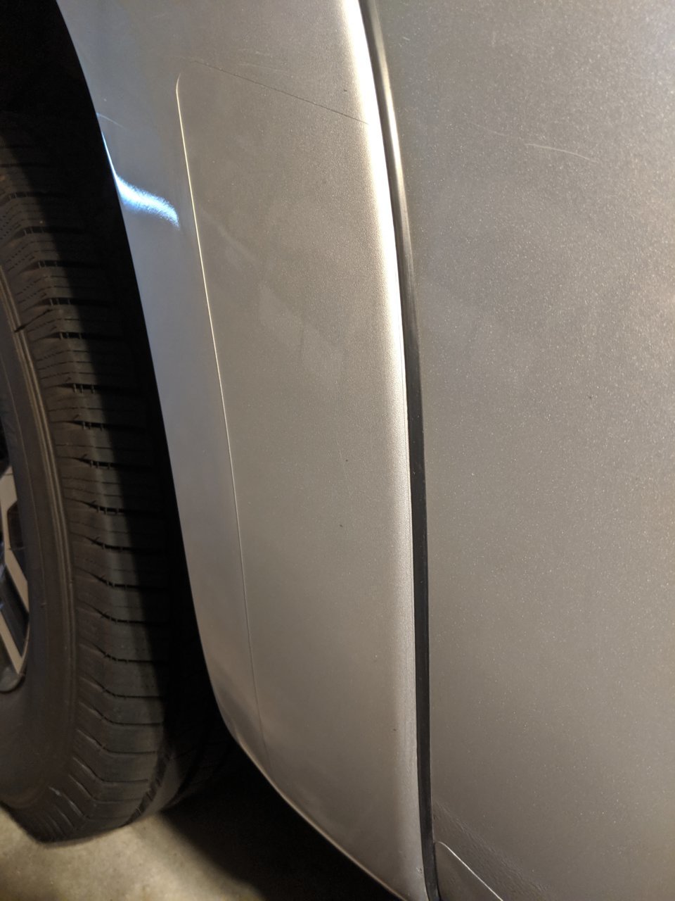

    Applying it is simular to putting on window tint or a good size decal. I use water with small, small amount of baby shampoo and a squeegee. If it was me, I'd stay away from using the small torch. The steamer would be much (safer) better. I use a hair dryer that is left over from the late '70's. I throw nothing away...
    Follow up with the end results.
