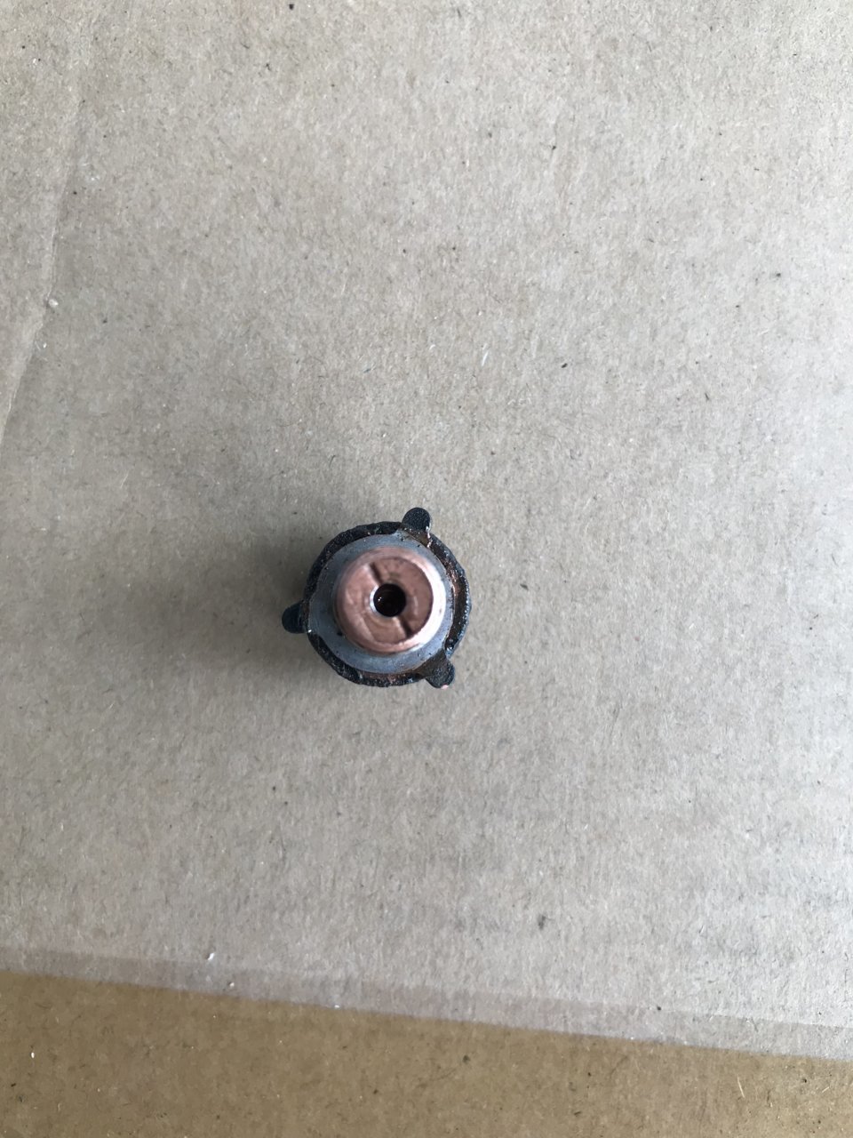

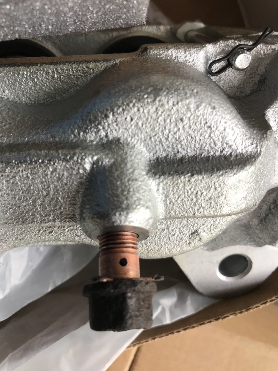

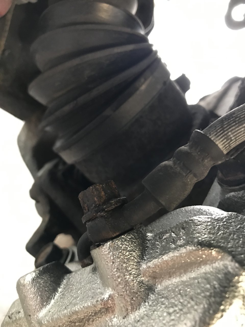

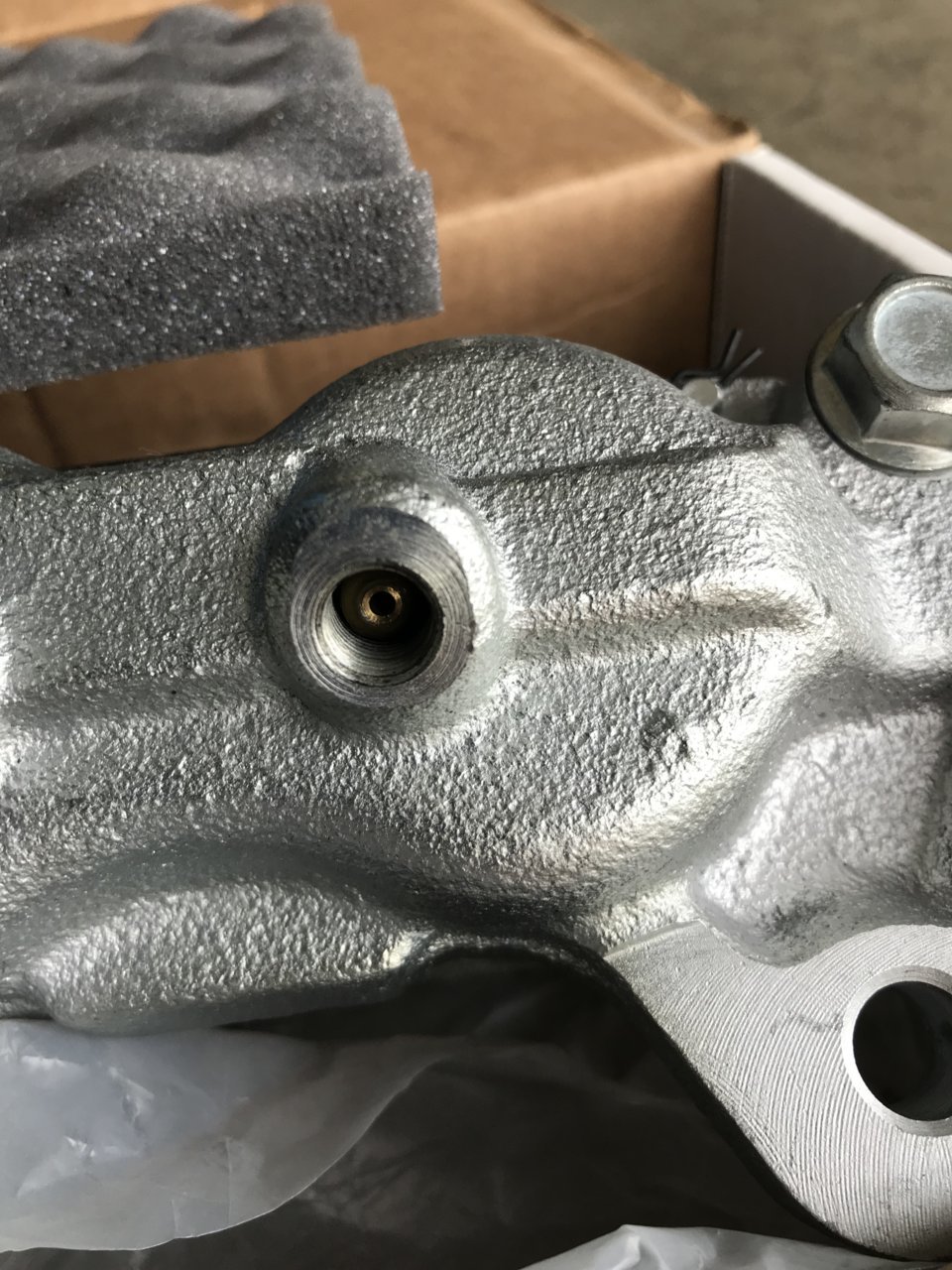

    F099C149-563D-4899-B55D-3F821E59BDDE.jpg 023A7DE9-EA44-414D-A707-F151F8A90719.jpg 34C98322-D98B-4C9A-8000-F3AA0C98D95D.jpg For all the banjo bolt talk I haven’t seen any pics to actually visualize what the issue is.
    Pic 1 shows the caliper where the banjo bolt screws into. In there is a nipple that has to seat over the end of the bolt.
    Pic 2 shows the end of the banjo bolt. The hole from the Tacoma banjo bolt is too small to fit over the Tundra fitting.
    Pic 3 shows why the end of the bolt has to be drilled out. It will not seat all the way to the bottom threads.
    I hope this is clear

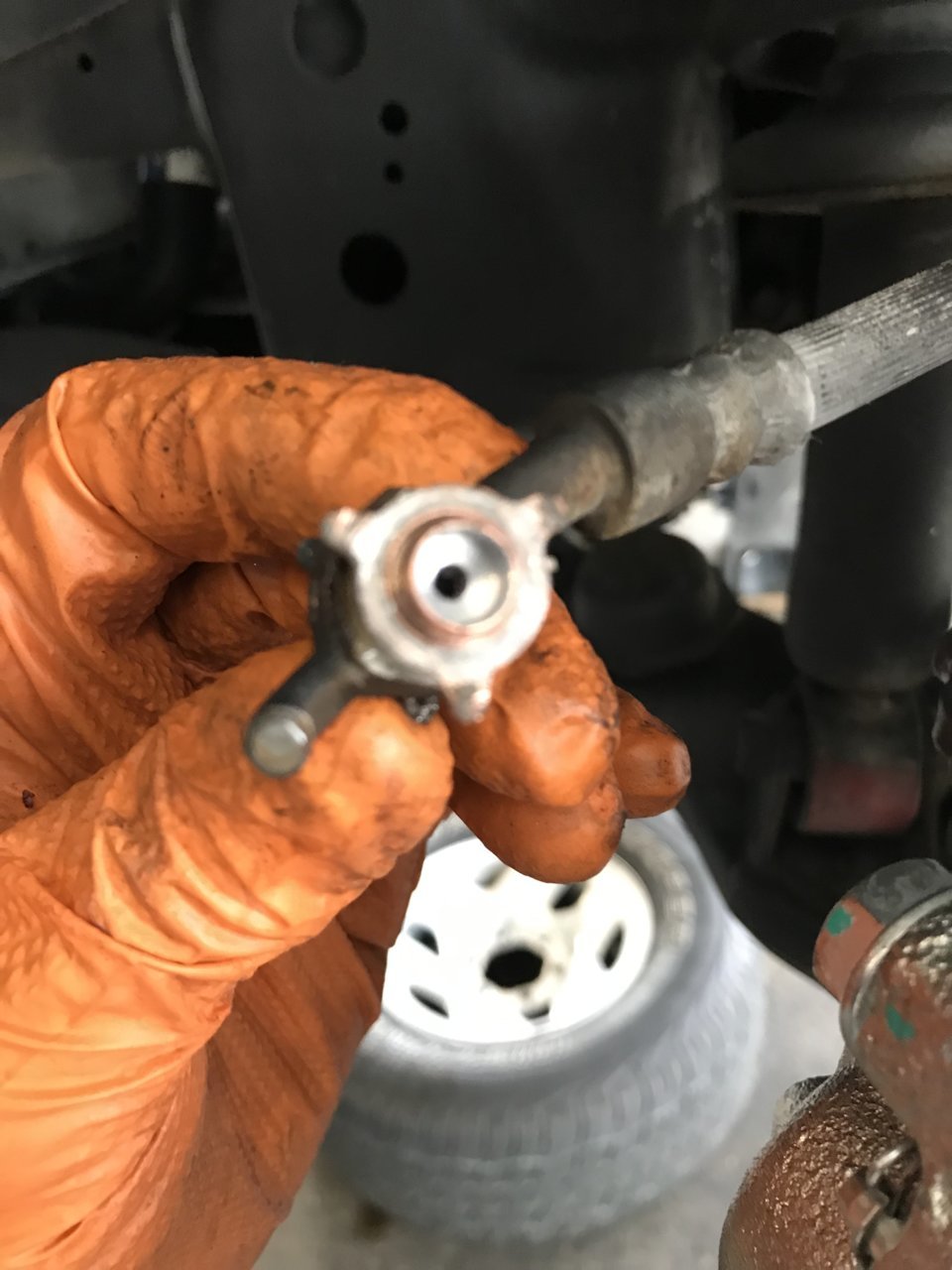

    CFA96D6C-0800-4A9F-A077-D2B2D4D711F0.jpg AD1CF7F2-6AB7-4A8C-9BA3-FF303ED29EB1.jpg Now the bolt has been drilled and seats correctly

    holy shit, what size drill bit did you use? That's a pretty giant hole you made. I think I used 1/4" bit.

    I just asked him. He said 1/4, but I see what u mean. I’m gonna ask for some clarification
