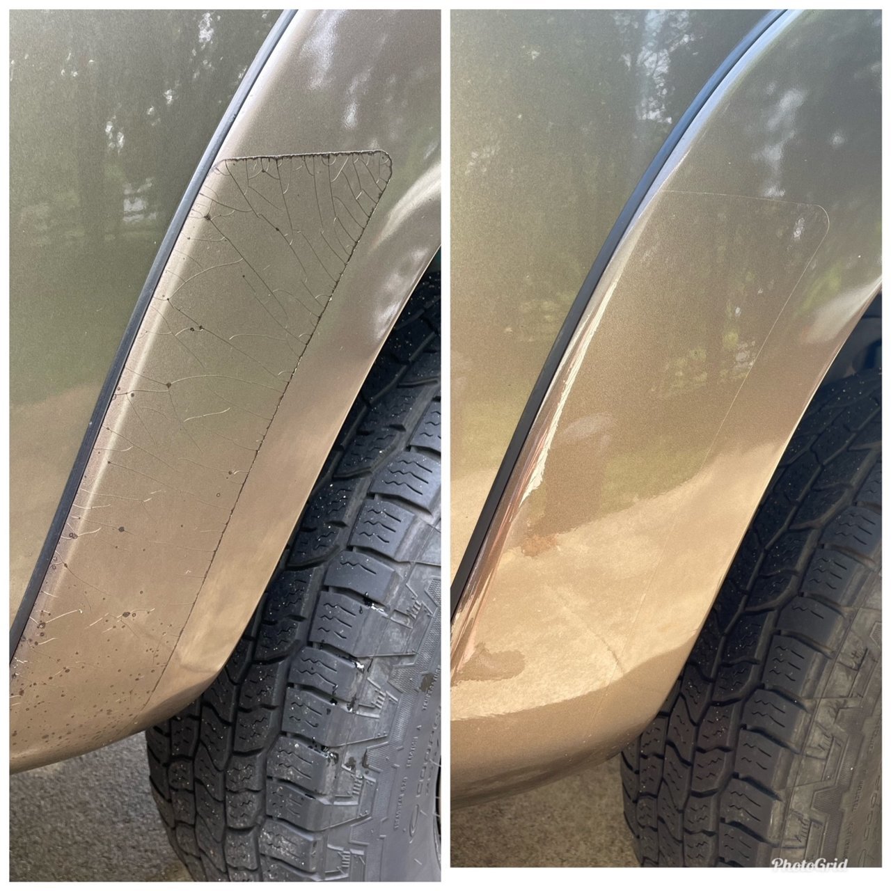

    Finally (after almost two years!) got around to doing this. So pleased - it made a huge difference!

    Any tips or tricks to do this project? Going to try and do mine next weekend.

    I used a heat gun, which made the vinyl easy to remove with a plastic putty knife, but left a thick layer of adhesive. To clean the adhesive off I used 3M General Purpose Adhesive Cleaner 8987 that I applied and scraped several times with the plastic putty knife. There was still adhesive residue, so I rubbed and rubbed with Meguiar's Ultimate Compound until all the residue was removed. To apply the new vinyl, I used painter's tape to mark the top as a point of reference then sprayed a fine mist on the the flare and on the vinyl adhesive side with RapidTac (Amazon), put in place, removed the "blue" backing, re-misted, then squeegeed in place. The RapidTac allowed me to remove and replace to get the placement correct. Be careful touching the adhesive side of the vinyl as I did get some slight fingerprints on one corner. Honestly, I probably will re-do the passenger side side - it was the first side I did and I have a fingerprint and the placement isn't perfect.
