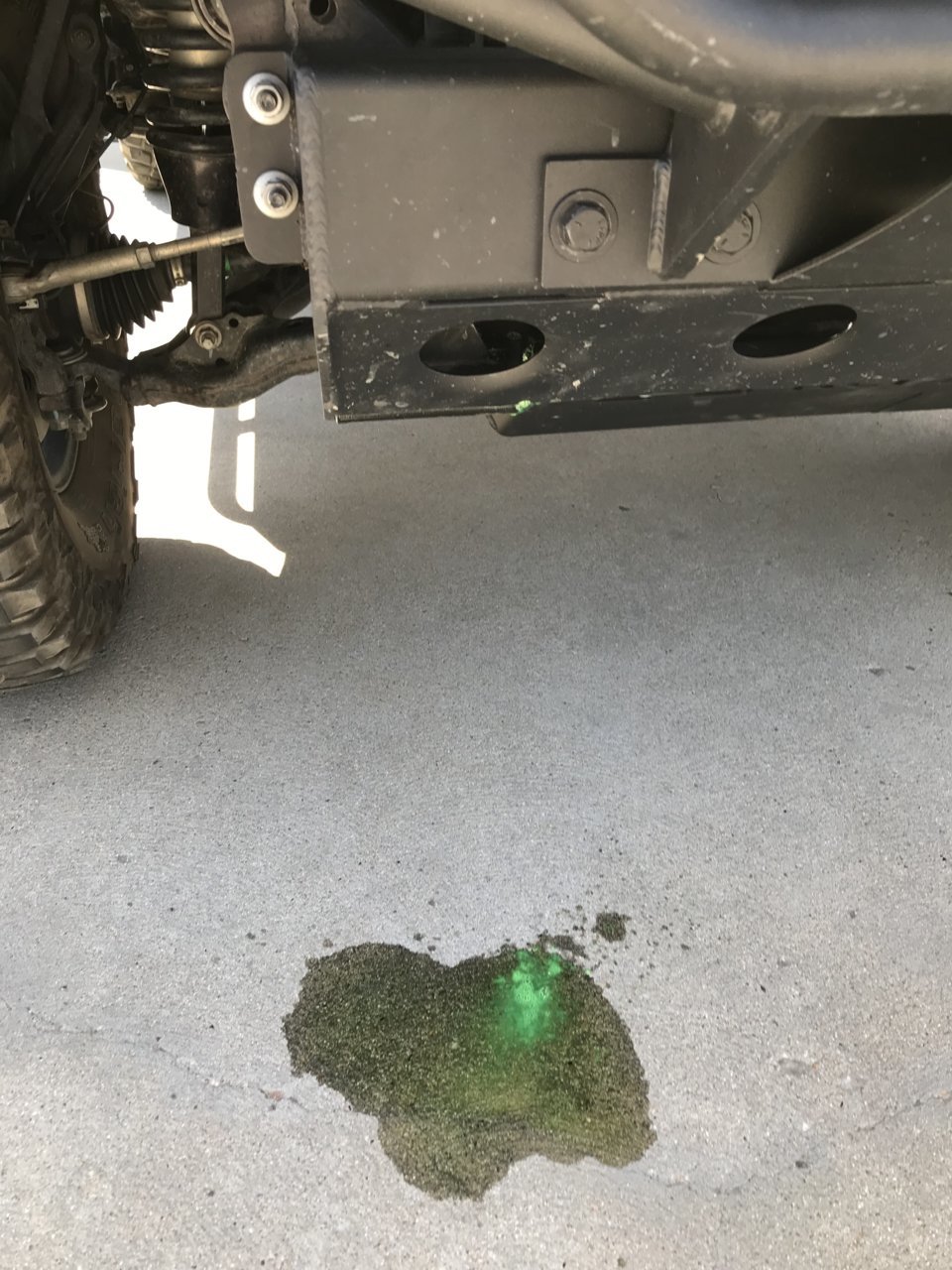

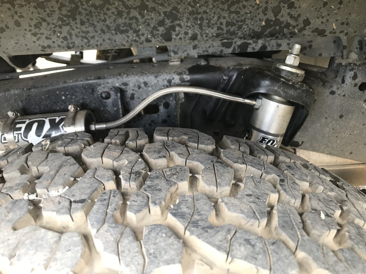

    If you need a 1/2” of clearance, clearance an 1”. Once again I learn my lesson. First pic is the high pressure ac line behind the bumper that I thought I removed enough material for. Second pic was from last year when I didn’t clearance enough from the shock mount. Any how thought I’d share so some one can hopefully avoid these mistakes.4FEFC2EC-4206-4EDD-9266-6FB60C5C70CF.jpg0C831027-8A03-4BAC-8B21-72EBD6CD6A6B.jpg
