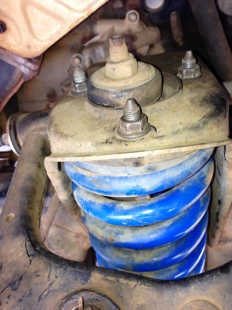

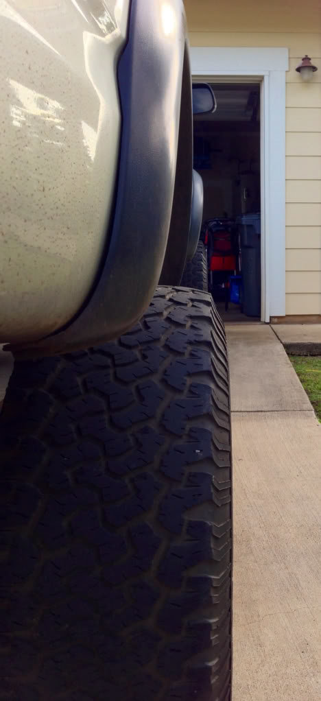

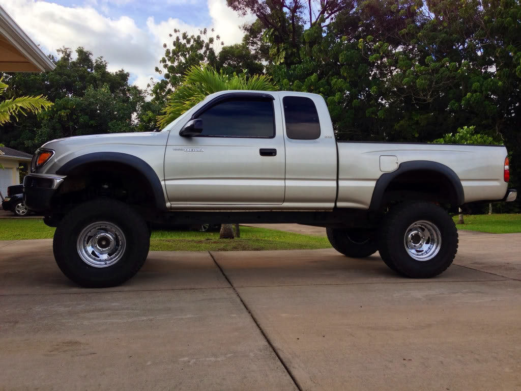

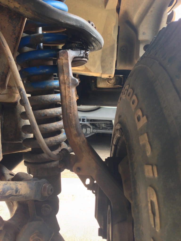

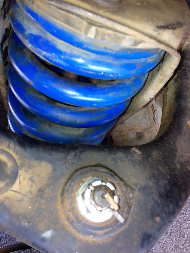

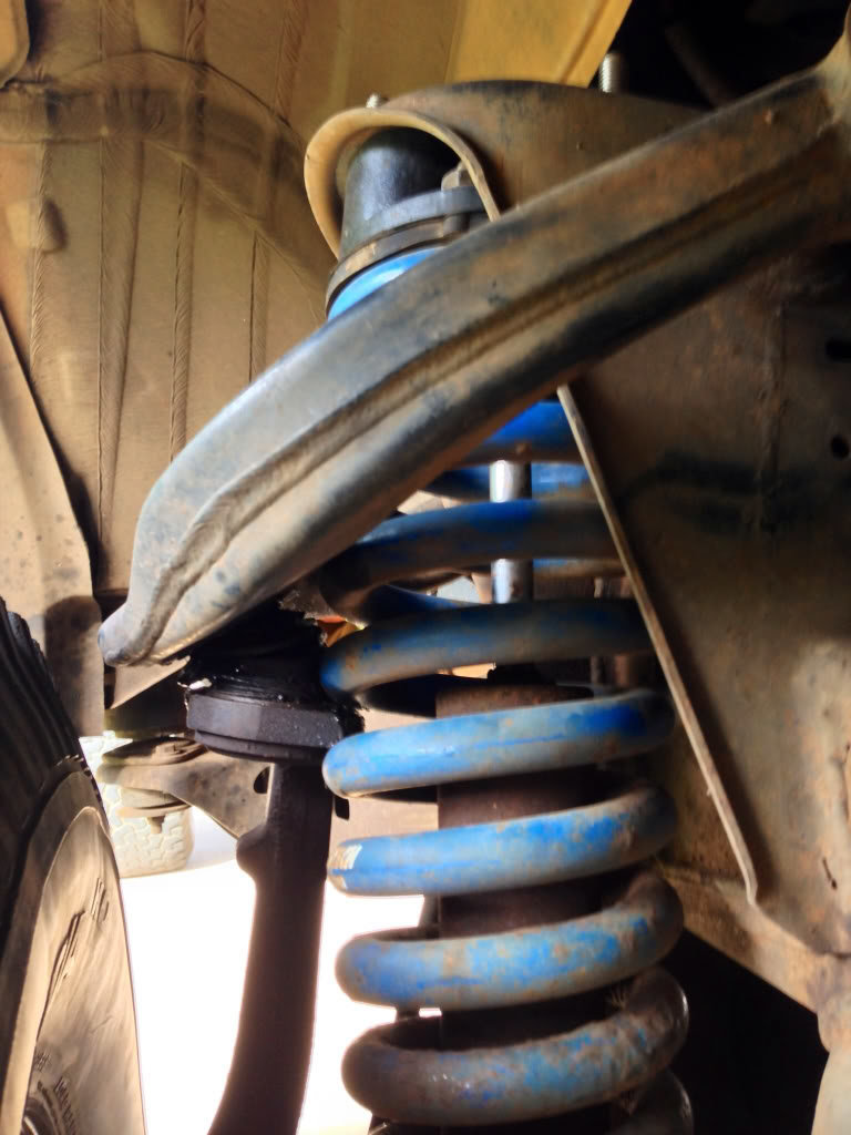

    Hello all,
    I recently picked up a 2001 Tacoma xcab 2wd that came lifted with a Fabtech suspension & body lift. It currently has BF Goodrich AT tires in 33x12.5x15 mounted on what I think are 15x12 rims. I want to mount those tires on a 15x8 rims that have 3.5" back spacing. My question is would I have any rubbing with the arms, frame, calipers, etc? Don't really like the current set up with the 15x12 rims. Thanks.
    Here are some pics for reference...
    a852371b93166599980365b773cb9d39_zps03b1_91433a4dd470caab98e6fe7d7f9a3b276fe9fe17.jpg
    6697e267cb1289ff0f0221e6aa880044_zps51e8_66f1777fff3c93acdf864cc0cd9168704d32e980.jpg
    cf37bd8645c28fdab624134b28c50523_zpsd9ee_8c7b48d4c08849e1fbbdb75b86025179a5b2ad73.jpg
    :help:
  2. Aug 10, 2013 at 7:07 PM
    ToyoTaco02
    ToyoTaco02 Well-Known Member
    Jan 21, 2011
    #49667
    486
    Scott
    Decatur,IL
    02 PreRunner DC 2.7L
    OME 881 1/4" top plate spacer OME Dakars OME Nitrochargers Light Racing UCA
    Only certain 15" wheels will clear the calipers on your truck. Go to discount tire direct and type in your info for your truck. The list of 15" wheels that are available should fit with no clearance issues. I'm running 15x8 black rock d window ally's with a 4" offset.

    Holy cow! :eek: Are your spindles resting on the coils or is that camera angle?

    I have a set of 15x8s already. I will stop by the tire shop and have them install the 33s and do a test fit. Thanks for the info.

    The spindles have clearance. It looks like the upper ball joint is almost touching the coils. They have about a 1/8" clearance... How do I go about fixing that? Thanks...

    That don't look like camera angle to me, I see a coil pushed up against a ball joint, and the UCA looks in the "down" position.

    I'd start with either:
    1. Some aftermarket spindles that would fit the lift
    2. Some aftermarket uniball UCAs
    3. Get rid of the lift.
    Recommend doing some research on your part. Kind of hard to tell how bad it is just from pictures and I don't know enough about that particular lift to give specific recommendations.
    Does it clunk when you go over bumps?

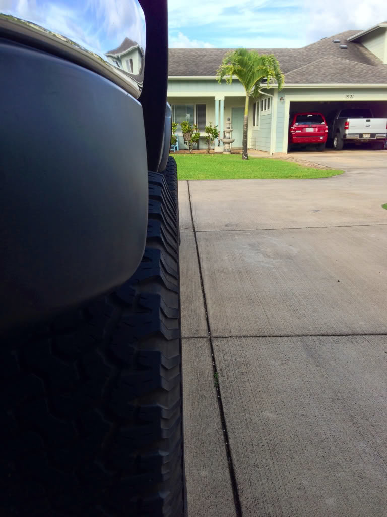

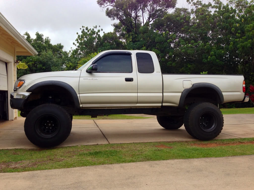

    I got the 15x8 (3.5"BS) rims mounted and it has enough clearance. Thanks.
    77e81638d51f7423e75f32dc35d1ef25_zps6775_a42d9e856112cd17d5ff17938b45ed6aa00b1d92.jpg
    Satisfied with how much it sticks out the fender as compared to the previous rims (15x14) the 33s were mounted on...

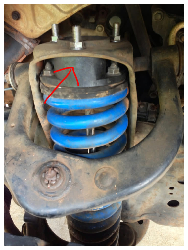

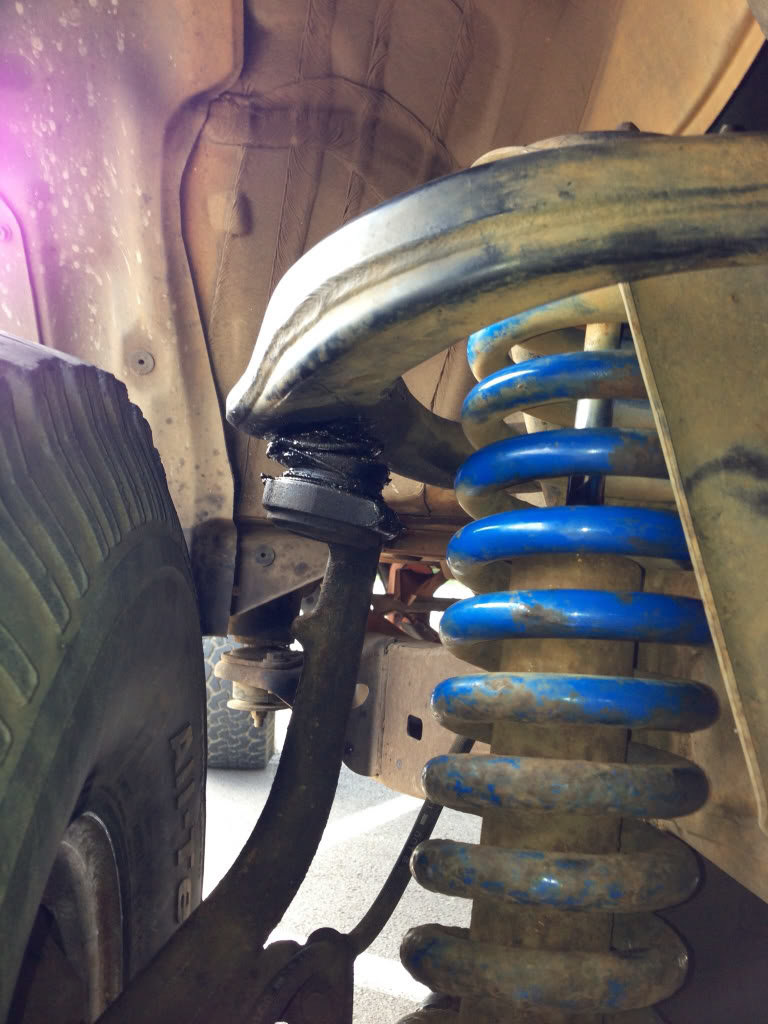

    I found the culprit. It seems the original owner stacked spacers on top of the Fabtech coilovers. Over the weekend I plan on removing the spacers and see if that brings back the clearance on the ball joints and control arms...

    that will make a huge difference. Glad you found a solution that doesn't require $$$. Does the rear have a similar height block between the axle and the springs?

    The front IFS geometry creates roughly a 1.5:1 lift ratio. Measure the top plate spacer, muliply x 1.5 and that gives how much lift the spacer is giving you. If the rear block is roughly the same height might be easier to take that out.

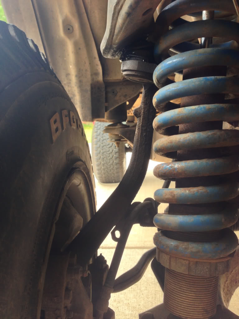

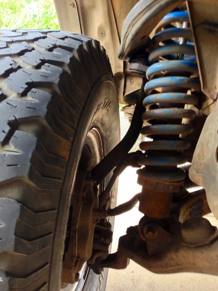

    I removed the front spacers. Definitely a big improvement in the ride and brought back the clearance I needed between the ball joint, coils and UCA...:D

    Thanks. Yes the ride is a 100 times better then before, but still on the firm side. I lowered my tire pressure to 30psi. Maybe I'll try 28psi.....
    Here is a pic with the front spacer removed and the rear 2" block. Now gotta work on removing the Body Lift some time later...
