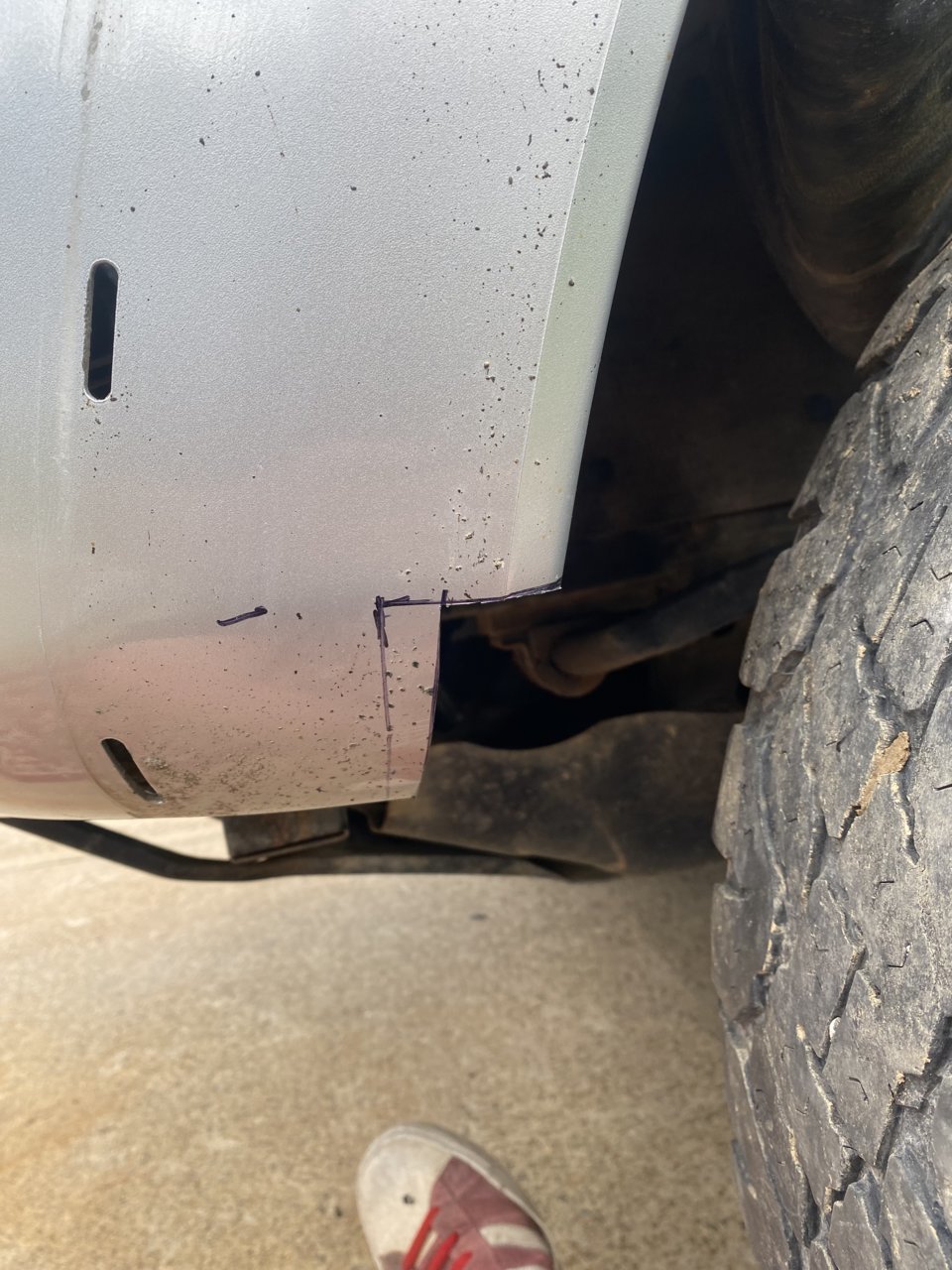

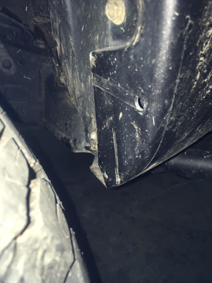

    I’m getting some pretty hard rubbing with the new 285/70/17s in these areas.. much more than I expected. Doesn’t seem to be hitting the cab mount, but definitely the fender and flare. I’d like to see some pictures of clearancing work done that doesn’t look too hacked up.

    I guess this is where the "pinch weld" i keep reading about is hiding..

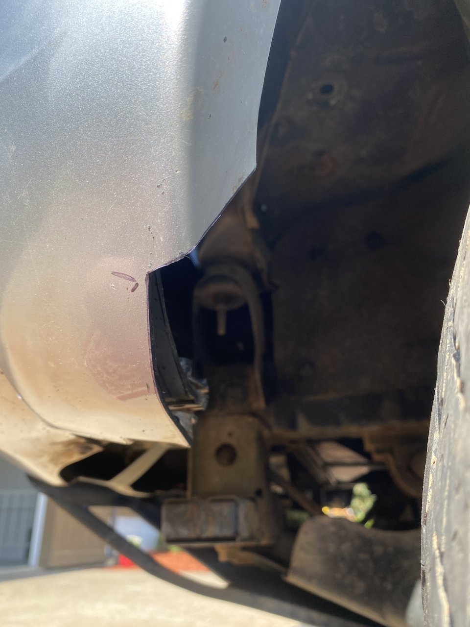

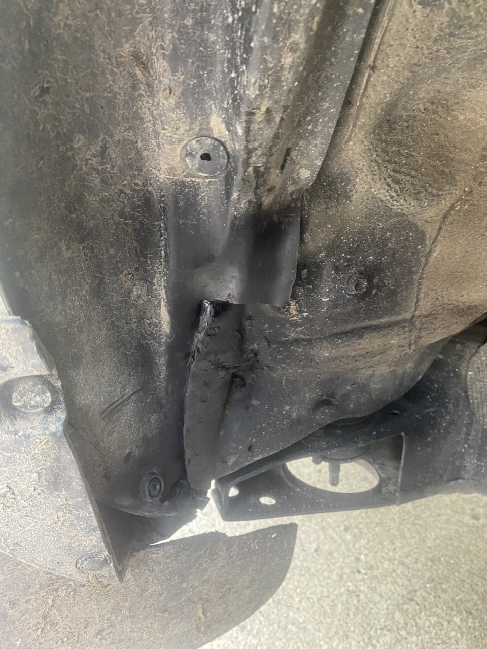

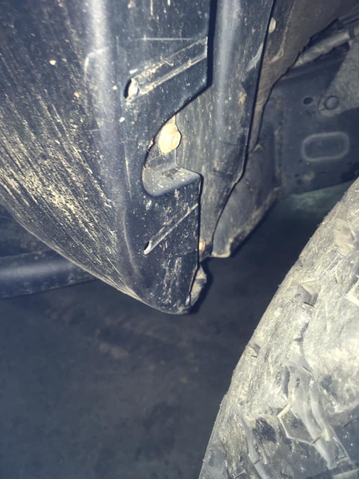

    285s. 8” et-10 1.25” spacers 3” lift.
    Hammered punch weld. Chopped can mount. Trimmed mud flaps. Trimmed flare.
    Trimmed bumper. Trimmed flare.
