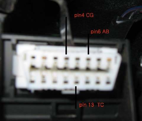

    I understand that there is a lot of us that have the AIRBAG LIGHT issues, mine have been ON for the last 2 months, here is what I found that allowed me to CLEAR the light OFF
    Based on the following link:
    http://www.ncttora.com/fsm/2003/Repair_Manual/03tacoma/di/rs/preche.pdf
    Please beware that these are comments, the poster(s) do not take any responsibilities of any consequences to yourself or your truck.
    TAKE PRECAUTION AND PROCEED AT YOUR OWN RISK!
    excerpts from the above link:
    4. DTC CLEARANCE (Not using service wire)
    When the ignition switch is turned off, the diagnostic trouble
    Code is cleared.
    HINT:
    DTC might not be cleared by turning the ignition switch OFF.
    In this case, proceed to the next step.
    5. DTC CLEARANCE (Using service wire)
    (a) Connect the 2 service wires to terminals Tc and AB of
    Check connector.
    (b) Turn the ignition switch to ON and wait for approx. 6 seconds.
    (c) Starting with the Tc terminal, ground alternately terminal
    Tc and terminal AB twice each in cycles of 1.0 second.
    Make sure that the terminals are grounded. Ensure the
    Terminal Tc remains grounded.
    HINT:
    When alternately grounding terminals Tc and AB, release
    ground from one terminal and immediately ground the other terminal
    within an interval of 0.2 seconds.
    If DTCs are not cleared, repeat the above procedure until the
    codes are cleared.
    in conclusion I was able to do 2 things:
    1. Read the airbag codes as DTC11: 1, DTC31:5
    Repeating 1blink + 5blinks, still looking to see what it means??
    2. Able to clear the code :), but they do come back as my problem has not been fixed.:mad:
    Hope this help others, and if anyone can tell me the definition of the codes, I'll appreciate it.

    damn it! my 07 has a different obdII port. pin6 has no wire to it.
