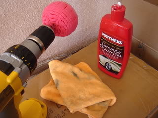

    I used one of those headlight polish kits and a Mothers Mini-ball polisher. It can be done by hand but the mini-power ball adapter for the drill makes it go so much faster. I used one such kit to remove 18K miles of road specks from a headlight assy. After the first few grit changes the lens looked almost opaque. But after the polishing with the mini-power ball, the lens came out crystal clear and new looking. Good luck.:)

    the mothers mini ball and some meguiars plast-x works great.

    x2 powerball mini + cleaner wax

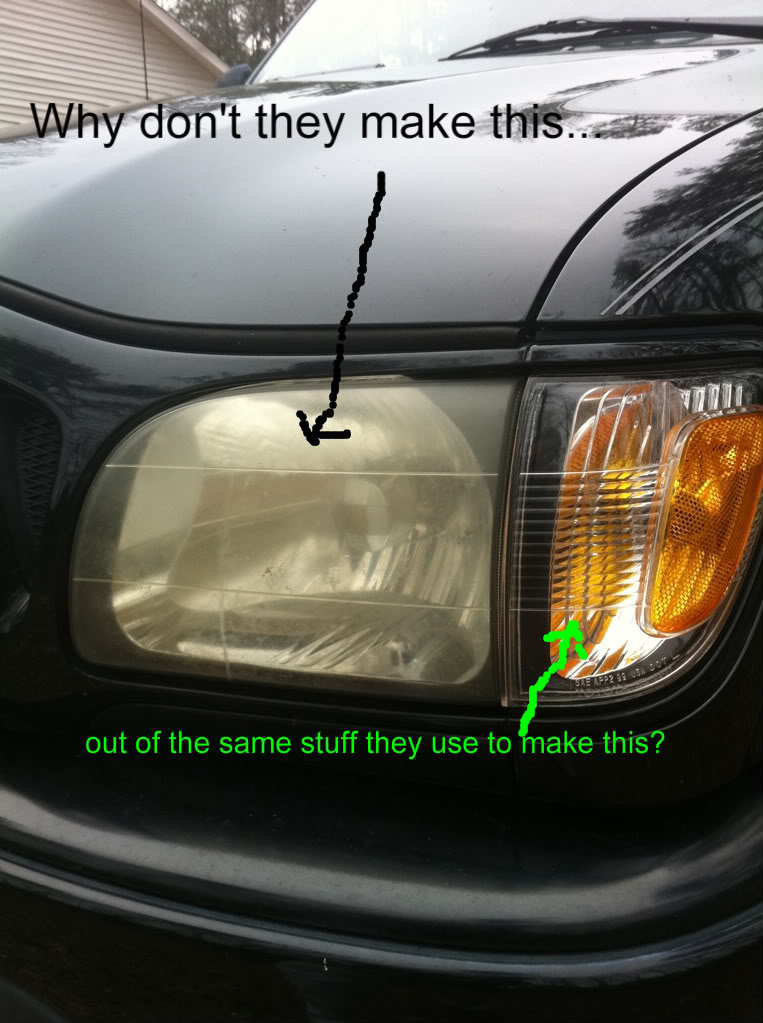

    both lights are original, I've always wondered why I have to keep polishing my headlights but the corners remain crystal clear.
  15. Mar 23, 2011 at 9:04 PM
    gtrotter
    gtrotter Well-Known Member
    Mar 1, 2010
    #32351
    394
    Interlake, Indiana
    2009 Regular cab 4x4, ARB's, 4.88's, bumpers, 2017 DCSB SR5 stock
    locker,mud tires, lifted, toolbox
    the heat the headlights create? That combined with debris hitting them at night( plastic softened?) could do that.
