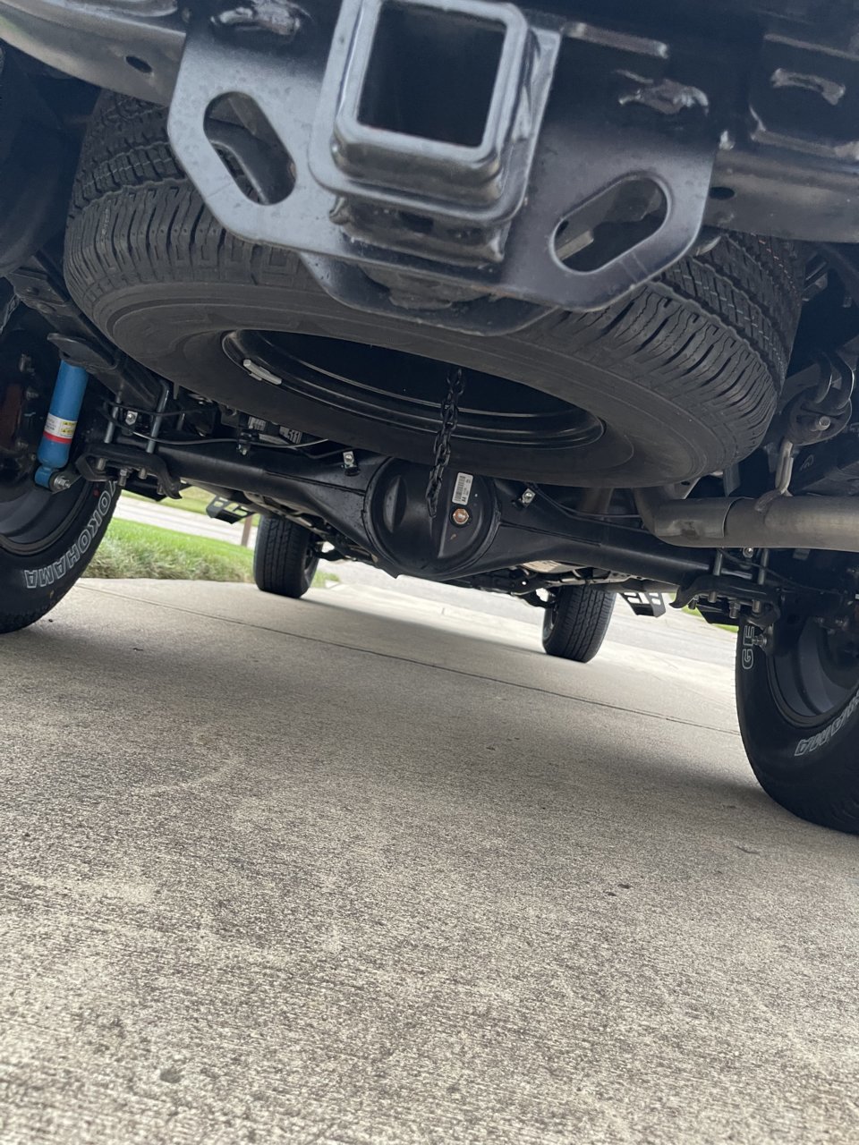

    Spare tire chain dangling?
    Taco_Craig, bulalo and cowfootball like this.

    #428735
    33
    A little? But it was like this before hand. And I dont think the guys at Discount Tire would have messed with the spare (I didn’t get a new spare).

    KDMax pro 9.0
    This x2. Zip tie it .
    bman291317[OP] and Taco_Craig like this.

    23TRDOR
    A good shop will check your spare for proper pressure. The chain might be hanging because of that when you had the new tires installed. Maybe just do as others have said and tuck it back up or tie with twist tie or zip tie or wire.
