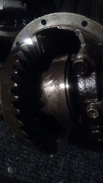

    Only time it doesn't do it is when you're accelerating. Little info... It has 583 gear and lock right locker. Sounds like grinding when you're slowing down until you get to 10-15 mph then you can hear the actual individual clicks. I pulled the third member to peak inside and inspect and everything looked normal. No unusual wear or metal shavings. Any ideas?

    The clicking is the locker, that's normal. Grinding, doesn't sound normal to me. I had a lock right in an old fj-40 cruiser and an aussie locker(same thing, different brand) in an 80 series Cruiser. Both had the click audible at slow speeds. Neither had a grinding sound.
    Wait a minute, it should click while turning. This isn't during a turn?

    You should pull the third and check the pins in the locker. There are spring loaded pins sandwiched between the two halves, right? It's been a long time...

    OK. Can I change the springs without pulling everything out?

    I dont think this noise is caused by the locker. in a straight liner theres no moving parts associated with it.

    Wow, I dunno then. The clicking was more than tolerable in both my cruisers. And it shouldn't click going straight. The click comes from one wheel spinning at a different rate than the other. At higher diff speed the locker locks up and doesn't allow the wheels to spin at different speeds.
