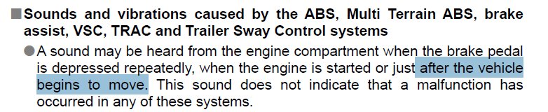

    ABS Startup/self test. It happens the first time I reach about 5 MPH after startup.
    hinmo24t and nc_oldhead[OP] like this.

    Its the ABS self test mentioned above. Does it when you hit 3mph. Drove me crazy before I figured out what it was
