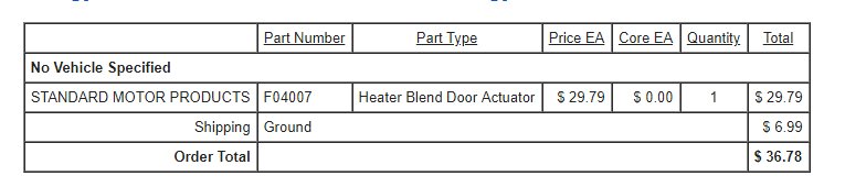

    It's most likely the motor that opens and closes the re circulation door/flap behind the glove box. I replaced it for $30 with a dorman part from Rock Auto. Problem solved.

    You could just open up that motor, and turn the broken tooth gear 180° so it uses fresh teeth.
