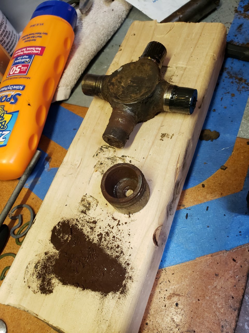

    It was a bad U Joint. Needed to be replaced. It was obvious which one it was once I got the driveshaft out. Here's the damage, no needle bearings at all left in one of the caps, just dry rusty dust:
    SR-71A and Alexely999 like this.

    Sweet rust bro!
    kidding aside I just did all three of my rear ujoints this week and all the clicking I was experiencing is now gone as well.
    My clicking wasn’t nearly as bad as what was in the second video. It was more upon takeoff from a dead stop and then shifting 1 -> 2.
    Overall drive quality when shifting is much better now as well. Kinda wish I did it sooner ~115k on it. Didn’t replace carrier bearing.
